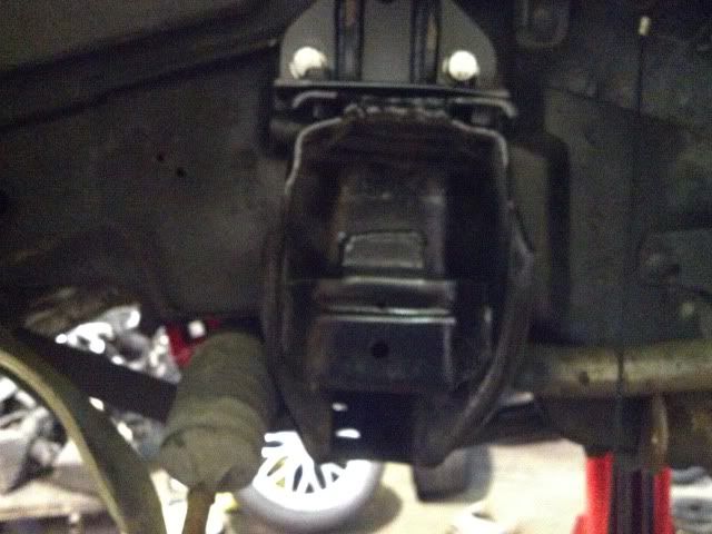

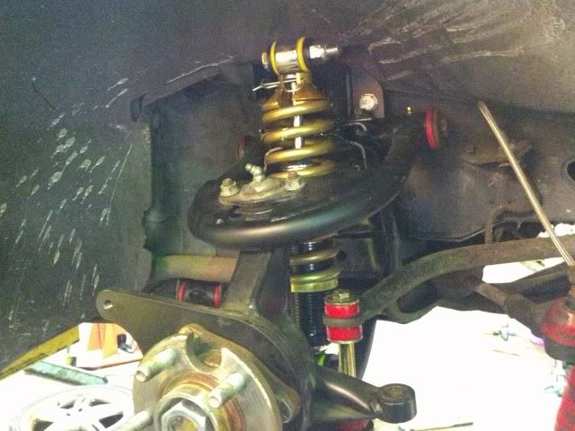

We started with installing Held Motorsport's front suspension kit. This required cutting off the original spring perch and welding it back to the chassis. This allows clearance for the coil over shock. Here are a few pics. Sorry about the poor quality....my camera was acting up at the time....

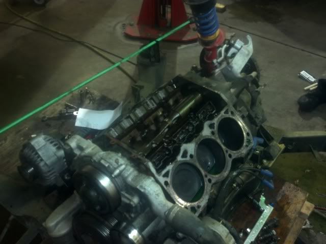

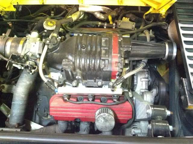

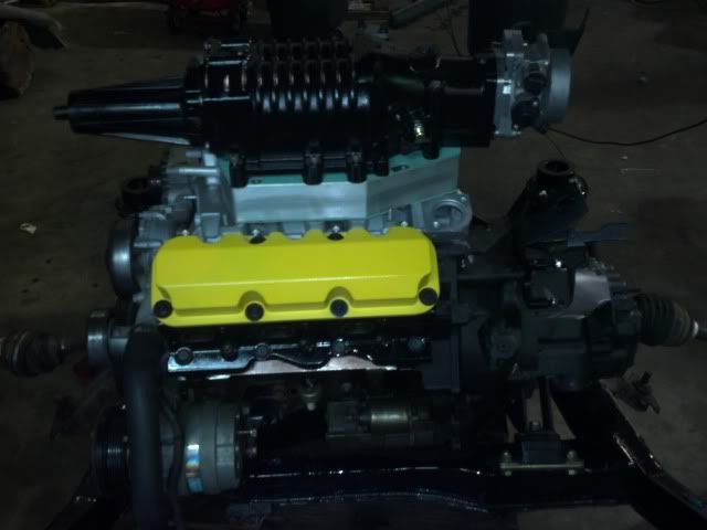

Here is a little before shot of the engine.....the body shop got a little dust and overspray baked in.

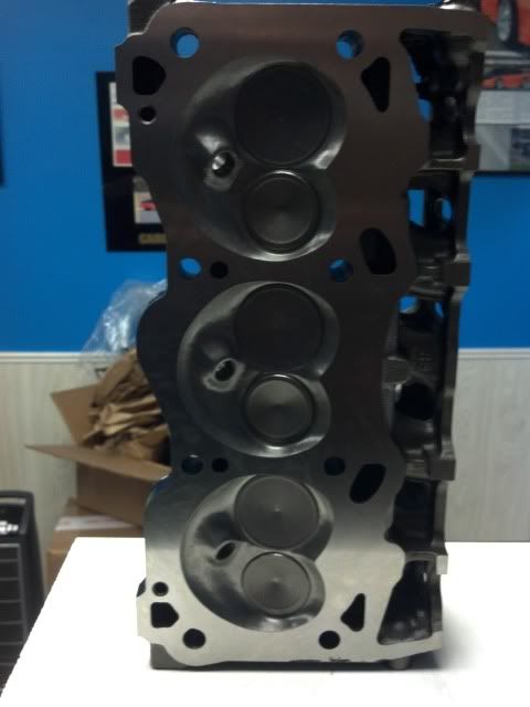

I really want to see this car take home a shelf of 1st place trophies this year, so we started off with removing the entire drivetrain to POR15 the engine bay and cradle. The zzp stage 3 heads have arrived....

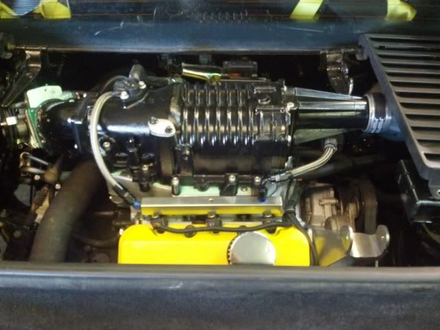

The red valve covers and yellow body were kind of clashing, so I powdercoated the zzp aluminum covers with a matching Corvette yellow to match the paint on the car.
We upgraded to a gen 5 blower, 77mm throttle body, (it has the XP hot cam), full size intercooler and everything that looked out of place, will be getting refreshing. We also upgraded the transmission and engine mount brackets to Rodney's thicker ones. We have bent the stock ones with the torque produced from a similiar setup.

I love it. It seems every time I put a Fiero swap on the lift, our German car business triples. Ryan and I have been going crazy fixing BMW's, Porsche's and MINI's these past two weeks. Charlie's car finally started up today with the new heads, Gen V blower and I fabricated a completely new intercooler setup that I think is the best setup I have done on a 3800. I vacuum filled the reservoir, turned on the key and 30 seconds later, the entire system was bled out. We also changed the intercooler coolant from the VW G12 to BMW blue antifreeze. I found the BMW seemed a little better (personal reasons). I like using a different color coolant in the intercooler so that if a leak develops, it can easily be determined as to whether it is from the intercooler or the cooling system. Here are some installed pics taken late today.
We wound up also changing a lot of the wiring harness loom that had some overspray on it, and chemical cleaning the parts that needed some touch up. The yellow that we powdercoated matches almost perfectly to the exterior paint.
We had to use the ZZP gen V turndown to clear the decklid on the driver's side. Otherwise, the decklid strut wouldn't be able to be used anymore. I used the LQ4 MAF sensor on this setup. The passenger side had to have the decklid notched slightly, but it is very clean.
