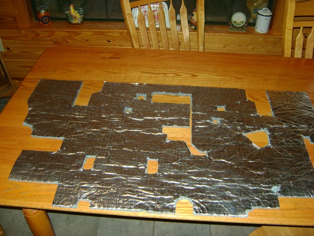

josef644
APR 12, 08:46 PM
Made this today.
I was gonna try to get this in the car tomorrow, but alas, the evil gremlins are at my house for several days now. Lawnmower fell off of the trailer today. The chain anchor rusted out during the winter. Mower was in pretty good shape after the fall, until a 18 wheeler kissed the rear end of it. !8 wheeler 1, mower 0. He wasn't even mad. Had a big smile on his face.

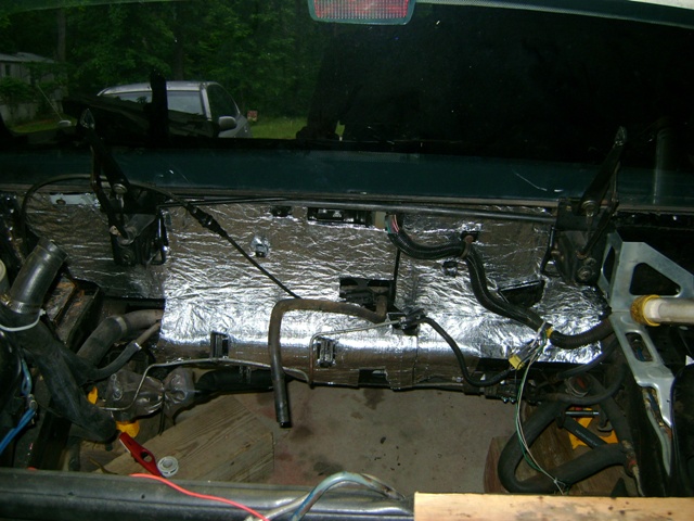

josef644
APR 19, 06:03 PM
I went around all the the edges with aluminum tape to sort of weather proof it. The aluminum tape was $8.00 at Lowe's. I put it in the car this afternoon. I cut it in three pieces. I used the heavy duty adhesive spray to hold it on the metal. Left of center, right of center , and to the left side of the battery support. I don't know if I could have used the spray adhesive and put it in in one piece. Been dreading this big time.
Ein Bier Bitte?[This message has been edited by josef644 (edited 04-19-2010).]

Question on the AC block and hose ends. Are you planning on running straight hose from the compressor to the block on the drivers side - not using mufflers on the lines? I need to tackle this in the next week or so.
The firewall insulation looks good. I need to do this too - should be easier now that I have the template! Thanks again for that! I'll send it back by Friday.

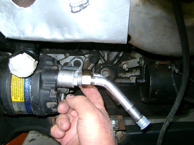

They are the items I need to make up the AC hoses for my swap. I order two different hose ends today with a 45* bend in them. As these are mounted on my compressor, the AC hoses will be rubbing up against the end of the starter. If the larger one of the two was on the inside port it would not even work. I think the 45* bend will solve this problem. We'll know soon.
Part #14108A (# 8 fitting to #8 Hose) 1 $3.49 $3.49
Part #15512A (#10 Fitting to #12 Hose) 1 $4.64 $4.64

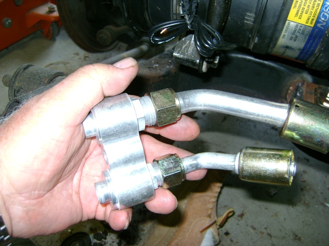

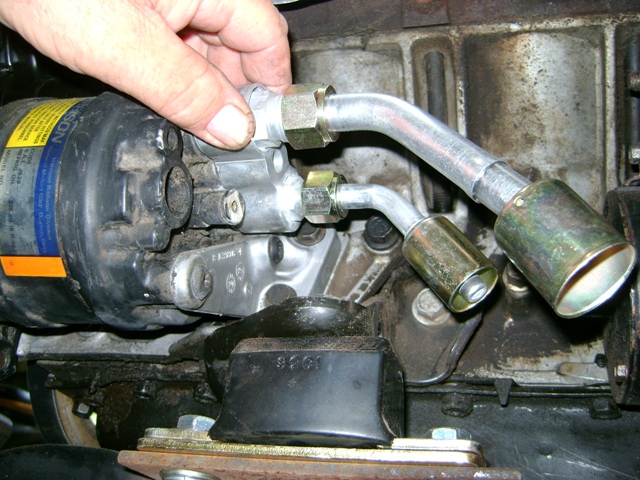

josef644
APR 21, 07:44 PM
Here it is against the compressor. They are both on there, just can't see them both:
An a side by side shot. There is plenty of room away from the starter. The straight ones would put the hoses against it.
From below:
