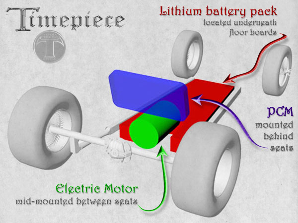

So, here's the BIG news story:
 We (Gokart Mozart, JRP3, and I) have been holding out on the juiciest part of the plan - the 27 is going green! After my thread on hybrids, JRP3's electric Fiero build thread, and the Advanced Propulsion thread, I was sold on the premise of electric propulsion being our future. That's what led to the rebirth of the 27, because I decided to convert my street rod to electric; and then realized that I could put the motor back in its proper place!
So, this is the plan. The 27 will be a true m/r vehicle because the electric motor will be right between the seats! That's what you see in the rendering under the wing. The electric motor will turn a carbon fiber driveshaft, that will in turn spin the Winters Pro V8 quick change rear end. With the motor between the seats, and the battery pack under the floorboards, the 27 should have excellent weight distribution and a really low Cg. That means this project is not only the rebirth of the 27, but it is also the fulfillment of a dream I had when I first came to this community - for a stretched out, mid-engine, exotic supercar style Fiero - it's just a bit more "mature" than the original concept. Imagine if this car has been produced in 1927, it would have been as crazy as the Countach was in 1971!
JRP3
FEB 12, 08:47 AM
Even crazier since it's using technology that didn't exist at all
