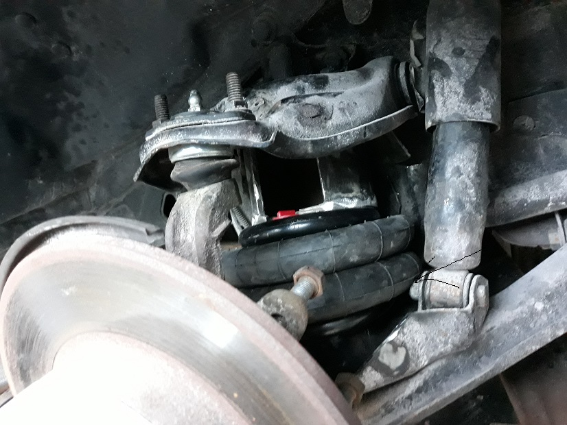

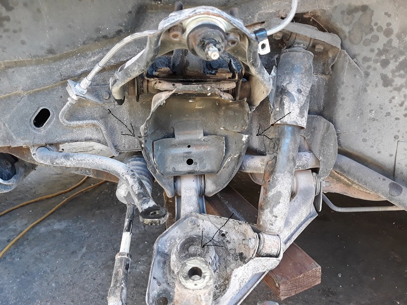

Ive been using the westcoast fiero thread as a guide, I skipped a step. I drilled a hole(lower arruh) in the bottom bump stop(forgot to take a pic) put muh 3eifsx1" bolt in from the bottom and welded it to the bump stop. So Now I have a stud to screw the bag onto. The udder two arruhs are where u gotta cut the perch n open it up. Itll get welded back together later. Goin thru the fitment thoes but its really not bad

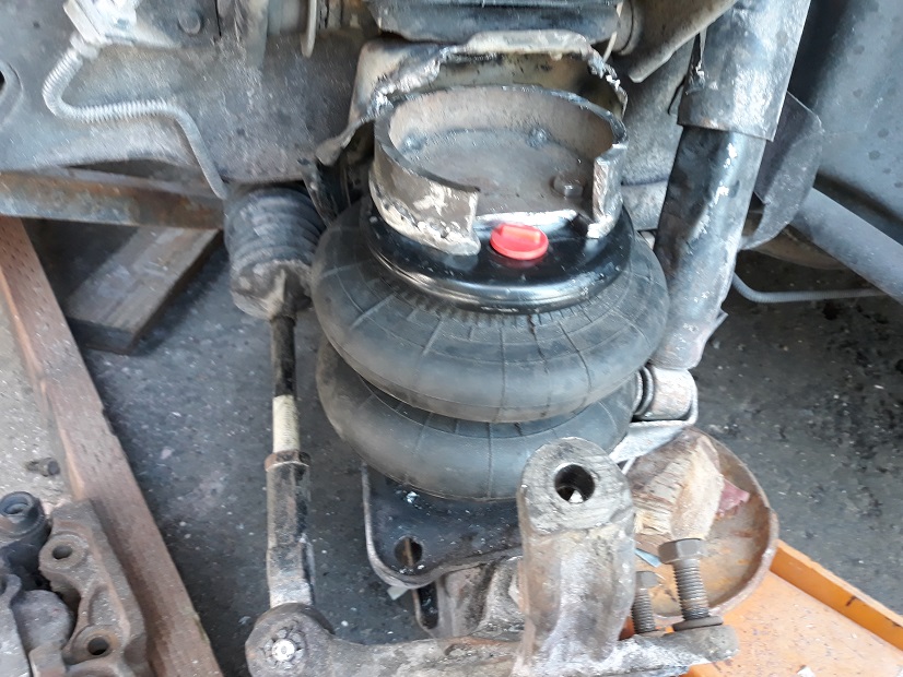

Im a cheapass so I made my own top plates for free from 1/4 plate. I set the plate on the bag, and the 4" round by 3"tall steel tubing(thats what I eyeballed from the other pics) test fitted and tacked
Cleanerup
Crazy when I cut the pipe open it was under tension and opened up about 3/16 on its own
Here its test fitted so I could mark where to clean it off to weld it to the perch n wrap chit up meng, mebbe tomorah

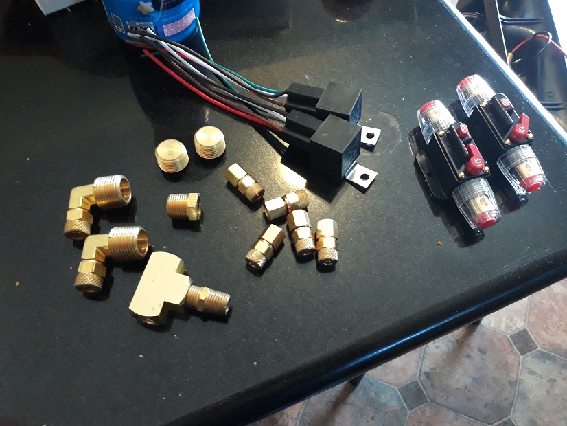

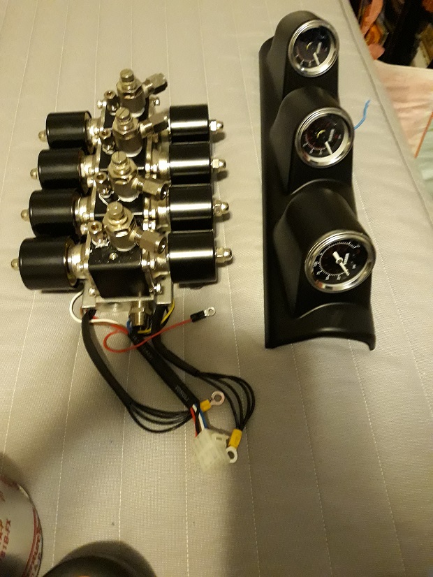

Rest of the fittings should be in by monday n I can start plumbing. I got the good stuff- airbrake fittings where available. 3 gauge pod showed up today, thatll hold the 3 air ride gauges

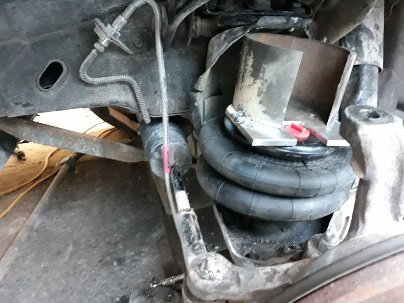

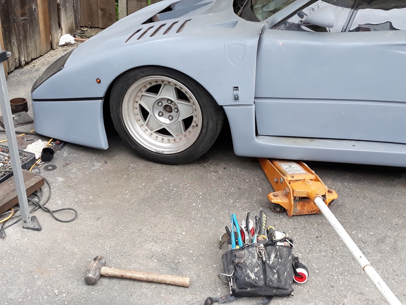

Finished up the ds, seemed kinda hi so I cut a few inches off the riser. Boy was that a pain to get out, my welding not pudy but very strong. Ran outta flux, had to switch to steel wire n gas. Bottomed out ill be 1/2" from the top of the tire to the frame rail
Cant get the car off the jack

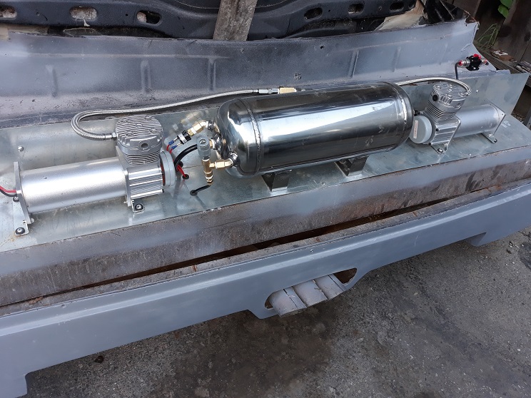

Relays for the compressor have tiny lie maybe 20-22ga wire that im supposed to hook to a #8 wire. Seems too dinky for me, im planning to use a ford starter solenoid to power the comps.

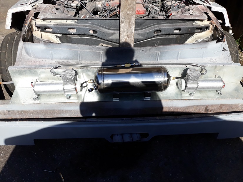

Found a sheet of steel exactly the size I needed at my buddys shop 60x11, bent it in half and mounted me goods

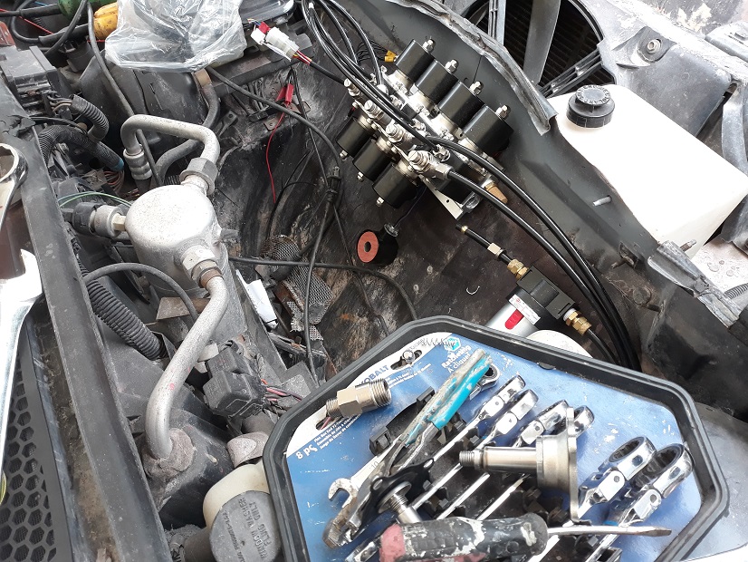

Everythings plumbed up minus electrical. Picked up a few more fittings today at lowes, going to tee off the comp pressure line and add an air tool coupling. Picked up a flexi air hose tool kit so I can air up my tires or use air tools.

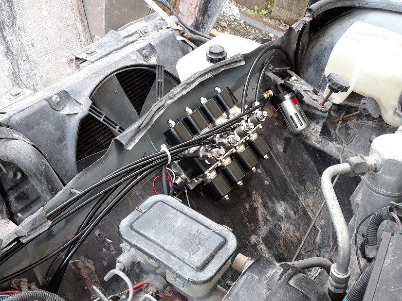

Been having some trouble with the mani, traced it to a bad check valve. Doesnt let air in or out. Will need a new one. Bypassed it and still had some trouble, seemed like some valves were leaking. Pulled the mani to bench test it. Got a few fittings at lowes this mornin to connect the mani to my pancake compressor. Found out I had the inlet and outlet switched (should work either way), directions on the website are backwards. May have some switched valve wires too incorrectly pinned in the harness
Once I had it figured out, I reinstalled the mani and ran it off the compressor and got the car to lift n drop front, back, side/side. Pretty sure itll drop too far so Ill hafta install some stops. Body kits lower than the frame. Heres the car sitting on a chunka hunka 6x6 under the front crossmember. Thats as low as I can go and still get the jack under. Very cool watching the car go up n down, neighbor and kids were getting a kick out of it too.
Going to order some straight fittings for the front bags. I have elbow fittings there now and its fine at normal and dropped height, but when the car lifts the upper control arm rubs the hose a wee bit. I can rout the hose straight up if I notch the perch. Back may not go down all the way, may hafta make some brackets to lower smore. Still playing with it. This airbag adventure is very fun and wasnt very difficult. Everything was pretty straightforward

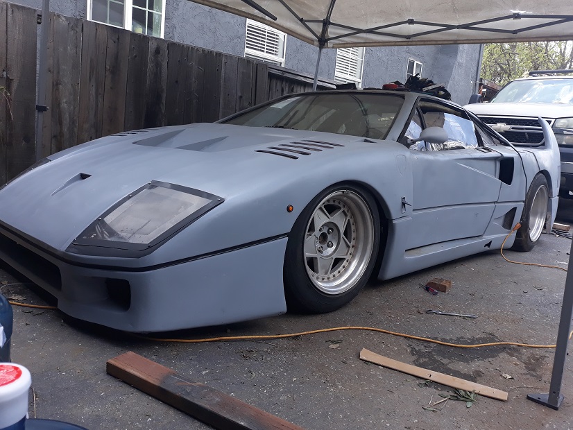

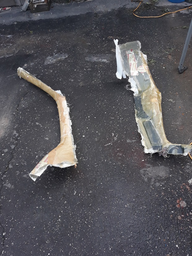

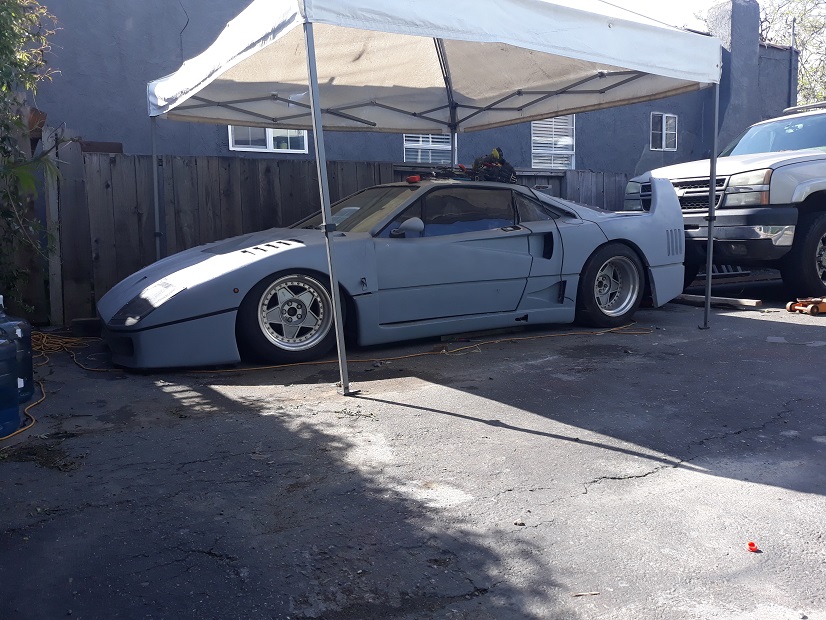

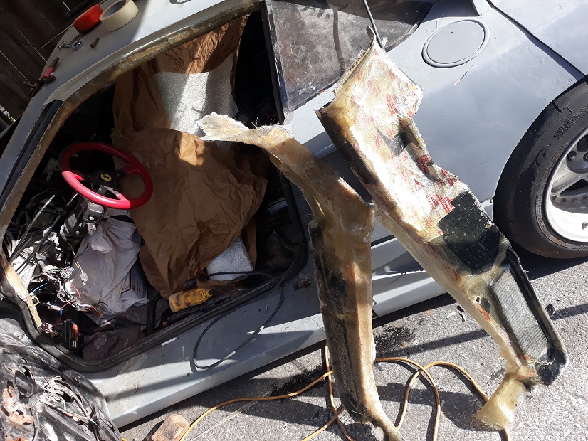

Well stuck on bags till I get more fittings. Got off my arse and broke out the fb. Glassed up the ds upper and rear chunks o trim. Bad pic, cars under the ez-up so it came out like chit
Ive been cutting up the fiero trim pieces and keeping what I need, reshaping the rest w hvac tape. Got 2 layers of cloth and 1 layer mat n its super strong. These will make the door opening look much much better when finished, looks pretty ruff now. IOnce those r dunn, ill make the headliner (looking for visors n the center thingie they hook to), then insulation, dash, n seats will go quick. The door panels Ive been thinking about ways to do and looking at how much I hafta butcher the doors to make it work but it wont be too bad.

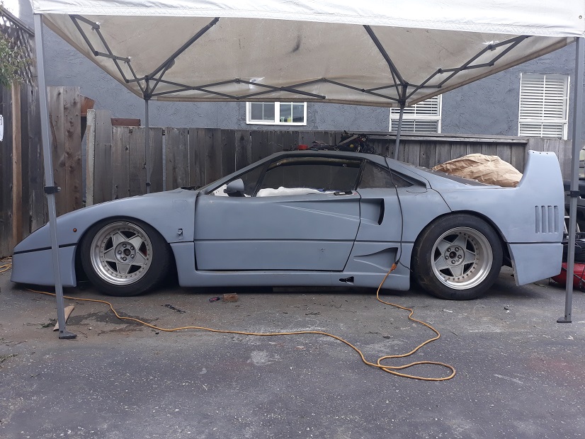

BAM! hye roller/rock crawler
scaredy cat rawr!
Valves wouldnt dump so I said maybe the inlet needs to be opposite and over from the inlet(directions say next to each other) and...
its about 1.5" from the ground bottomed out, looks fukin schweet!
does sit level tho. Rear sleeves cant fully extend only got about 6 outta 10 inches maxed out on the shock rod. May hafta buy those fancy bags, nah ill try it n see how it feels

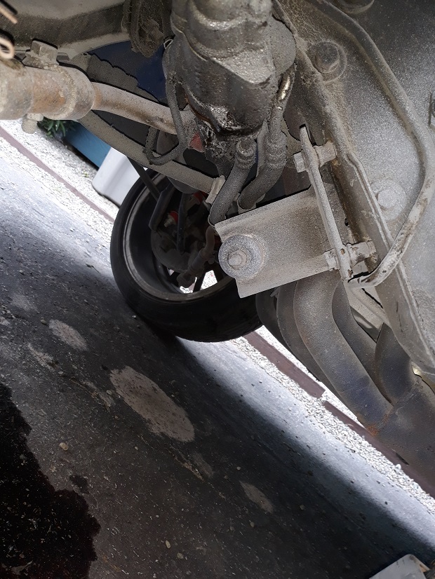

Turd o rama! Not really. Been raining like crazy, no time for the car. Any free time I had has gone into the stang, got some new goodies, fixed the power steering leak n found this
Power steering brackets ripped out from da frame. Pulled it, cleaned it, welded it good

Got all my fittings and parts together to finish the tank plumbing, i have an outlet for air tools now
Installed a ford starter solenoid to fire off the compressors and 1 60a breaker. may need to run both breakers and separate #6 lines to each compressor. They pull way more juice at higher psi. Ran a switched wire from the dash to the p switch for control

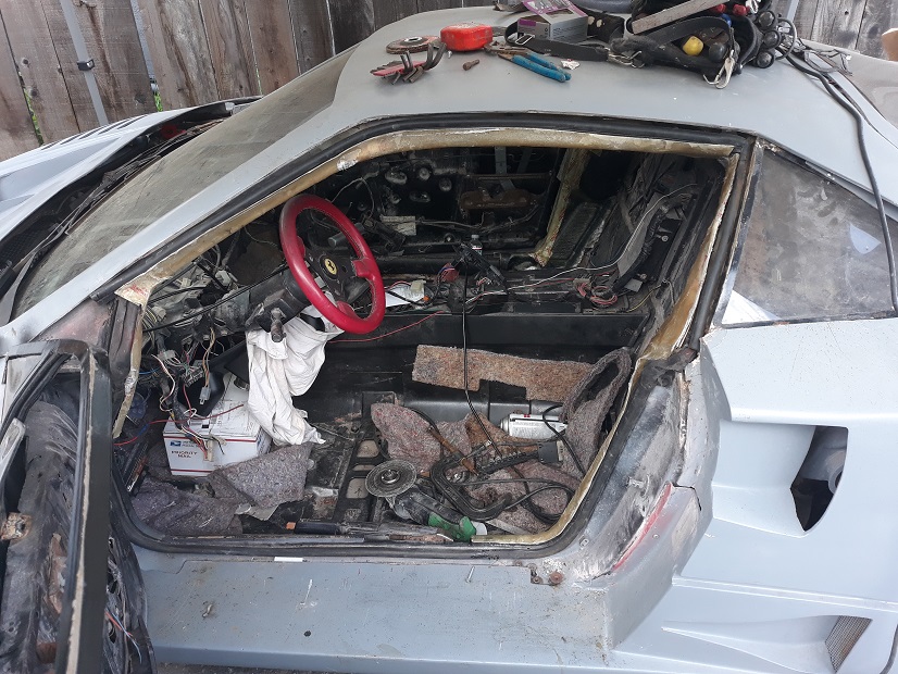

Got my panels wrapped in pleather, was a bit of a stretch nyuk nyuk

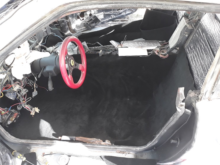

Welded in bungholio and gave the inside a good sweeping to loosen all the dirt in the nooks n crannies. Gave it a good vacuuming, then installed the insuration
Then the panels and carpeta

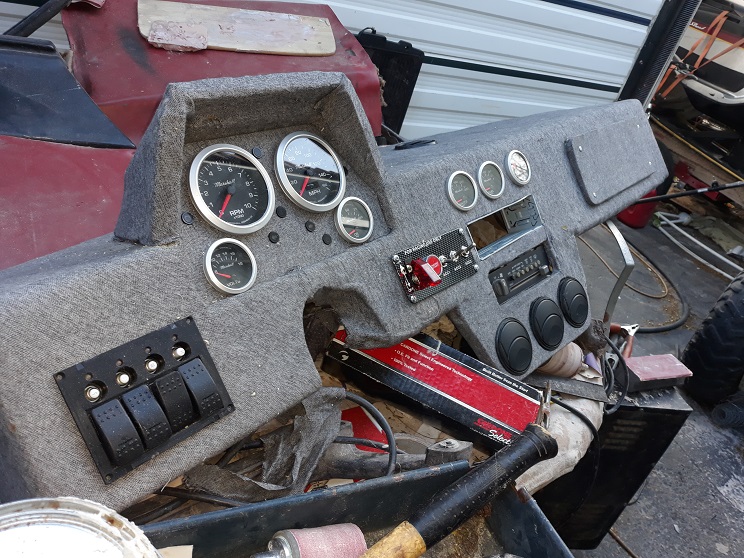

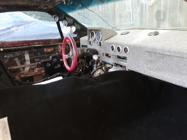

Threw the dash in for shits n giggles, had to drop the column to get it to clear. prolly gonna redo the cluster and havent finished the lower vent section
Everything on this door lined up but the lower edge of the door vent, ground it down n boogered it up

Lol No it means very cheap and resourceful. I made the lower vent area from a 1x6 pine and used a wooden steak lol to extend the cluster outwards. Had to overlap the covring but hid the seams pretty good. Dash didnt fit w both trim pieces in, was hitting the steering column. Opened that area up a smidge, should be nice and snug.

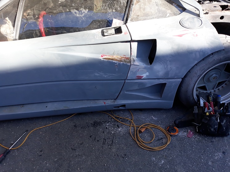

Threw a lil bondo on the outer ds scoop. Now im thinking about the headliner
