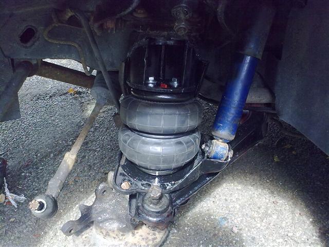

Here's the info on doing airbags:
http://www.westcoastfieros....ow-to_topic1963.html

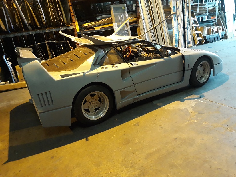

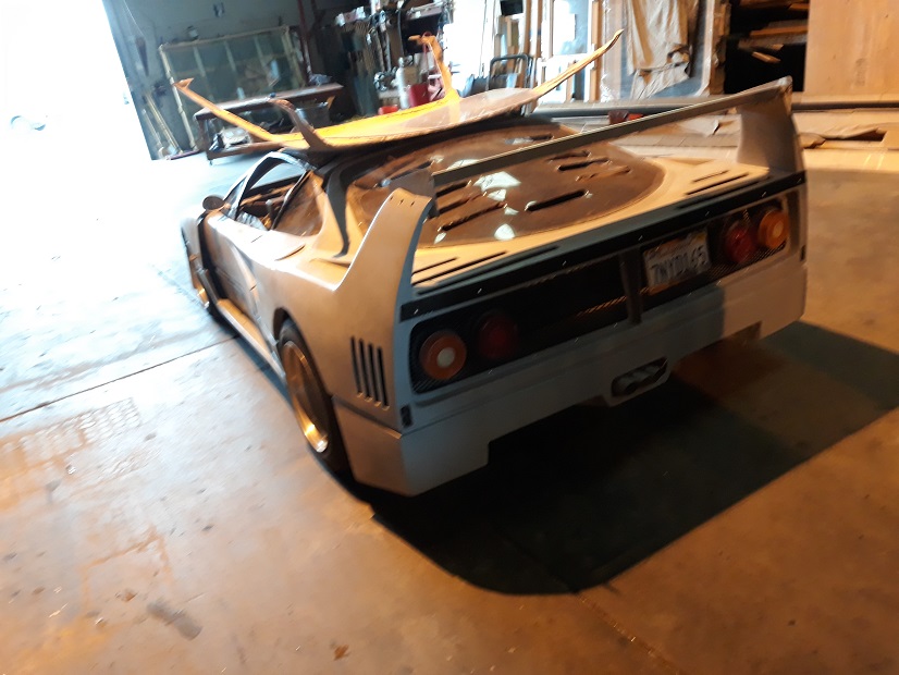

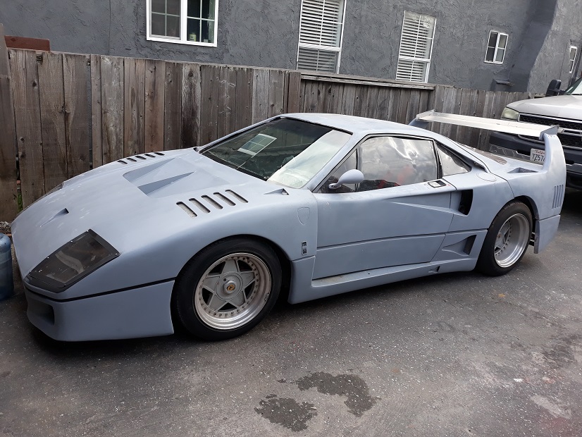

Ill hafta make sure it doesnt! lol Imsa, again, u da man , man! Saved me the trouble of looking up that thread again! Airshocks wont get the car on the ground like I want it. Been watching too many car shows. Picked up the car today from the glass shop. Looks fu@kin schweet!
The lady said she has 12 guys and only one could do this and he broke one, this was #2. She was very impressed w the way it came out, I told her its the nicest thing on the car.

I dunno, she can cut one off a template or to the car. Its a real deal fiero windshield. I just had them do it instead of me trying to cut it. Carpet for the interior showed up n I started wiring the gauges. Washer crapped out, fixed it. Now the roofs leaking. Shemdogg tired

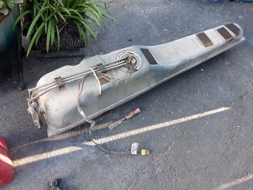

Lotsa goodies showed up n I got some stuff done. Pulled the tank and swapped over the sender and fuel pump from a chp10010. Reinstalled today. The wires were cut and taped together. Mighta been why the sender didnt work but had it out, new parts goin in. That was a fun job, the big 2 hoses were a pain to get back on.

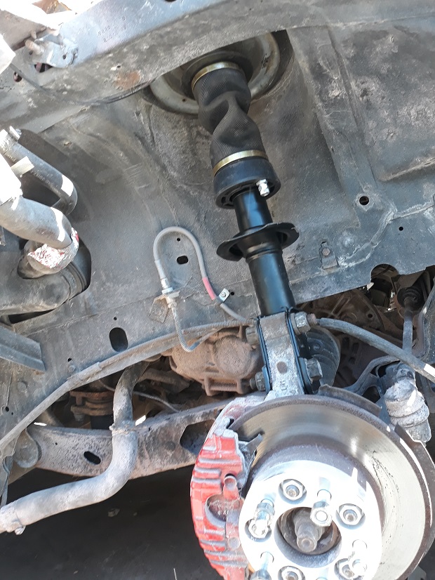

Kybs showed up from the fedex guy, said hi how u doin n he didnt reply. So I said thanks and hit him w the death breath, he was coughing hard all the way back to the truck. Thought he was gonna yak lol. Sleeves showed up today in record time, ordered em tuesday afternoon. What an easy install. Had both sides done in an hour

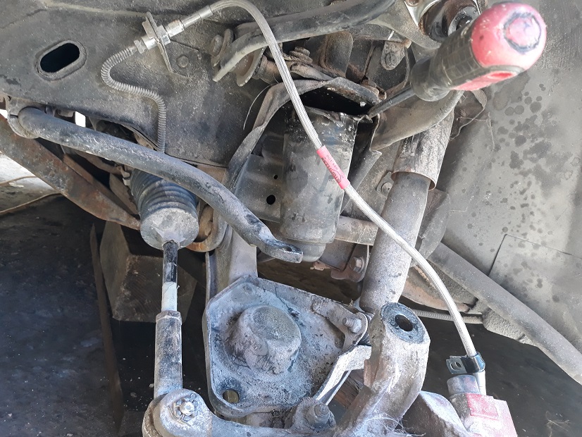

Fronts gonna be a biotch to get the bags in. The sway bars gotta go, its way in the way of the bag. Got the upper bump stop out easy w a big ol flathead and the 3lb sledge, hammered out the 5 welds in a few mins. Bags are fat, hitting something at all 4 corners. Top sides hit the spring perch, bottom hits the sway bar and the lower control arm spring plate side. Started opening up the perch and moved the sway bar as far forward as itll go.

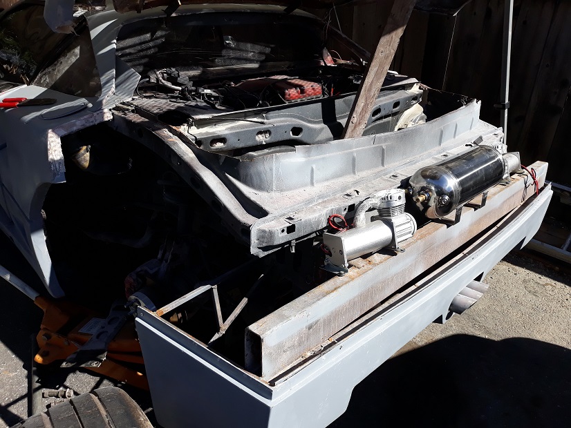

Started staging the compressors and tank, I like this location. Tanks a squeeze but itll fit. Going to weld some flat steel there to mount the goods
Gotta order a few more fittings and start plumbing and wiring. Pretty easy to set everything up minus welding.

I use a similar mounting location for my compressor and tank installed in an 87 Mera and have been quite happy with the location/functionality of the components. One thing to consider is adding a switch that allows you to turn off the air compressor power supply prior to starting the car. I did not do this at first and charging the tank often ran the battery down far enough to cause starting issues. With the mod I can start the car and then turn on the compressor to fill the tank. An alternate solution is to provide power from a source separate from the ignition start sequence but it was much easier for me to add the switch to my existing set up.
