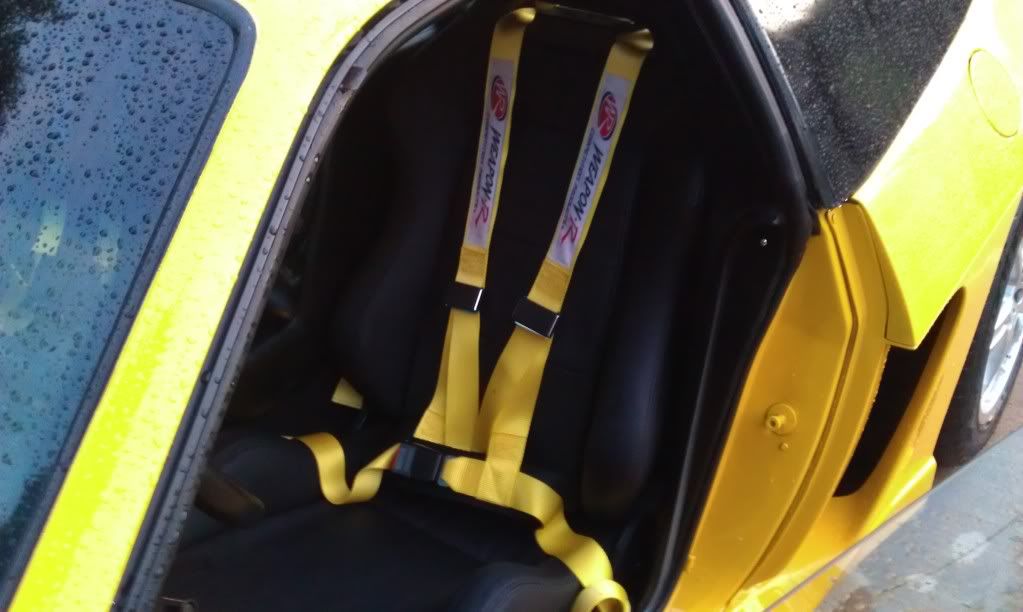

The only problem I'm having right now is the Corbeau seat brackets and the sheetmetal I used to attach the brackets to the seats. First...I should have test fit the brackets because that's 2 hours I could have used better. The brackets didn't line up with the bolts in the floorboard so I put the original seats back in until yesterday. I also went with a full cap instead of the 1/2 cap I was using with the Fosgate amps. I also decided to give the Corbeau brackets one more try. This time I used my drimmel and made some modifications to the front bracket holes. Now they fit the way they should. Now the final issue I'm having is getting the sheetmetal holes where they need to be. Of course an earthquake yesterday and an impending hurricane make getting this resolved soon unlikely, but I'll work on it in my basement. I was able to fabricate and install anchor points for my 4 point harnesses. I used 1/2" carriage bolts up top and my harnesses came with snap in eyelet bolts for the lap belt. These actually fit perfectly into the factory holes without modification. I hope to have the seat issue resolved, but my backup plan is to modify the sheetmetal to work with the factory rails. I've already modified the pieces for one seat, but I want to see if I can make the Corbeau brackets work first since they seem more sturdy. I did take it for a spin Monday night and it was SWEET!!! More to follow.

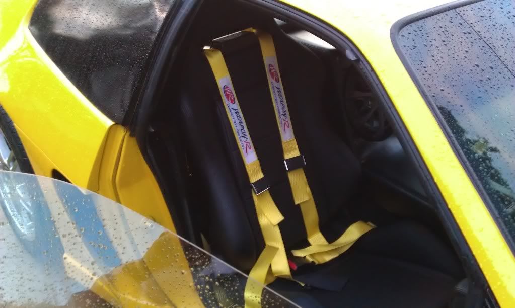

Ok everyone...after much remeasuring, cutting, grinding, assembling, fitting, only to start over again because the measurements were "off"....the leather racing seats are finally installed.
I will say this was the most labor intensive part of the interior upgrade. A word of caution to any of you considering the Corbeau seat brackets...make sure you test fit them first and have a dremmel ready to do some mods to make them fit properly. I just went for a ride in it. Responds great. Corners nicely. I will need to go back to the tire shop and have the balance confirmed. Seems to be a recurring thing with the particular tires I have. I have the same issue with my other car that has the same tires. Takes about three times getting them balanced before they're right.

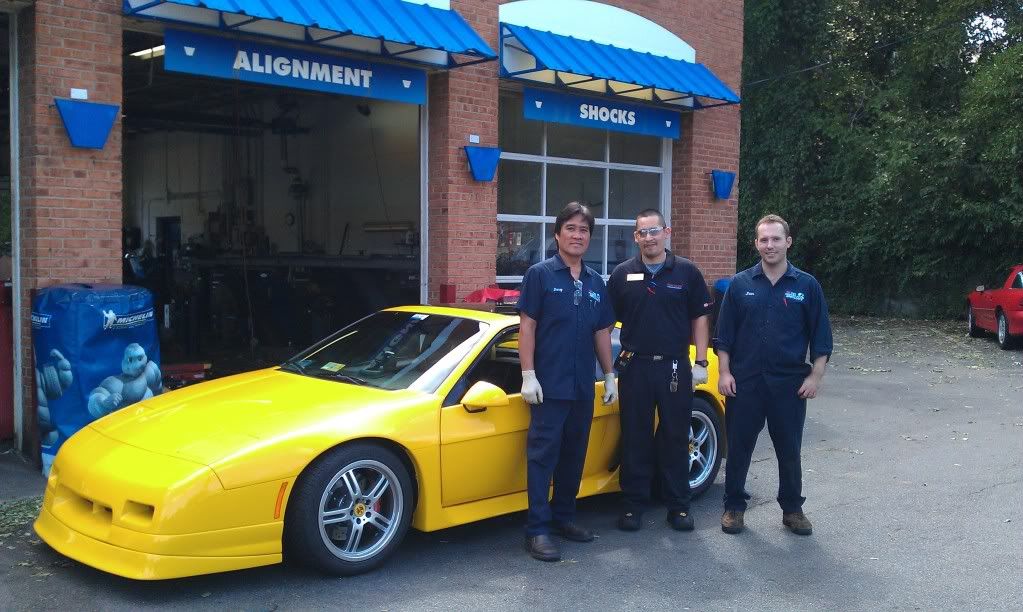

Here's what I've done so far. Been driving my car every day this week since the weather has been so nice. I had to go back to the tire shop last Sunday...got the tires re-balanced...and got pictures with my "pit crew" (Danny, Chris, and John).
I've gotten very positive comments from everyone I've come in contact with. I stopped at McD's a few days ago for lunch and while I was inside several guys were gathered around my car. By the time I came outside they had gone inside. Before I could leave the parking lot one came literally running out to ask me about the car. Later that day on the way home there was a guy in a high end Beemer that slowed down to check out my car...looked my car over...gave me the "NICE" nod of approval and a big

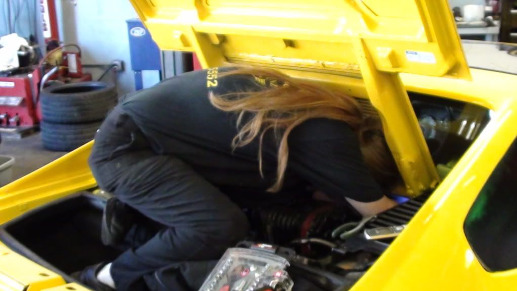

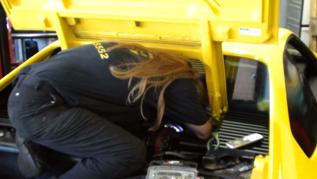

Yesterday I went to see Dave and crew so he could change out my fuel sending unit. I should have taken pictures of the old one he pulled out. Sure didn't look like that before it went down to Loyde's...oh I get it...it sat as one of his yard fixtures for 3 1/2 years before I rescued my car from him. Pretty certain the same gas I put in it back in July 2007 was still in the tank. Anyway, here's a picture of Dave securing the wiring harness for the fuel pump.

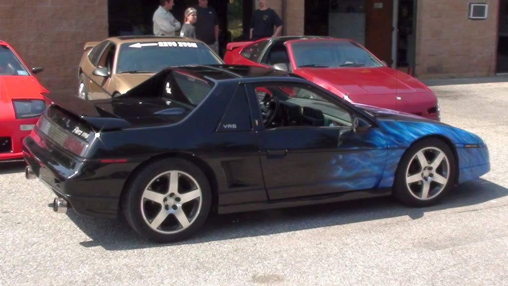

No way I could have attempted that without being suspended in air! While I was there we got additional video of Joey's car and Dave's orange car as well as more pictures of Joey's car. I'm working on shortening the videos so I can post them.
Of course it wouldn't be complete without the "Joey" pose!!!

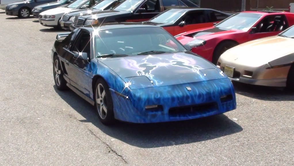

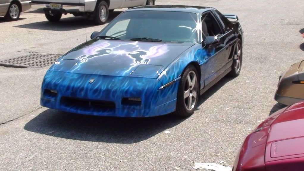

Charlie64 SEP 14, 10:48 PM

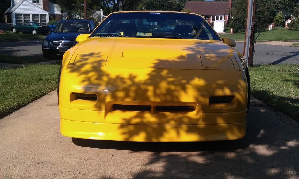

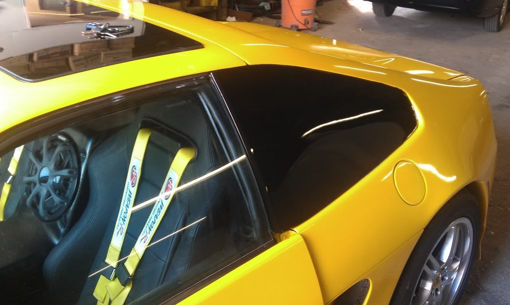

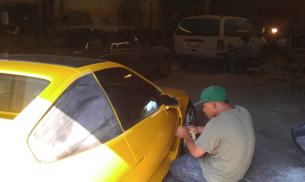

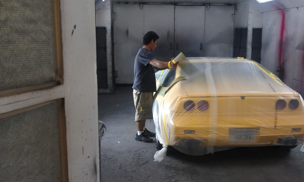

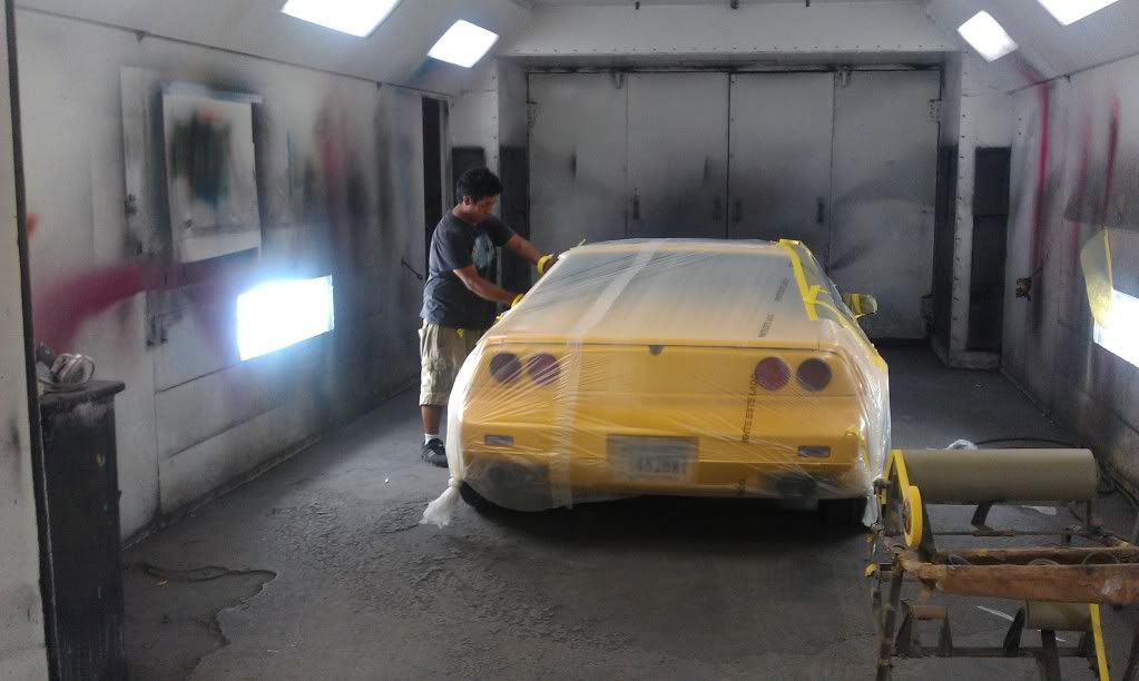

Hello to all who have been following this project. Over the last few days I've had some minor touch ups done on the paint.
and the end result....
Last Friday night I installed clear turn lenses with amber LEDs. Didn't take the picture until Saturday morning.

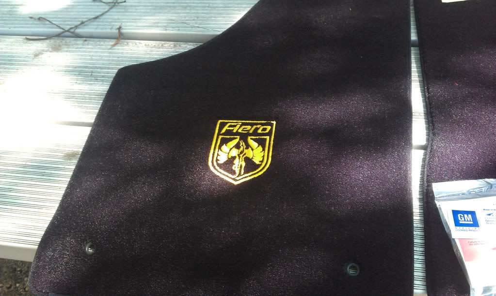

This evening when I got home I installed my new Lloyd Mats.
