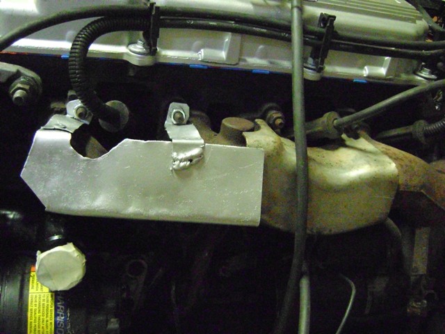

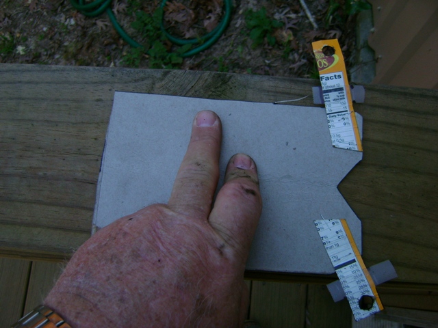

Built and installed the heat shield that will be between the water pump inlet, AC hoses and the exhaust manifold. I built it from cereal box cardboard first

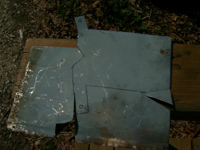

, then drew it on metal before I cut it out.

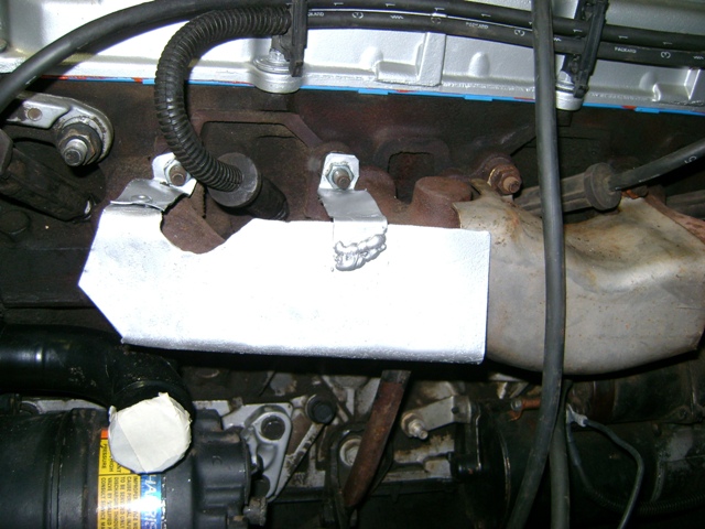

 Cleaned it up and sprayed engine enamel on the new heat shield, mounted it on the engine:

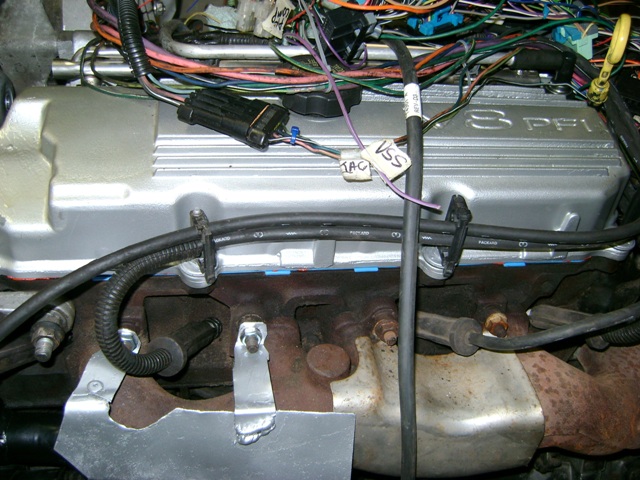

 Katerak sent me three more of the long studded valve cover bolts. These cost over $17.00 a piece at the GM deallership down the road. Painted them silver and put them on the engine. I had a few extra wire separators and used them to tidy up my plug wires. Now both sides of the engine look like this:
