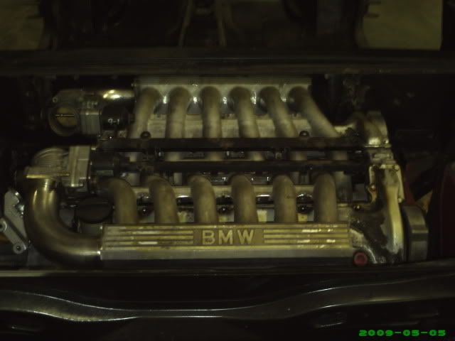

Transplanting a V12 transversly into the Fiero is an impressive feat of creativity and engineering and I applaud his ability to do so. Unfortunately , from what I have seen regarding the tight clearances that already exist for this Miura fiberglass body over the Fiero chassis , I doubt the body could accomodate an additional 2 inches of chassis width and keep the tires inside the wheel wells . In addition , as others have commented , the LS3 provides a higher power to weight ratio than the BMW V12 and certainly benefits from availability of affortable aftermarket performance parts . Neverthelesss , I agree that a transverse V12 in a Fiero should be awarded very high marks for style points and engineering talent. Hope to see more of this amazing project on his thread.

Archie, I agree with the ideas of the two posts above, concerning the possible V12 in your Muira. If not the BMW variety, perhaps the V12 out of a Jaguar? I do not know if this engine, or one of a different manufacturer, is of a smaller dimension. However, I was just wetting everybodies appetite on the idea we can all agree on. Can you at least consider it?
Cordially, Kevin

I admire people who go outside the box to do something that hasn't been done before, or at least hasn't been done very often. After all, I was there 20 some years ago when I started putting SBC's into the Fiero. Several years ago, I did the same thing with the 6 speed swaps & the LSx swaps.
There is a big difference between building any First Time Swap on your own car, when you get a working knowledge of every inch of the car & can prove out that swap AND Building the same First Time Swap for a customer who expects to take home a package proven thru the years.
I've measured the length & width of a V-12 Jag. engine & it won't even come close to fitting inside the frame rails.
While I enjoy reading about that BMW V-12 built, it's not a commercially viable alternative as yet. In fact as related to that type of installation into a customers' car it is 100% unproven. The development costs of making that V-12 a proven swap to put into a customers' car & work out all the issues that would come up would be much more than the engine that he has already chosen. Also, I don't know what a new BMW V-12 engine would cost but this customer doesn't want a used engine in his car.
I could go on but that should answer your qusetion.
