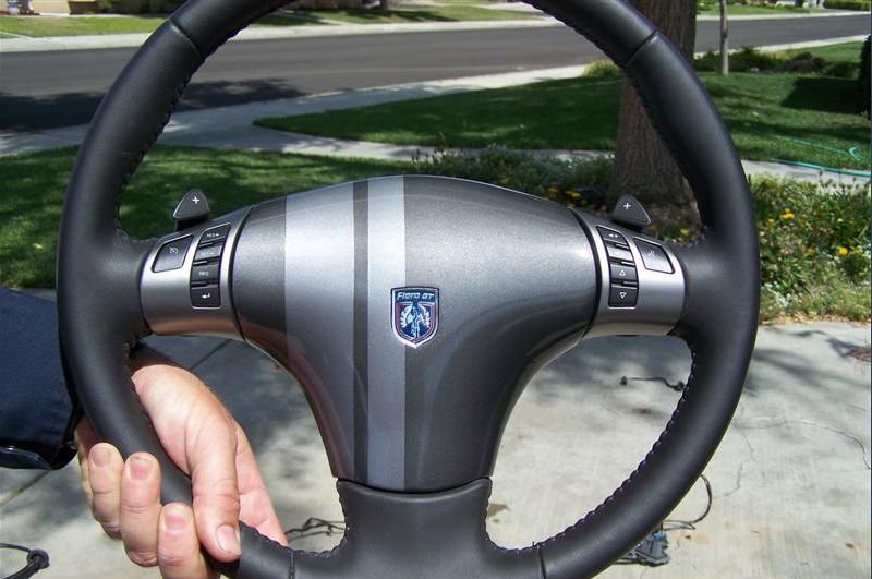

Trying to take my mind off of MAACO for a bit, I started to look into some things I had been wanting to learn more about and do with the interior. I posted a thread asking about different steering wheel options for the Fiero. PaulJK had a couple Firebird steering wheels that he said were fairly easy to install. I looked into them a bit, and it was the older style with the radio control buttons and such in the middle of the wheel. Not quite what I was looking for. I wanted something a little more modern.
He then pointed me to Rickady88GT's build thread, and a Mailbu steering wheel that he had customized:
That is ONE SEXY STEERING WHEEL, but also unfortunately, it entailed changing the entire steering column. Definitely something I did not want to get into.

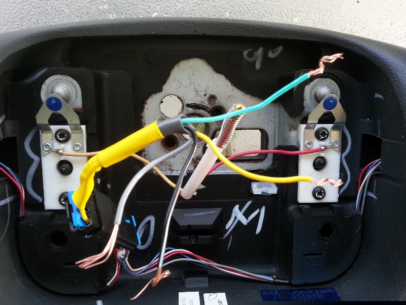

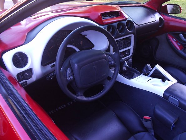

Continuing with the direction Paul pointed me in, I found a post bu jscott1 showing a more modern Firebird steering wheel in his Fiero:

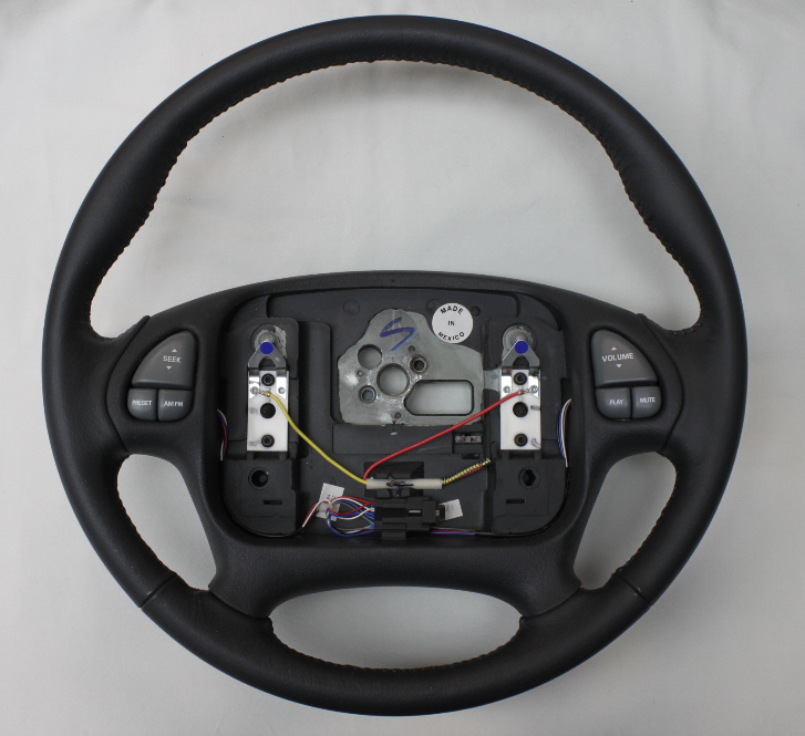

This was more in the direction that I wanted to go, and I found a 93' Firebird steering wheel on eBay, and got it for $40 shipped. It has the radio controls and such where they are easily accessable with thumbs while driving. I have a custom circuit board to interface the buttons with my CarPC, and ability to assign any button on the steering wheel to any function.

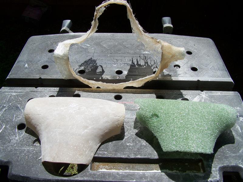

As you can see the center is missing, but after reading Rickady88GT's thread, and how he constructed the center out of fiberglass, I am going to attempt to do the same with the Firebird steering wheel.
This is an image from Rickady88GT's thread, showing how he created a custom center for the Malibu steering wheel.
And just as a raw unfinished part inserted into the steering wheel:

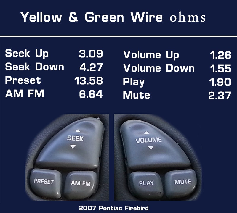

I got more of a chance to look at the wheel, and get some stuff done. At 1am I was in the shed with the multi-meter and getting readings on the steering wheel. The four wires from the left controls, and the 4 wires from the right control meet, and tie in, to then produce only 4 wires on the harness.
Through trial and error and about a half hour of testing all sorts of combinations, I was able to figure that all of the switches, both left and right, just use the Yellow and the Green wires. That determined, I was able to get the Ohms for each individual switch.
The new problem is now with further testing, i need both of those wires run down the wheel to get a signal, as ground is not involved in any way. I was originally going to use the horn wire to send the signal down the column. It looks like I am going to need to find a 2007 Firebird in the junk yard, and pull it apart to get the lower portion of it. I have never done something like this, so it is going to be a challenge for sure.
In the mean time, I started sculpting some green foam into the rough shape to make a mold for a cover for the center of the steering wheel:
