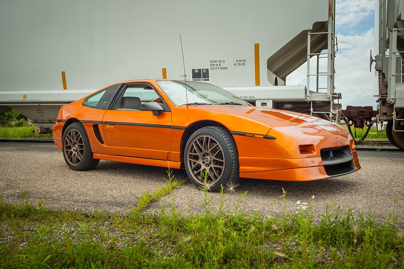

            Well it's been a little over 2 years without any sort of update so I should probably do that.  The swap is still running strong, the only trouble I had recently was a loose cable at the starter causing a no crank issue. This spring, after a couple years of living with the dark green color,  I decided that I had had my fill of plasti-dip and it was time for a change.
   I contacted a friend of mine who owns a vinyl wrap business and worked out a deal to get my car wrapped. So the adventure of removing all traces of green plasti-dip began. I ended up removing all but the fastback clip and the roof panel to get rid of the dip overspray.  There are more nooks and crannies on a Fiero for the dip to hide than I could count.  There was also some body and paint problems to address before the wrap could go on.
  After The wrap was done and the car reassembled I decided I wanted get rid of the fiberglass pieces and to go back to regular quarter windows. After weighing my options, including a pair of NOS windows, I decided to get the new Fiero store premium quarter windows.
  I did not use the supplied tape. I opted for 3M urethane foam acrylic adhesive tape and adhesion promoter.
  I also wanted to go with a bronze colored wheel but they weren't in the budget so I opted to paint my existing wheels. I used Dupli-Color wheel paint and matte clear. This is great stuff, it laid down nice and flat and covered in just a few coats.
  So after all that work, this is the new look.

            Love the new color, it really suites the car. ------------------ 84SE, aero body, 4 speed and an injected 355 V8
              shemdogg
              JUL 10,  10:42 PM
            Im diggin the color, whole car looks killer!
  shem
              Sage
              JUL 11,  06:59 AM
            Very nice!   The "new" look really makes the car look like a true "exotic"...nice work.
  HAGO!
              Vicophine
              JUL 11,  08:16 AM
            I normally am not a fan of people modifying the body of Fiero's too much (Just purely personal taste), HOWEVER, yours is absolutely fantastic. Love the look so much! Great taste and beautiful work!
