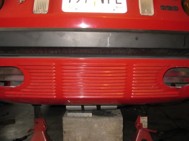

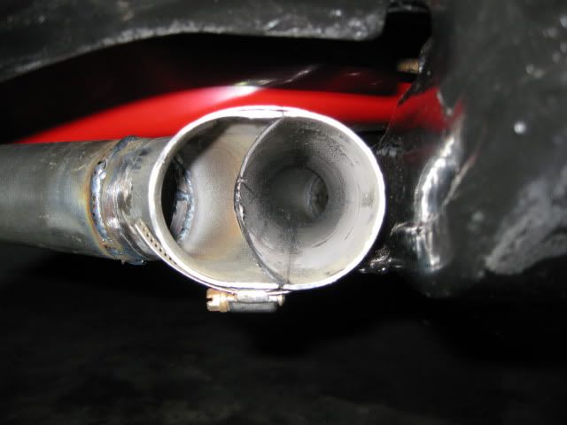

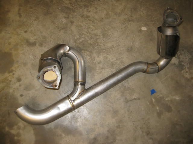

Exhaust is done back to the muffler. Need the Mera specific tips before I can finish the exhaust.
Here is the fit for the rear merge section between both tubes before welding:

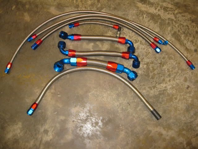

Finished building every AN/braided stainless hose:

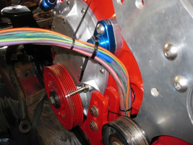

So moved on to the wiring... The blue tape at the AN fitting will ensure proper length to the 500 connector.
The same goes for the blue tape by the VSS for the harness that goes to the ingnition box for the proflow system:

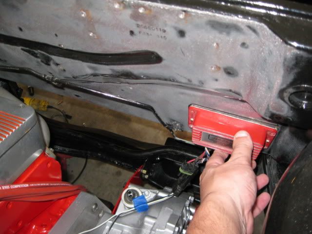

While the engine was in, I made this little template to locate the bulkhead connector on the harness:
Still need to POR the engine bay, finish the harness, finish the exhaust and then put it all back in to make some noise!
