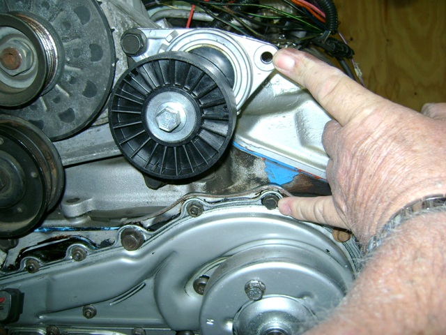

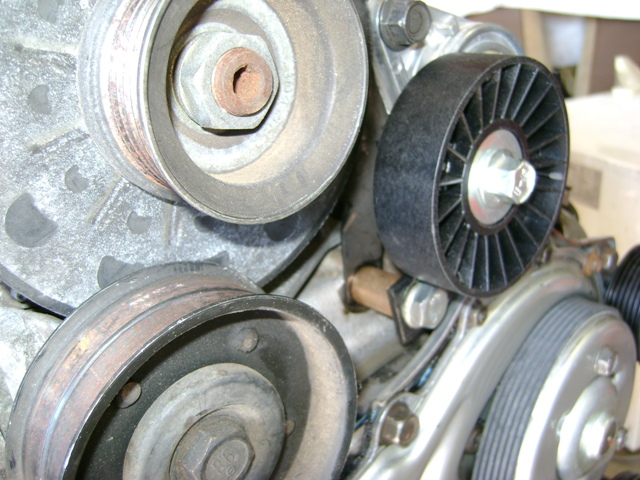

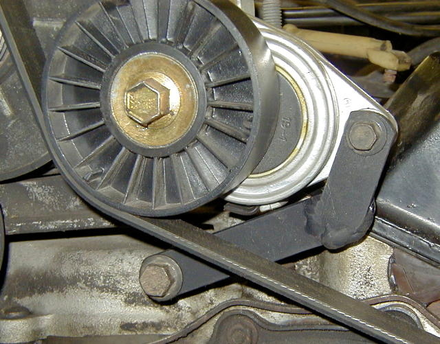

Anybody have the measurement between these two points? I tried to put a 79.5" belt from AutoZone on today. It was to small. I will replace it with a 80.2" belt tomorrow and see what happens with it. AutoZone offers a 79.8" belt also
I built my bracket leg just like this one OldBob built and used:
I was able to get some little things done in the garage today. I am debating on wheather or not to get some Dynamat to do the firewall with. Thats expensive stuff!!!!!

80 1/8" belt was to large. I exchanged it for a 798K6 from AutoZone. This belt is between 79 1/2" and 80 1/8", or the neighborhood of 79 3/4". It is the perfect size.

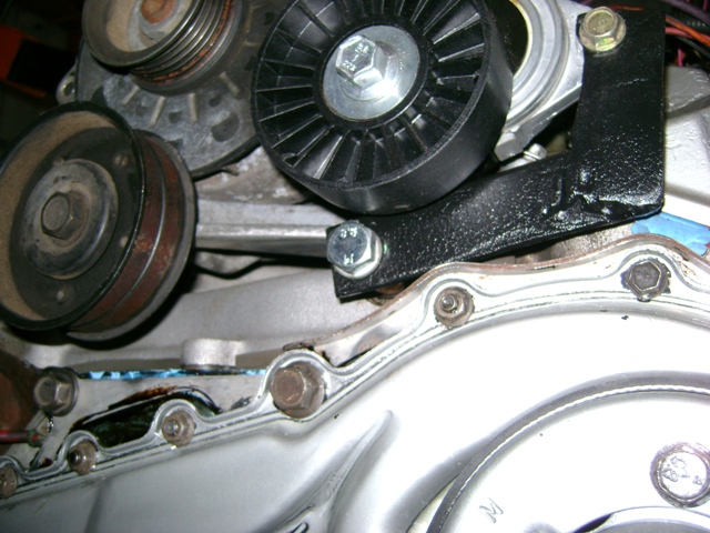

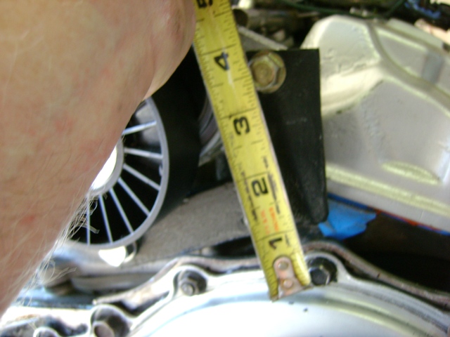

On the home made bracket the longer leg was 4 1/2" long X 1 1'2" wide, the short piece was 2 1/2 long X 1 1/2" wide. Both pieces were 3/16" thick.
The measurement from the tenisoner to the water pump bolt was 3 1/2". There was an upright metal bracket that goes between the intake and the altenator mount. I kept it in the mix. I figured if it wasn't needed, GM would not have put it there in the first place.

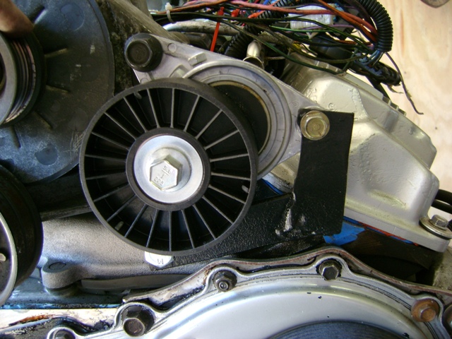

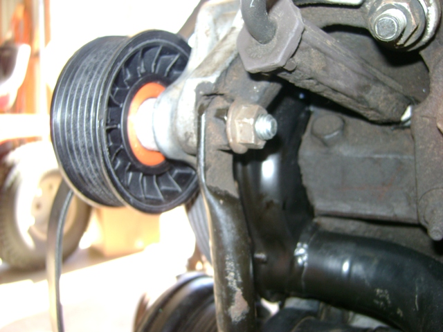

My Homemade bracket , copied from OldBob:

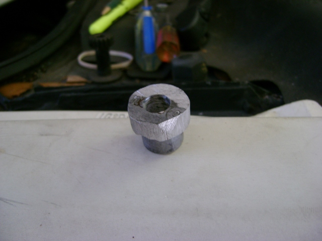

I used a brass bushing that I had modified to 15/16" and put between the bracket and the intake manifold:
Shot from underneath

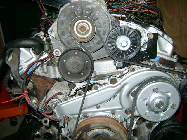

Everything tightened down and the belt mounted
EDITED TO ADD:

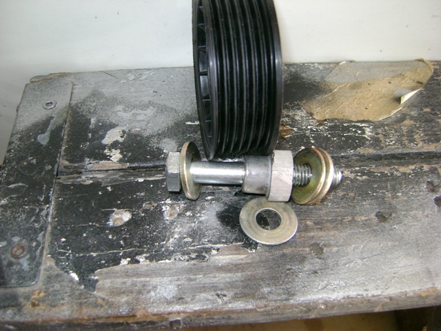

Some one was asking about how to mount the idler pulley for the belt. I sent him these instructions on how I did this, and have cut and pasted it here from his thread.
I removed the mount for the idler pulley from the Cadillac belt tensioner with a hack saw.
The stub is the correct dimension for the new idler pulley mounting hole.
I drilled out the stub so a 10mm bolt would go threw the center.
This was just short of 1/2". Some one here posted the space behind the pulley was about 1/2". Measuring the base of the stub, I added two flat washers behind it to make up 1/2".

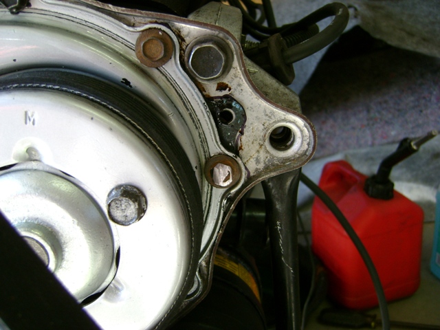

This bolt threads into the upright brace behind the water pump housing etc, while the lower end of the brace mounted to the AC compressor. Notice that I had to remove a bit off of one water pump bolt
Jam nut on the back so the bolt doesn't back out and get loose
I had noticed that the off set wasn't the same on both sides of the pulley, one way was just a bit different. You might need to try both ways to see which way is best for your set up.
