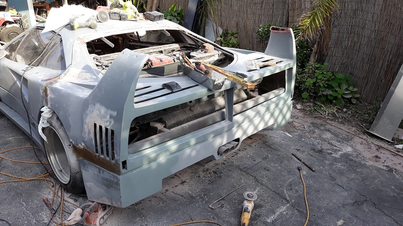

Thank you! Stance will get better w suspension n wheels/tires. Good enuf for now. Almost done w the back, had a few hours to
throw at it today. About a foot of water in the spare tire well drilled a bigger drain hole lol. Rained overnight and the interior stayed
dry! This corners fighting me
cut it up and extended it w a few other areas
Almost done
looking waaaay better
def worth the work

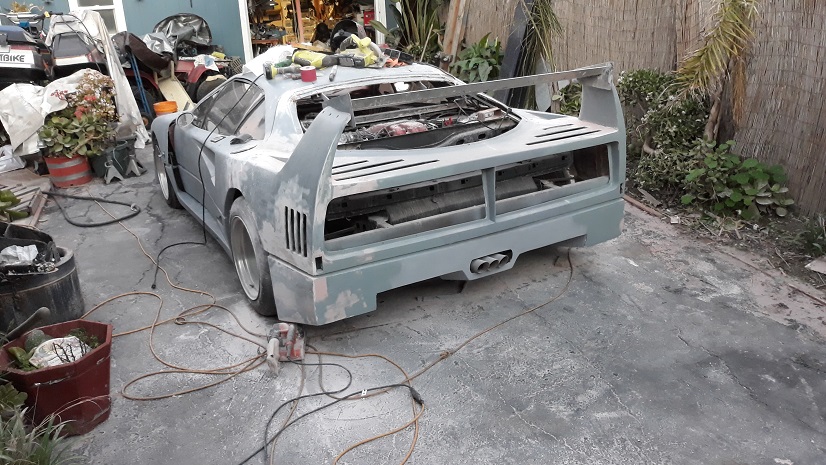

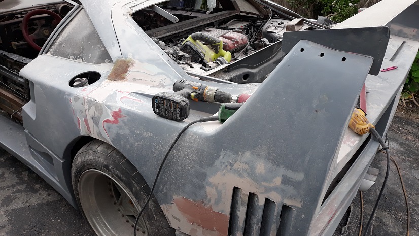

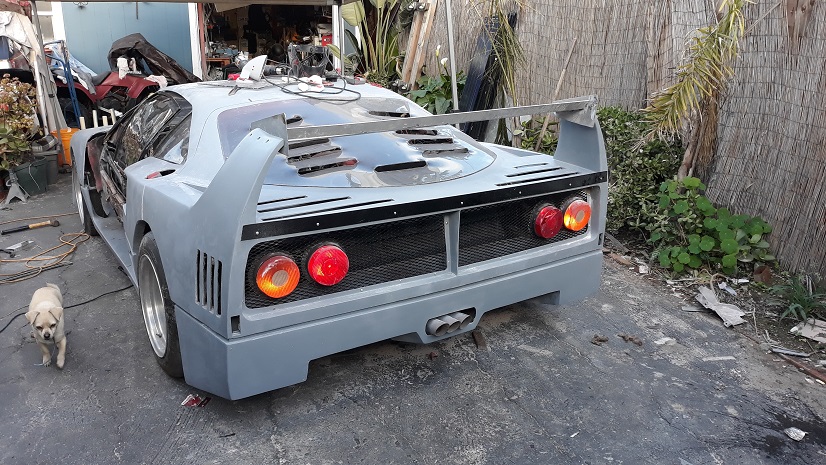

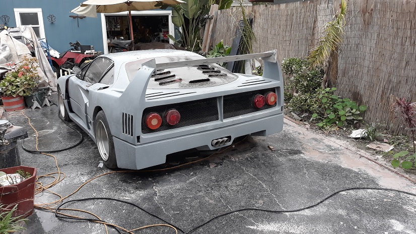

Got a whole messerschmidt done yesterday n today Sand fill booger, repeat
Started out yesterday w sanding n painting the door window frames cuz theyre starting to surface rust.
Played w the gas filler, need to make a custom pipe from the cap housing to the fill hose. Car ran outta gas today

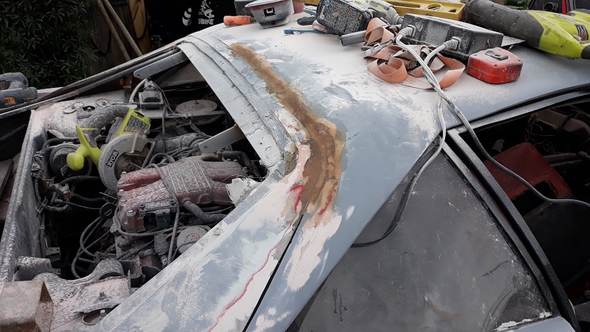

when I went to move it. Batterys totally toast from sitting. had to join the trunk n roof again, gap was too big
more boogers n snot everywhere, millions of details. & rounds of fb n 4 rounds bondo yesterday
No time for love dr jones, rains coming. Finished it up n shot primer

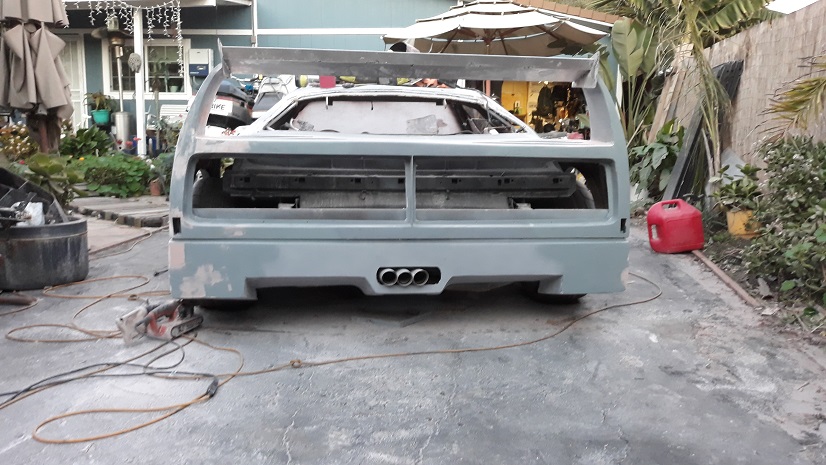

rear grille didnt fit no mo, so I cut it in half and took out from the middle what I didnt need
looks much better, doesnt look like a bumper car as much

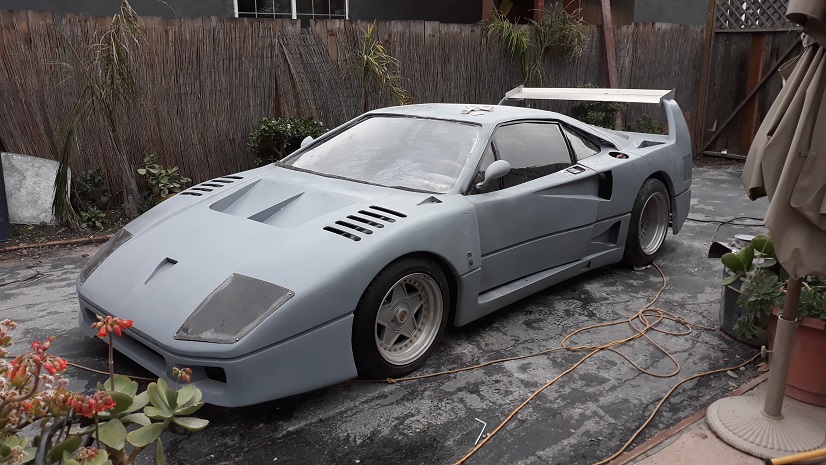

Finally pulled the sheet off the windshield. Way too late, hadta get it off w a chisel n heat gun
Just in time, rainsa here
shem

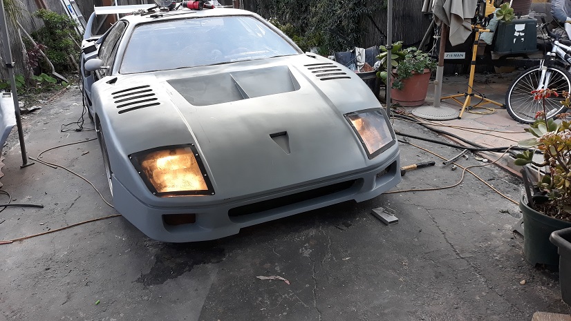

Me too tho itll be awhile before paint. Been working on lights, got everything working now except front turn signals. neghbor used my voltmeter now its not working so I used the dvm on my jumper box w a pick for testing. Bent up the ps window some more, hooked it up to the power window motor and it works! Mostly! Have some metal edged window channel coming. Gave up on modifying fiero door seals, finally found what im looking for after hours of searching. Instead of searching door seal, or universal car door weatherstripping, ect, it came up as universal push on top bulb seal. WTF!? So I should have the interior pretty airtight soon. Installed the grilles in the hood, glassed in the headlight buckets to the hood. made new hood hinges to get the wheelwell lined up better. Welded in the ds window frame better. Buncha other details done I cant think of but its coming along. Rains here for the next week so I prolly wont get much done. Got some tiny round side marker lights coming and a glass cutter for the windshield. Back windows installed now. Hands need a break theyre pretty mangled again. Had a fb splinter the other day, that sucked. Cant see the thing, dug around w a romex staple till I hit blood then squeezed and the thing shot out.
