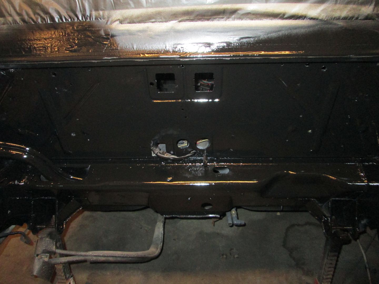

The engine bay is black again. It is glossy because its wet. Once it dries, it will have a dull satin finish.

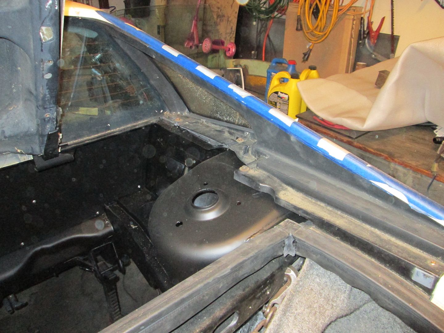

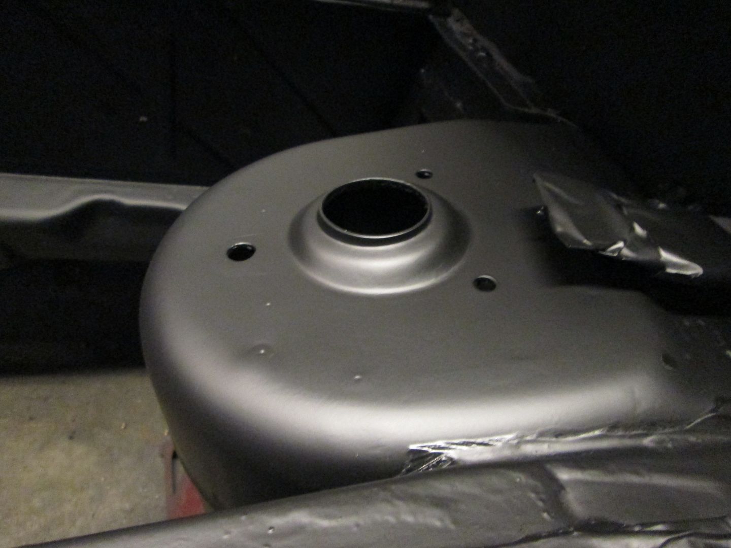

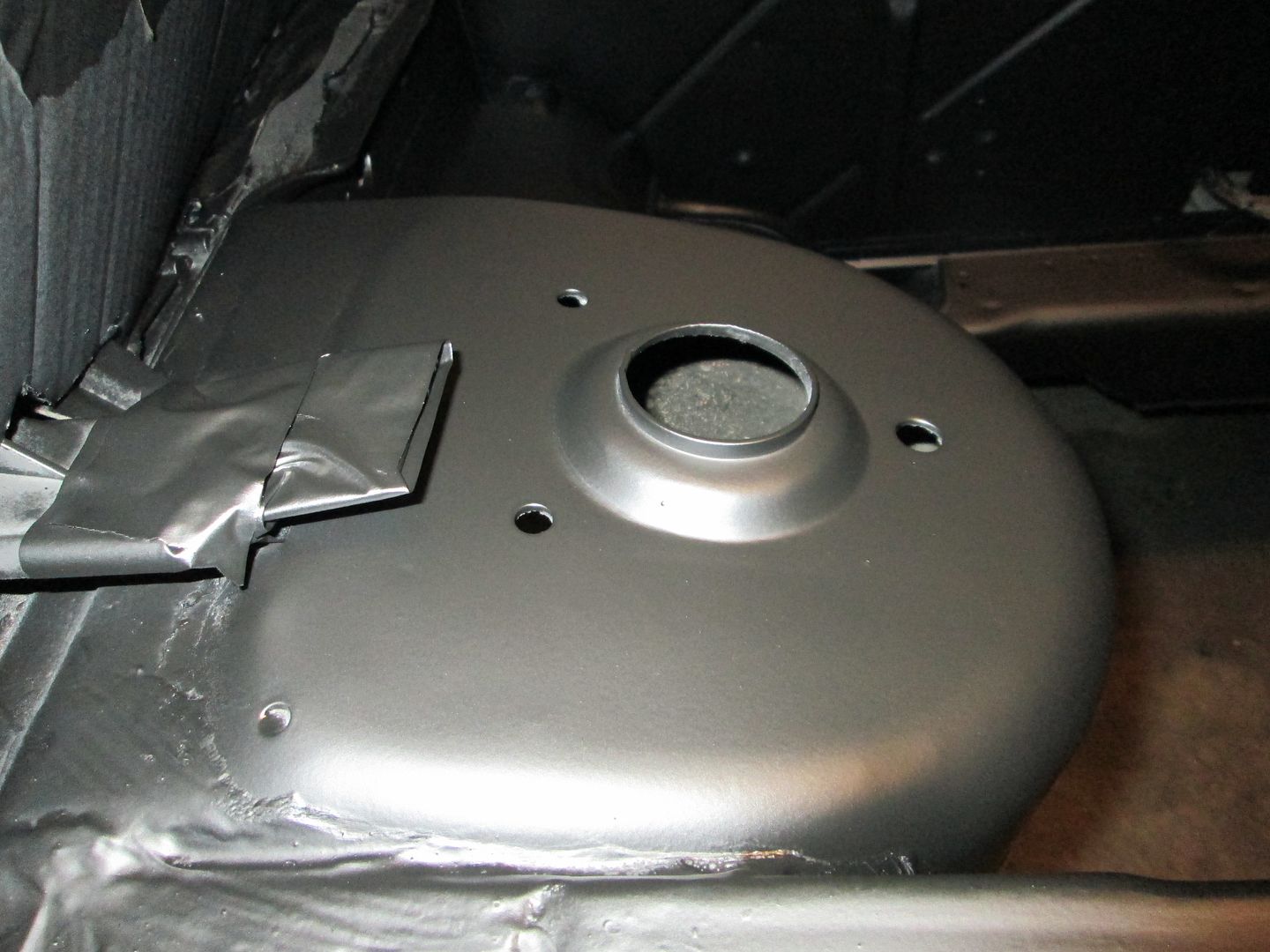

Here are some pictures after the paint has dried:

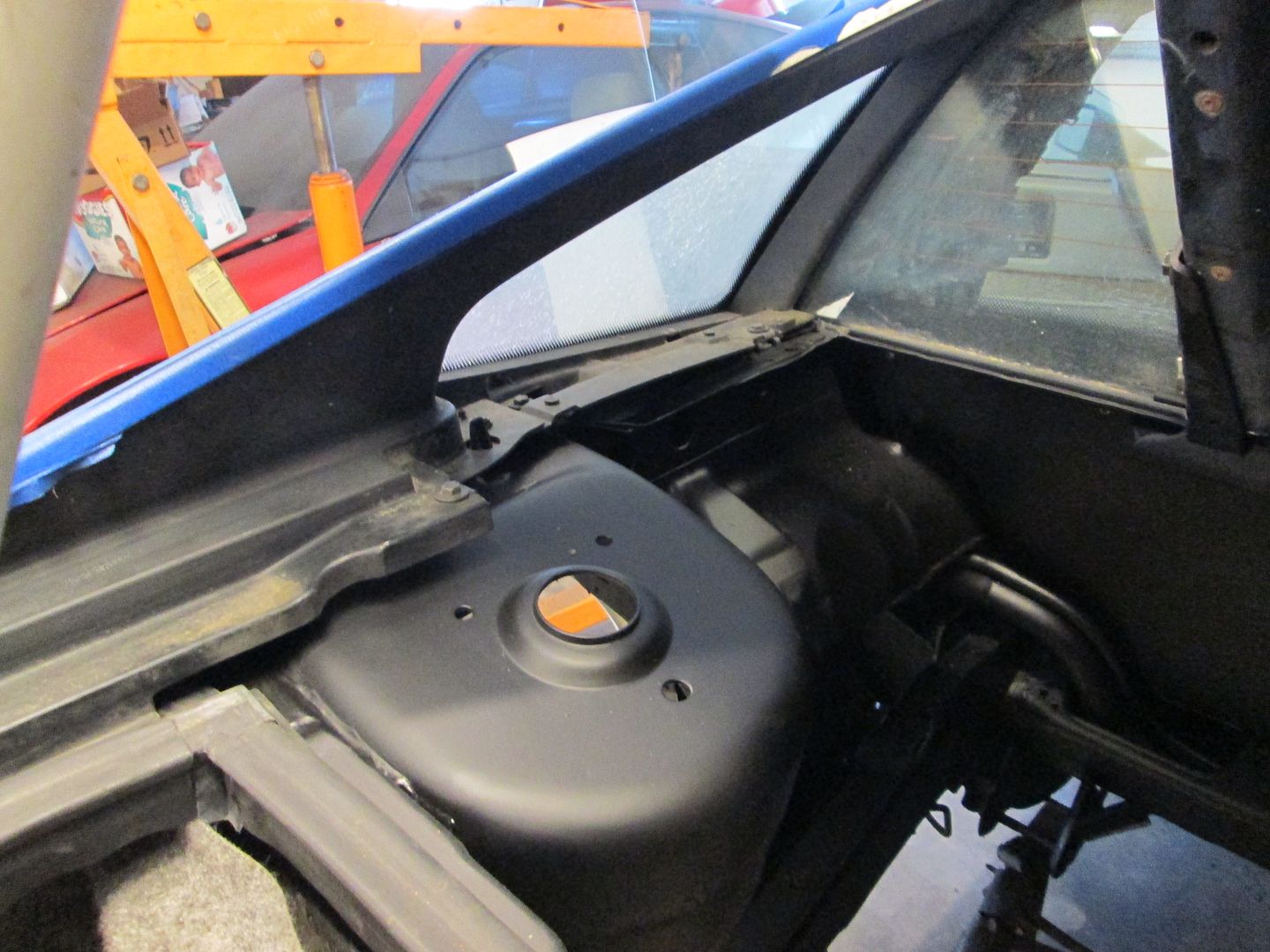

Between work being busy and 3 power outages this week due to weather, I didn't make much progress until today.

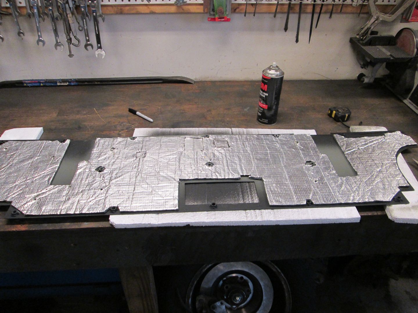

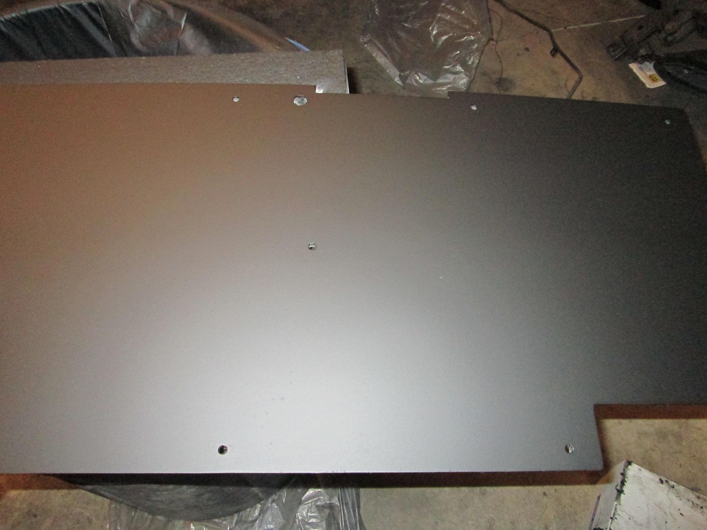

The hinges, firewall panel, decklid, inner sail window trim and truck weather stripping were installed. Prior to installing the firewall panel, I re-purposed the sound deadening material that was originally on the firewall and used some spray adhesive on the backside of the panel to hold it in place. The material was also trimmed to clear the hinge extensions as well.
The nuts on the inside of the firewall panel. The ones with the large washer are for the hinge support:

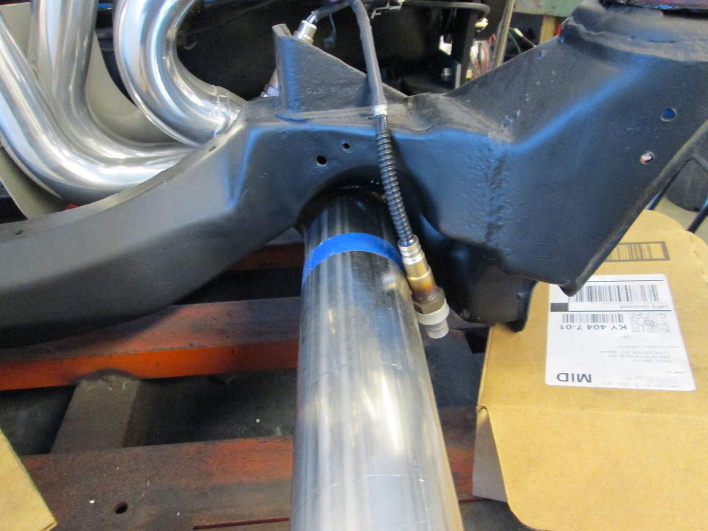

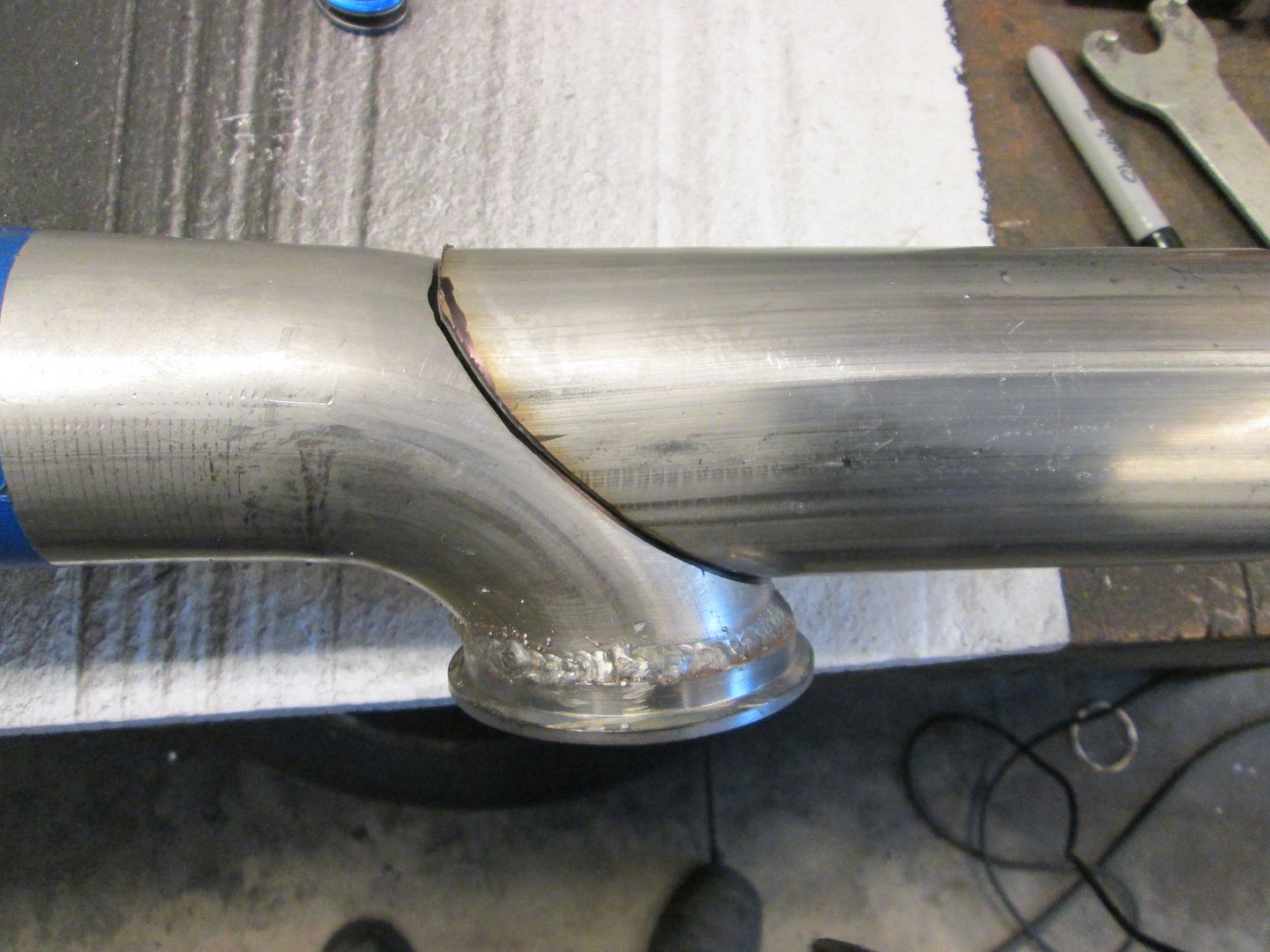

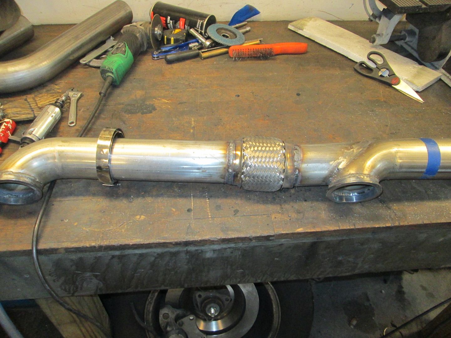

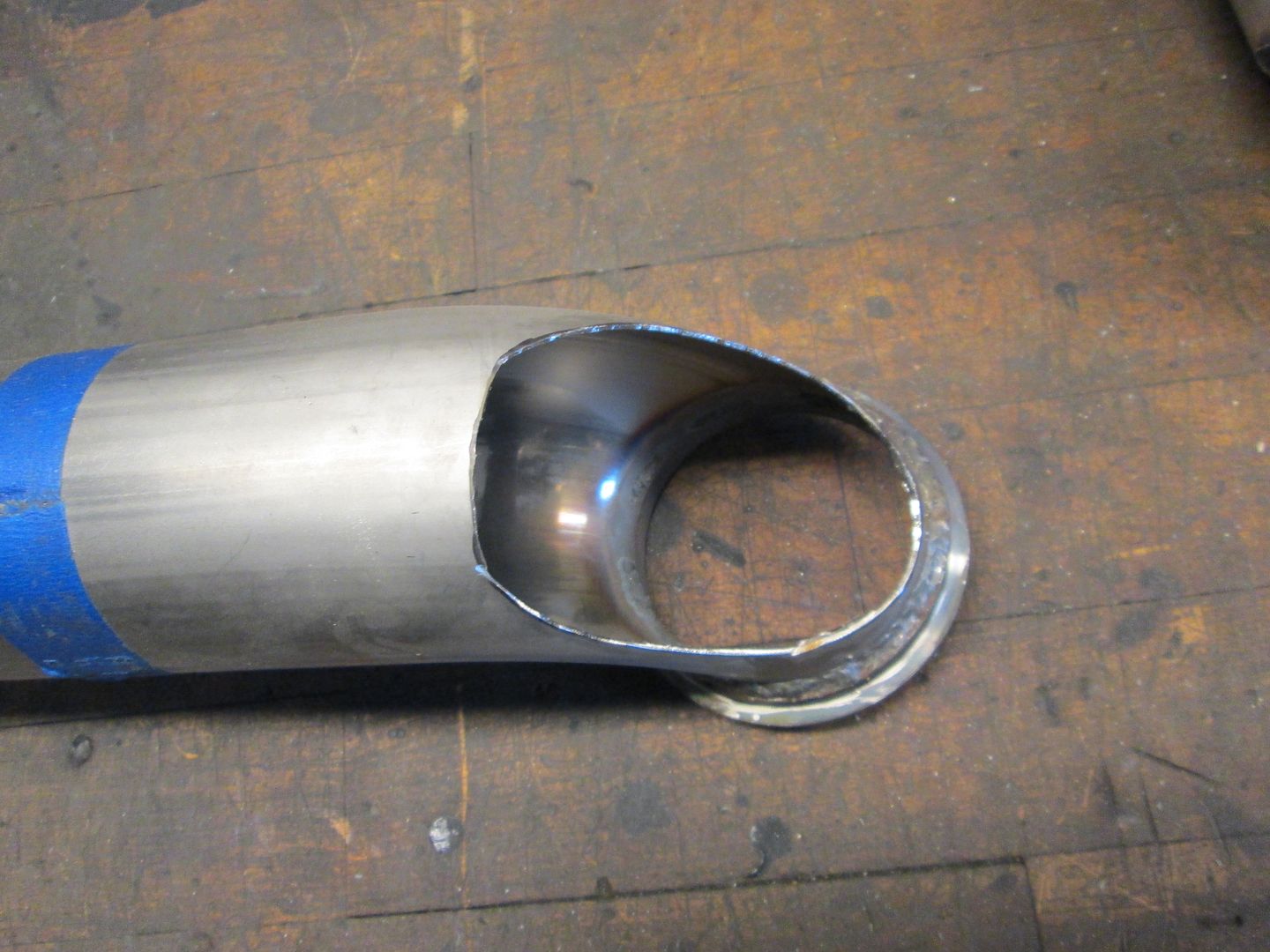

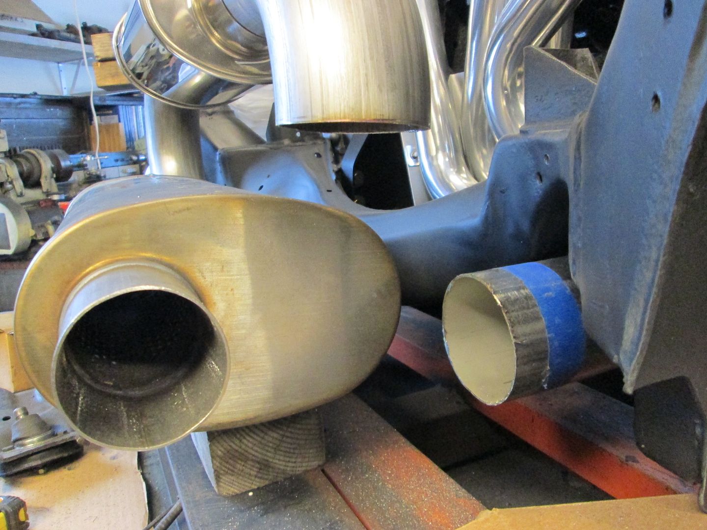

Then it was time to switch the welder over to stainless wire and tri-mix gas and do some work on the exhaust. I started with the front collector and trimmed the 3" mandrel bend to the right angle and then welded it to the V-band:

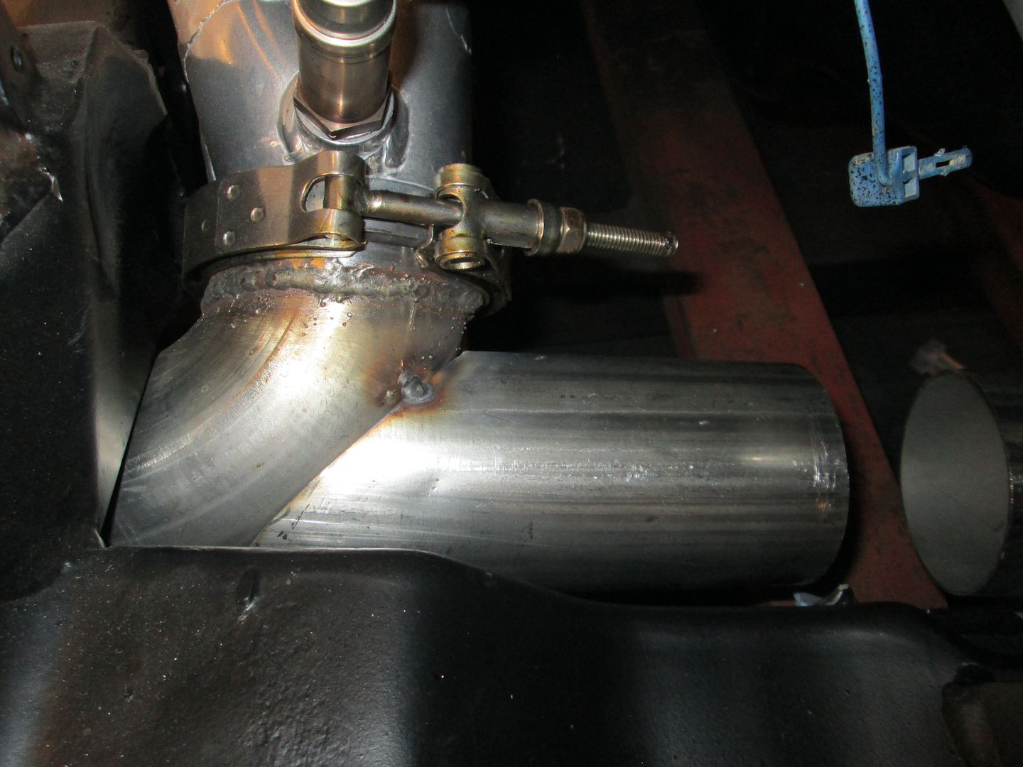

Then I did the same for the rear collector and started to shape the other section of pipe that will join up with the front collector. Lots of cutting/fitting/shaping:
Then I welded in a flex section to connect to two pipes:

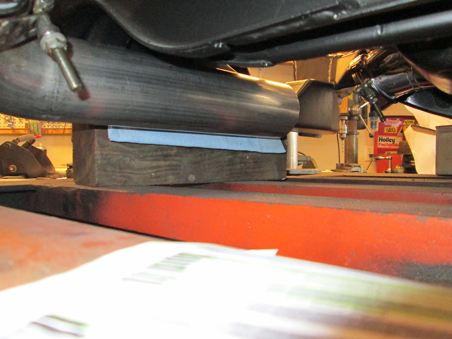

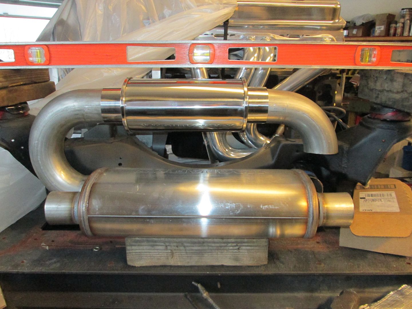

Then I started to mock up the muffler system. The trunk on this Fiero is gone, so the bottom of the trunk is 4 1/4" from the top of the rear cradle mounts. So I used some 4x4's on the rear cradle mount and placed the level across the top to get an idea of the vertical room I had to play with. The pipe coming from the collectors was trimmed back some (needs trimmed a little more) and then I placed the muffler and resonator in place:
Still more work to fit up everything on the muffler system, but it is coming along...

Did the bolts holding the headers to the heads ever work loose. I am using the same ARP fasteners and don't want anything to work loose. The V-bands shouldn't work loose.
As for the ground clearance, only the pipe connecting the two headers is below the cradle. If it was in the center of the car, then there might be some concern about hitting it on a high crowned road. With it being as far to the side as it is, I doubt it will ever hit anything. My LS4 exhaust hangs down the same way.
