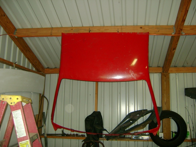

Poe and I removed it last year about this time. VERY carefully. It has been hanging in my garage since then. I am changing from a sunroof to a non sunroof. I was tired of the wind noise and a sunburned bald spot on top.
Rick 88
MAR 31, 07:55 PM
I am considering doing the same thing. How did you cut thru the adhesive?
josef644
MAR 31, 08:08 PM
I have been told that it is easier to remove a Sunroof top than the non sunroof top. Tbone here has a thread on removing and swapping the roof out with another member. It is pretty good. I purchased a few used butter knives from a resale shop. As I was able to saw threw the butal, I slipped paint stir sticks underneath to seep it from re sticking http://www.fiero.nl/forum/A...120111-2-109675.html
I got this from Poe 6-28-11. It was hanging there until yesterday afternoon.
