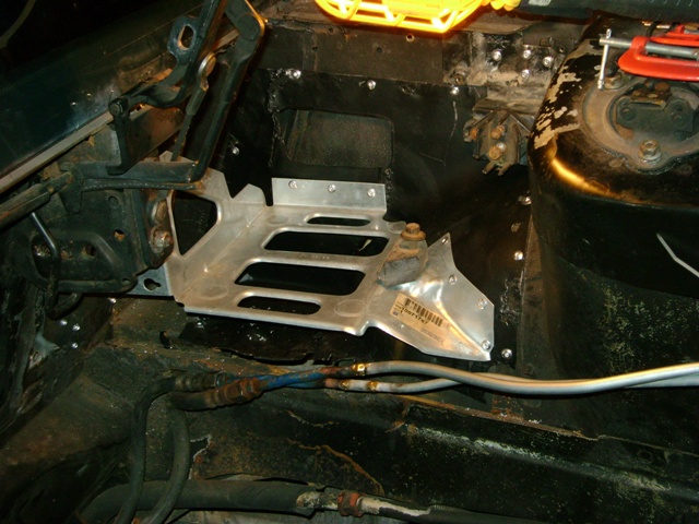

JAN 25, 03:50 PM
I installed the battery support and the black piece of metal that is underneath, and behind it today. These are two items much easier to install with the engine out of the bay:

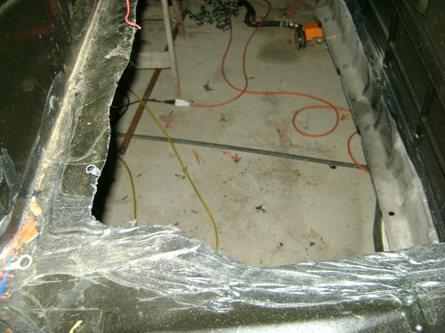

JAN 28, 12:22 PM
Cut out the trunk this am:
I will be following this system someone here used
