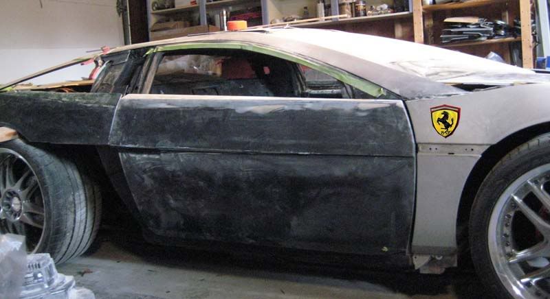

I'm using old RBS doors that had reverse chop about 1-1/2" to 2-1/2", this what it looks on RBS2...
It nice to see that your build is coming out very exotic as a true one off design and not a replica clone. You gleaned ideas from various parts and are making the car your own. I'm digging the rake, A-pillars, doors, rear clip, windshield and hood (everything on the car really). I'm glad to see your reusing the doors too. Keep up the good work.

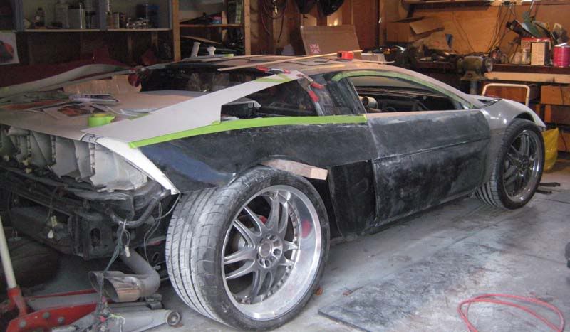

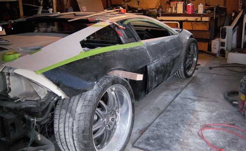

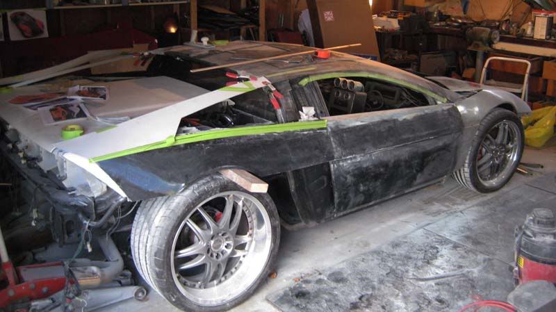

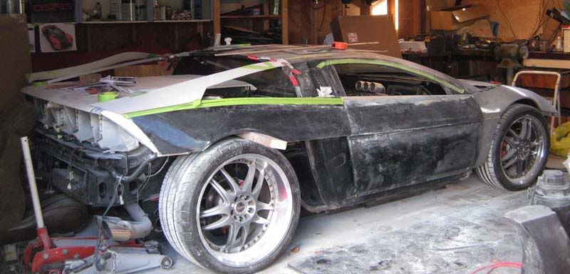

A few more overall views, line on tape showing nice flowing line from door to rear
