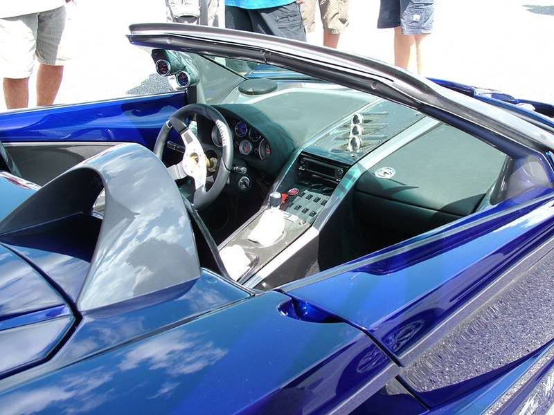

Trying to remember without re-reading the whole thread, but did you ever consider roll bars ?
The car looks great without, but was just curious.
The ones on the K-1 attack look great, but don't know how you could incorporate them into the fiero with the decklid grills/vents so close in proximity.
[This message has been edited by exoticse (edited 02-12-2008).]
Jake_Dragon FEB 12, 09:43 PM
Just cant see it.
Fiero2m8 FEB 15, 04:22 PM
Basically, I have considered them many times but haven't found something I think would improve the look.
Most of the looks I like would involve reversing the way the decklid opens or modifying the vent openings (like Saturn SKY etc).
The easy way would be to mount roll hoops to the new frame on the top of the firewall, but I really haven't found ones I like yet.
They could easily be bolted where you see the carpet below:
