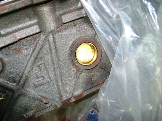

This morning I installed the brass freeze plugs on both sides and on the front.

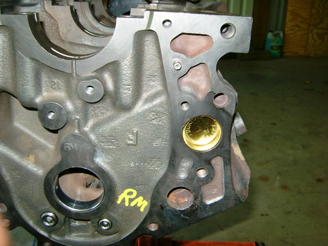

 and the front:
Mounted the rear main bearing cap on the block, and put my new oil pump on. I inserted the pick up tube and put the oil pan on the block. Reaching up threw one of the cylinder borers I was able to push the pick up tube up until it touched the bottom of the oil pan. Removed all and measured the height of the end of the pick up tube. Then lowered it 5/8 inch. I will have it tack welded with brass before final installation. These never fit as tight in a second oil pump as they did on the first time around. The tack weld is just good "insurance".
