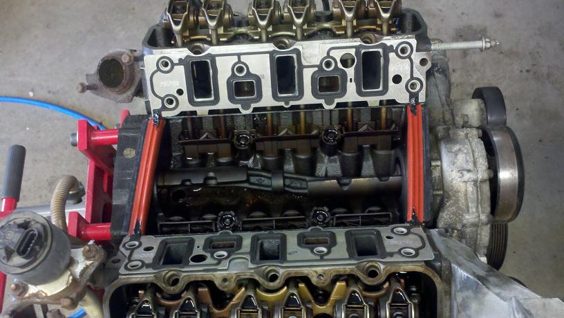

well go ahead and take off the LIM and take the TB off the supercharger and clean everything separate. It will be a lot easier.
hercimer01
MAY 17, 08:08 PM

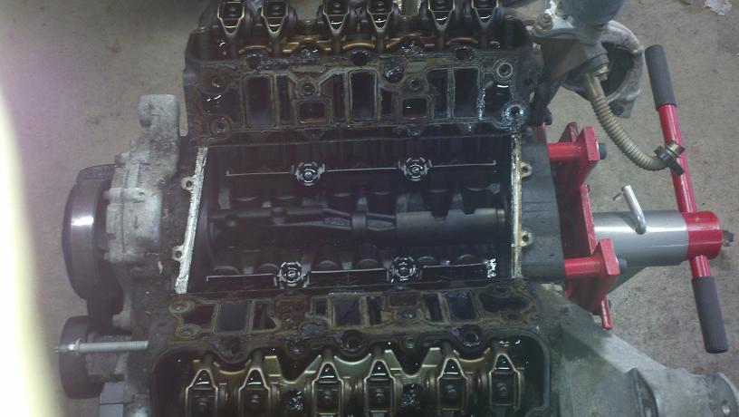

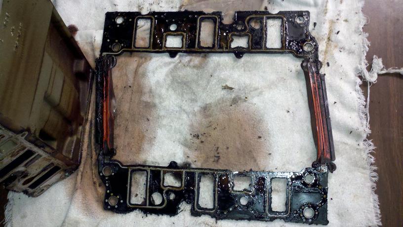

I pulled the LIM today. I has the original plastic gaskets.
fierogt27
MAY 18, 04:13 AM
I know your trying to do low budget but go ahead and fork over the 50 dollars for the aluminum gasket. especially if your going to continue moding it
Edited because my stupid computer auto corrects[This message has been edited by fierogt27 (edited 05-18-2011).]
hercimer01
MAY 18, 04:23 AM
| quote | Originally posted by hercimer01:
MS98014T Aluminum Intake Manifold Gaskets
These are aluminum right?
What do you mean by "molding it"
fierogt27
MAY 18, 06:17 PM
yea man your good on that gasket
hercimer01
MAY 21, 05:26 PM

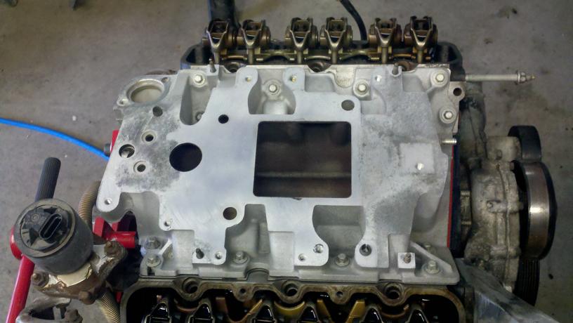

Installed the LIM today.

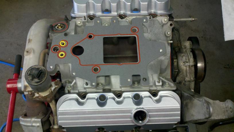

I painted the valve covers.
jasonfox
MAY 24, 01:00 PM
I would have plugged those coolant passages to the TB in the LIM.

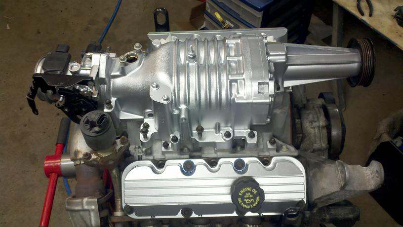

I was out of town this week. I was looking forward to getting back to work on the engine. I painted the throttle body and supercharger.
