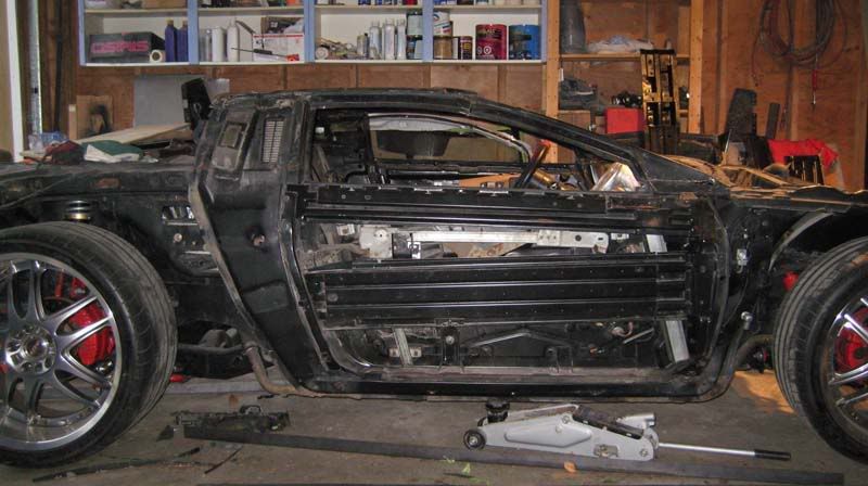

Okay, a little tease (things to come) 4" chop...

One of the design features in your car that I really like is the way you continued the curve from the side scoops up to the sail panels. It flows so well. Oh by the way I started a 4.9/F40 6sp swap in my Fiero. Jim

One of the design features in your car that I really like is the way you continued the curve from the side scoops up to the sail panels. It flows so well. Oh by the way I started a 4.9/F40 6sp swap in my Fiero. Jim |
WOW, I really love to see your project
That design might change, we'll see how everything fits with the smaller sail panels
