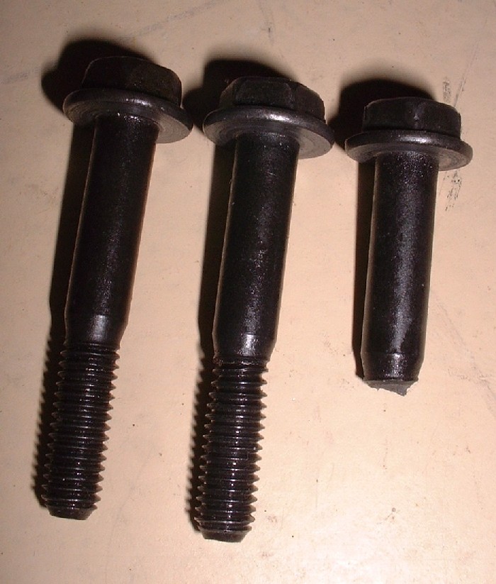

Now I doubt this is a common problem with Northstars, because I would’ve probably read about it given the volumes of info I researched before diving into this, but it is something you should check if planning on using a warmed-over Caddy engine. The one cap bolt was loose because it was broken(!) where the threaded portion met the shank, its weakest point. From the fracture site, the failure mode was obviously tensile loading and not shear, in other words, it broke after it was torqued and not during the tightening of the bolt. I'm guessing that someone didn’t have the torque specs for the bolts or didn’t use a torque wrench to tighten the caps at some point in the engine’s history. In any case, this one was torqued beyond the bolt’s yield point but not quite enough to break it. The loading of the bearing caps from operating forces on the cam were enough to tip the scales on it and break it in tension.
Now have a look at the picture. The bolt on the left is an unused one, the one on the right is the broken one (duh), and the one in the middle is what four other cam-bearing cap bolts looked like on that head after I removed them. See anything a little off? The eagle-eyed among you will notice the “necking” or narrowing of the bolt diameter where the threads meet the shank… exactly where the other one broke. Someone clearly used the “it feels tight enough” approach on these caps. I couldn’t be certain of the condition of the remaining bolts, so I turfed them all.

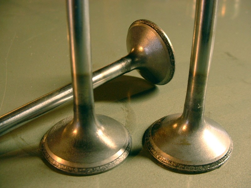

And here’s what the exhaust valves looked like. Beyond grinding. Kaput. Cha-ching! More cash register sounds at my machine shop. By the way, this was supposed to be the low mileage engine. When I removed the valve covers off the high mileage engine, they looked about the same for wear and tear. But that’s OK because I probably would’ve replaced most of this stuff on spec anyways. No point in rebuilding an engine if you’re just going to throw the old parts back in it.

That's really a lot of cha-ching! Cha-ching times 32 valves and times 4 cams.
Does the other engine have useable cams, tappets, valves? Did you disassemble that one?

I didn't disassemble the heads on the other engine to the same degree, but I knew that engine had 250K kms on it. Even if it looked better after taking it apart, I would've replaced the moving parts anyways. 250K kms is just too much to just transplant into a car and hope for the best.
