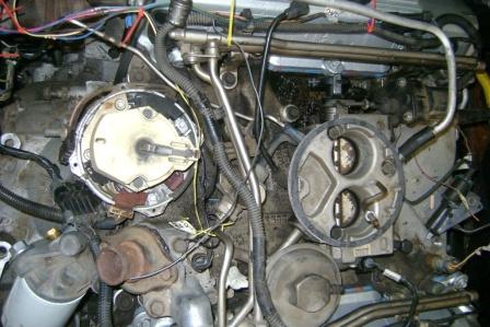

Today I made some progress:
8 ECM injector wires joined up
Dist wires
IAC wires
Coolant temperature sensor wires
About half of the transmission shift & converter clutch wires
I have to work 8 hours tomorrow am . I plan on finishing up the transmission wires and do the MAT and TPS.
Removed all of this today from the Caddie harness:
