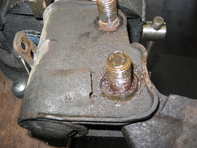

Tony Kania JUN 22, 07:27 PM
Originally posted by mattwa:
I can't get the lower struts bolts out. I tried air tools, heat with a torch, nothing worked. What can i do besides cutting it?
I am guessing that you are talking about the two large bolts holding the strut to the spindle? I sprayed them with PB Blaster for a couple of hours. That did not work, so I took out a 5lb sledge hammer, and went to town. I had new bolts to install. I actually broke the jaw of my vice beating on the bolt. Just don't put any side force on the spindle. Only hit the bolts.
And don't hit it like I have it in the picture. You want the bolts to take all of the force. Not the spindle or the strut.
[This message has been edited by Tony Kania (edited 06-22-2009).]
