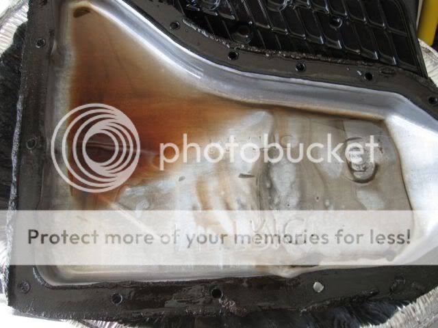

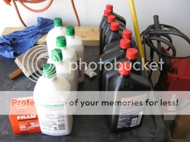

Today we decided it was time for an oil change and Trans service. Pulled the trans pan and much to my surprize, it was pretty clean. Installed a new filter and beat the dent out of the pan.
I can not believe how much oil is! It's ridiculous..... All this cost me 47.00.

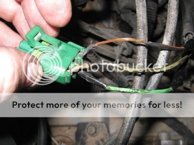

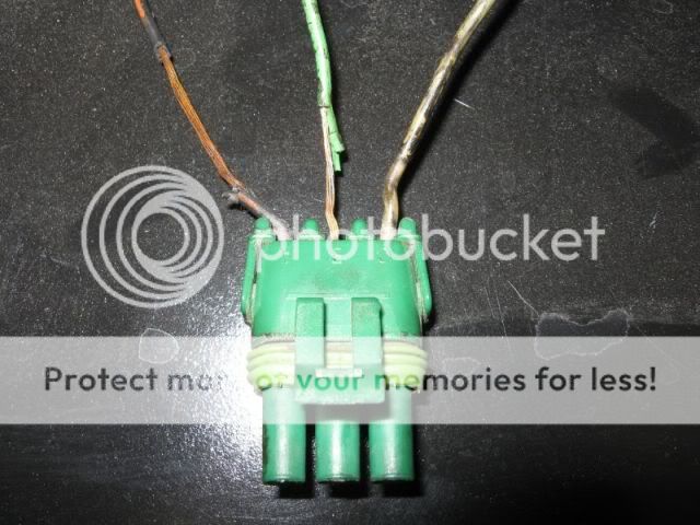

While I had it running and was checking trans level, I bumped the connector that attaches to the MAP sensor and the car nearly died. I started messing with it and I could not believe how much it would affect the way it ran. Must have been shorting out. Anyway, here's what I found. Somebody spliced this connector in. Looks like a pro job to me! The harness has a black w orange stripe, a green and a gray wire. The plg has a black w/ orange stripe, green and a light green wire. Does not look like this is a Fiero plug but the insulation is coming off of them and the whole thing was held together with slimy electrical tape.
Got to see if I can dig up a good plug now! Next week - rebuild the front end and install ne struts and shocks.

KurtAKX MAR 29, 08:59 PM
Originally posted by katatak:
While I had it running and was checking trans level, I bumped the connector that attaches to the EGR control and the car nearly died. I started messing with it and I could not believe how much it would affect the way it ran. Must have been shorty out and oepning the EGR at an idle? Anyway, here's what I found. Somebody spliced this connector in. Looks like a pro job to me! The harness has a black w orange stripe, a green and a gray wire. The plg has a black w/ orange stripe, green and a light green wire. Does not look like this is a Fiero plug but the insulation is coming off of them and the whole thing was held together with slimy electrical tape.
Pat
Dude, that's not EGR; its a MAP connector. It's importance can't be overestimated.
This is not to mention that shorting out the +5V line from the ECM probably temporarily knocks out signal from all the other sensor that use it such as the TPS.
katatak MAR 29, 11:35 PM
Hey Kurt,
I posted a little blurb about this over in the tech section and was promptly corrected by buddycraigg that it was the MAP. I forgot to come back here and edit my post. I did get it fixed though. I used heat shrink to cover the bare wires then soldered the ends together with more heat shirnk. It will get me by until I can find a new plug. I am electrically challenged and I just assumed that it was the control for the EGR. Thanks for the heads up - I will go edit and correct.
