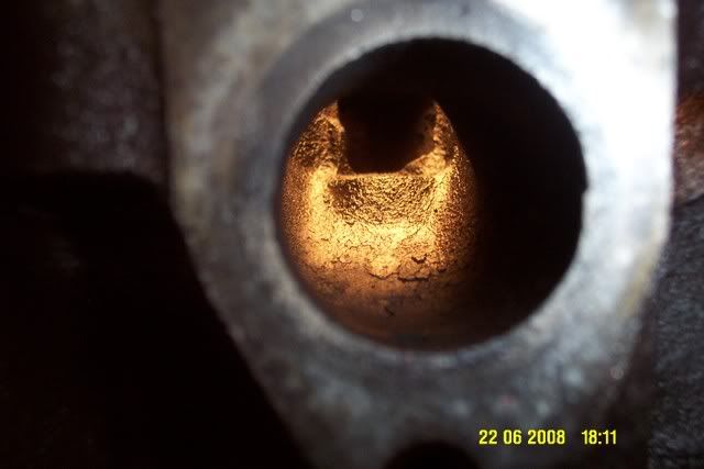

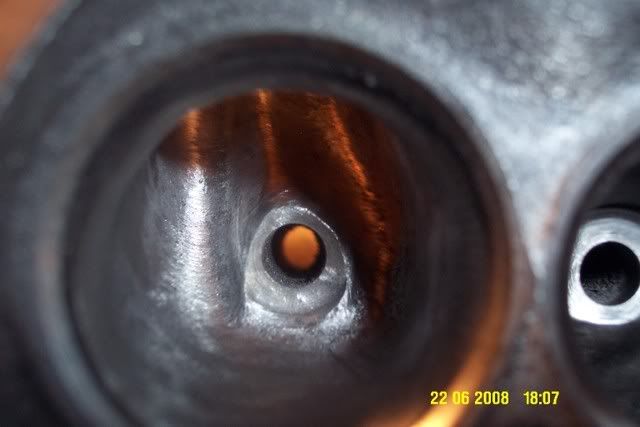

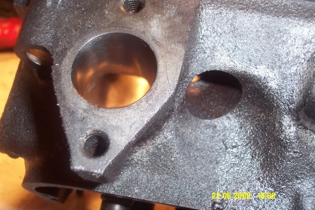

The porting kit came in the mail on Friday, so I started tackling the heads. This is my first attempt at porting, based on the results, it's a good thing I don't do this for a living. The porting was nothing radical, just a gasket match in the intake and removal of significant casting flaws.
The intake gasket match went pretty good, well, except for a couple of slips with the grinding wheel. Intake ports need a bit more time with 120 grit to smooth things out.
Based on the results of polishing the exhaust ports, it looks like I didn't spend enough time with the flap wheel to eliminate all the 120 grit marks, so I'll have to go back over those.
I'm not really happy with the bowl work on the exhaust ports, especially the middle one, so may have to go back over them.
On a couple of ports, it seems like I just can't reach everywhere, so there's still a couple of patches of rough cast finish that I need to try to deal with.

Intake runners port matched and raw head
A couple of shots of partially polished exhaust ports and the raw carboned up one
A couple of shots of the bowls, and a stock comparison

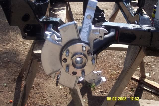

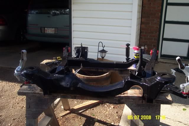

Poly bushings are installed in the front of the cradle and in the rear control arms. New engine and transmission mounts have been bolted to the cradle:

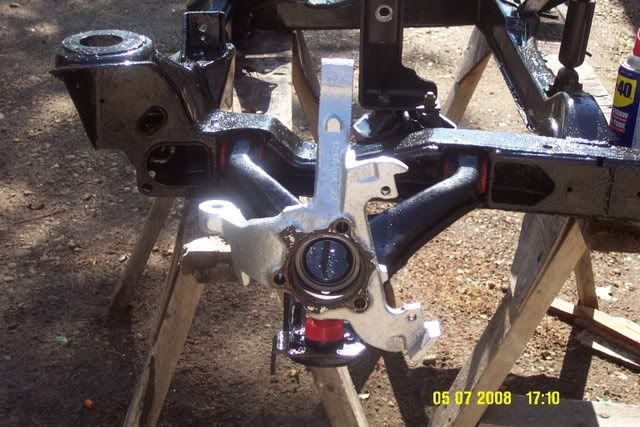

The knuckles are back on with the new axle seals installed:

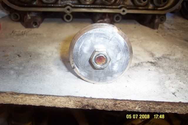

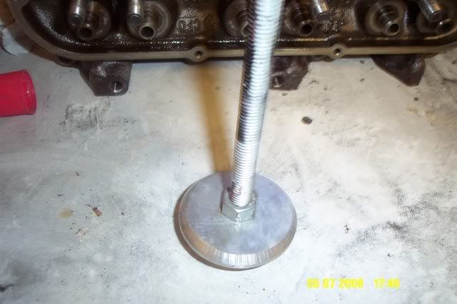

Had a scrap of aluminum left over from a TB adapter project on the LS4, with a bit of trimming and some threaded rod, it made a good tool to drive the new axle seals in:
New hubs and cleaned-up dust shields installed:

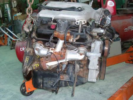

Since I'm going with a DIS system, and not too set on keeping a completely stock look, I thought I'd look at other upper intake manifold options.
The 3.4 SFI upper from a F-body looks interesting, even though there appears to be a clearance issue with the thermostat housing:
 (picture courtesy of Sardonyx247)
Can anyone comment on how this flows compared to the stock Fiero upper?

Wow! Lost this thread for a while. Nice work!
Most people will probably tell you that the 3.4 upper isn't worth the trouble, but that's relative to the installation of the 3.4 in the Fiero. OTOH, if you're going to a DIS 3.1, it may very well be a different story. Although it's kind of marginal for a modded 3.4, it ought to flow plenty for a 3.1. And it looks really cool.  The Fiero upper has a huge restriction where the neck joins the main part of the plenum. The opening is even smaller than an un-bored Fiero TB.
As you mentioned, the thermostat housing is in the way, but someone on the Forum cut a "C" notch out of the end runner, and welded it up. Looked like it should work really well.
While we're on the 3.1... The FWD Lumina car has aluminum heads with much smaller chambers. It has lower compression pistons to accommodate. You'll need the pistons for the iron head version. Think CamaroBird or 91 Lumina minivan (also with iron heads.)
Edit - Since you're already swapping ECMs and using DIS, just swap in the Lumina engine in its entirety. Its intake and heads flow much better than the Fiero's. You might be able to reuse the Fiero timing cover and accessory brackets to save yourself a bit of re-engineering. You might lose one bolt hole on the heads, though.
