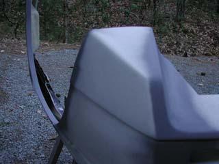

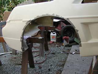

In order to enlarge the wheelwells a small air reciprocating saw makes quick work of the fiberglass:

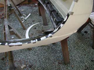

To replace the lip, A thin piece of sheet aluminum is hammered to form a "mold" to support the new glass and resin. By rolling the edge, the contours can easily be blended into the fender, eliminating a lot of grinding and filling later on. An old sign provides a good source for cheep aluminum of suitable thickness, and is easily formed to the proper curve and taped onto the wheel opening after spraying the back side with wax:
Once the form has been set, and fully taped, you can flip the rear clip right side up again and lay in several layers of glass onto the form, and an inch or two up the side. Pretty simple actually, and after it cures for a day I'll pull off the tape and aluminum strip and do some bondo work to finish it off.

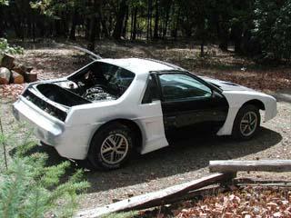

Now THIS is a proper size wheelwell for a "race" car

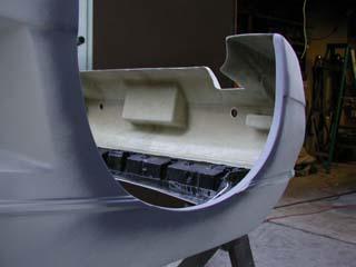

Although it feels like I worked plenty hard enough, I didn't seem to make much headway today. I am, however, pretty happy with the results of the fiberglass work on the wheelwells. After the aluminum strips came off, It didn't take too much body work to smooth out the minor irregularities and fill a few small voids. It does, however, make me appreciate just how good the fiberglass work is that Tedd (Sage) did on this body kit. I've yet to find a void in his layup bigger than a pin head or two. Pretty amazing IMHO.

I did get the finish body work on the rear clip pretty much done however..... seams molded in etc.. I also managed to get the hood vents cut in and in primer, and I've opened up the front wheel wells about an equal amout as I did to the rears. The fronts don't have the flanges in yet as I forgot to order more resin last week, and I refuse to use the stuff you can buy at Wally world etc.. "If it's worth doing.... it's worth doing right".
The car will get lowered, as well as receiving fatter rubber on wide rims, but with some imagination it's getting easier to see what it's becoming now.
