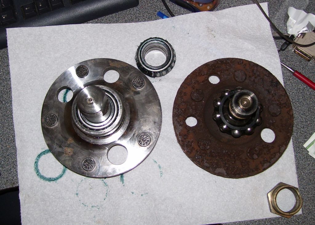

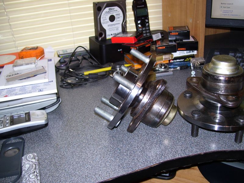

dskebo
NOV 09, 01:55 PM
| quote | Originally posted by bubbajoexxx:
hubs are ready to install here are the pics
Hey bubbajoe can you tell me the timken part number for the bearings you used on the inside of the hub. I have searched this site for days and I can't find the number I see you used a ford seal but the pictures of the bearings I can not read. I just don't want to make ten trips to the store trying to get them right when I know you did. Your work is outstanding.
fieroguru
NOV 09, 03:22 PM
| quote | Originally posted by dskebo:
Hey bubbajoe can you tell me the timken part number for the bearings you used on the inside of the hub. I have searched this site for days and I can't find the number I see you used a ford seal but the pictures of the bearings I can not read. I just don't want to make ten trips to the store trying to get them right when I know you did. Your work is outstanding. |
Information was on page 60 (page 1 is a table of contents for every page).
| quote | Originally posted by Fiero2m8: After some more R&D we are going to mod Bearing #513009 instead due to its smaller size 2.79" vs. 88 spindle of 2.74"
Timken or FAG #513009 Cross Ref #7466902 7470539 7470540 Non-Drive (FWD) REAR w/Disc Brakes Non-ABS
Fits: 1979-1985 Buick Riviera 1979-1985 Cadillac Eldorado 1980-1985 Cadillac Seville 1979-1981 Oldsmobile Toronado 1982-1985 Oldsmobile Toronado
dskebo
NOV 09, 05:00 PM
Thanks for the reply but I think he used a different set of bearings than what came in the hub. If you look at the picture you will see a bunch of timken bearing and seal boxes. The hub part comes with the races machined into the carrier so even if he used the bearings that came with the hub he still would have to purchase the races to mate to the bearings right? also the one picture shows a bearing and race on it but I cannot read the part number. I do not think this was original to 513009 hub.

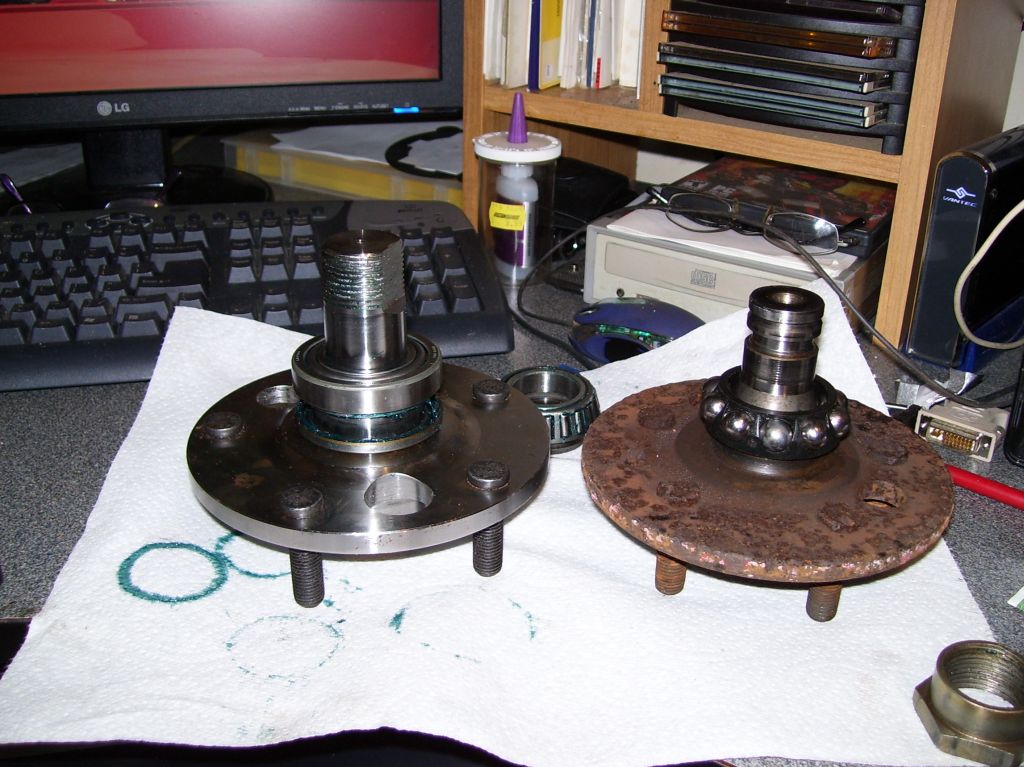

dskebo
NOV 15, 02:05 AM
no more plastic caged ball bearings full tapered roller bearings and races when i disassembled the stock fiero units they came with plastic cage ball bearings and the cages showed signs of melting from lack of grease this new setup eliminates the plastic parts and give true roller bearings and a 1 1/8 stub shaft and 5X4 3/4 bolt circle
a couple of pics showing the shaft size change and new bearing
as seen in the pics the bearing is now a presision roller bearing insted of a cheep plastic low quality ball bearing
Does anyone know the part number on them bearng he has on the hub . I CANNOT GET ANYONE TO TELL ME ? Is it a BIG secret or am I suposed to know already. Did I miss somthing in some other thread ? Help Im confused.
