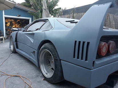

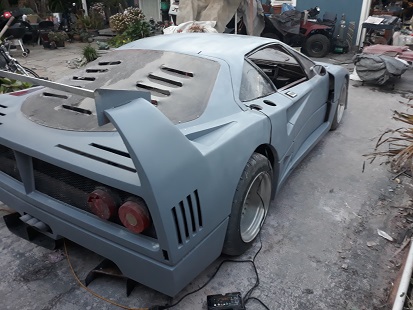

Thanks norm but your window wont fit my car, I also cut 4" out of the back of the car to shorten it. I also extended the rear of the roof about 7-8". My windows quite a bit smaller now. Im happy w the window I made, I need to clean up the corners but thats it. Those wheels will fetch a pretty penny.
Got tons o body work done and a second coat of primer. Looks good from far but far from good. To me at least. I didnt start sanding this coat yet so I can see the sheen. Even w all the longblocking I can see the sheen line isnt straight moving my head meaning itll look like crap if I paint it cuz I dunno what im doing. So Im still looking for a body guy and may hit up some shops for bids.
 Do need to get it to the smog shop so I bolted down the rear grill and need to find the tail light harness I made, installed the side mirrors and gas door. Cleaned all the garbage from inside, bolted the gauge cluster back down.
 Real thing has plastic windows so im going to just make em outta 1/8", gotta compromise. Should have those in soon if the rain lets up. Looking forward to driving it, not looking forward to the cloud of bondo n fiberglass dust thatll be swirling around in the cabin. Ill hafta keep the windows down.
 Pretty damn sick of fb and sanding, looking forward to working on other stuff. Next in line is windows, seals, interior Walked into one of the spoilers vertical pieces, right in the ribs. Fu@k that hurt and still hurts days later lol

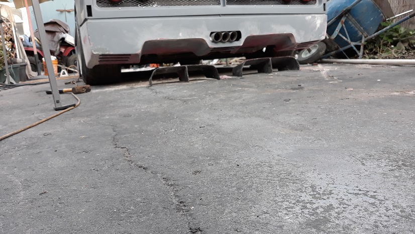

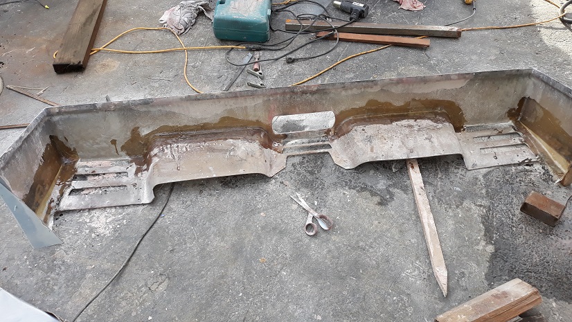

Thanks you guys! Details schmetails! they are being vanquished little by little, but I still find a few things to do. One piece of the car I never cut much into was the rear lower piece. Its a lil small n the devils been bugging me for that for ages now so I cut into it. Heres the inside boogered up w 2 layers o mat n 1 layer clof
Looks much meaner now. Almost done with it.

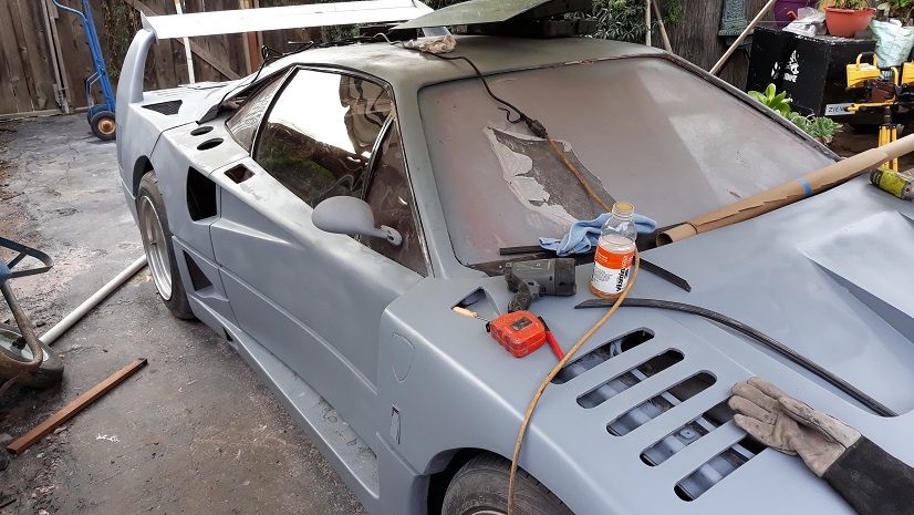

 Taped off the bottom of the door handles w hvac tape(works awesome) and wedged a bunch of mat underneath to make a mounting area for the handles to bolt to. Also made door handle rods outta some drip irrigation stakes.
If you get really low you can see the vents

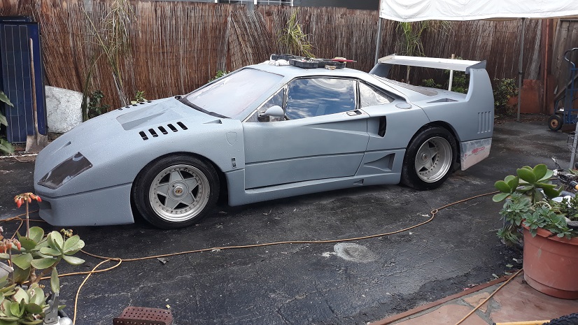

Oh yeah made me some winduhs. Had to move the front window pillar forward to be pretty much parallel w the rear. Looks ok but hadta compromise. Pulled the window frames out and cleaned up the insides and boogered holes shut.Was like john wayne w the dual wield heat guns melting the windows to shape. Heres the pass side w window felt. N yes they move up and down with minimal resistance!
 I can think of 2 tiny areas that need fb to make the groove smaller, but thats pretty much it for the fb

I go back to page 1 often and look at the first few pics. What a stupid looking car lol what was I thinking buying that. I kinda had to start doing what im doing to it as I got the stones to. I cut up every pice of fiberglass on this car n cut the fiero roof completely off! WTF?! Yeah pretty proud of the car the car but more so the skills n tools Ive picked up along the way. Had some good tips n lotsa cool comments along the way! Kinda tired o working on it tho, wanna wrap this sh!t up lol. Got the drivers window bent up and almost finished. Hooked it up to the fiero window motor but its so flimsy that it doesnt want to slide down equally and the window motors not strong enuf to move it. I have an 1/8 thick piece o steel screwed to the bottom of the window to keep it straight. The windows will work till I get the 1/4 window bending down. The window shape is what it is so I can start on the seals and some final welding.
 Once the interior is sealed good, I can install the interior. Looking forward to that day
The back end doesnt look bad in person but when i put the camera lens to it it looks like sh!t. I went through some pics I made ages ago and found this
 Looks like I still have about 1/3 left o fb can #14, gonna go for it when time and weather allow, straighten the bottom and cut the inner areas sharper The back now looks like a regular f40 rear, n wah wah I want the LM rear!
