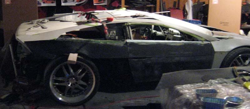

Very rough mock up with matt board...

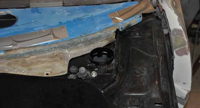

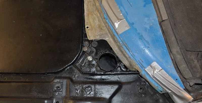

I took some pics of my cowl air vents I was telling you about. I can't seem to get my photobucket nor PIP to work tonight so I posted over on the West Coast Fieros site for you.
This should let in some additional air into my cowl area since the extended screen covers all the other inlets now. Not as large an opening as oem but between these vents and the drains that are no longer needed given no water gets into the cowl area now, I should get a decent amount of air into the heater box. Time will tell.

I moved your pics of cowl air vents here to share (thank you) it looks like I'll have enough room as well.

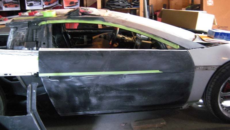

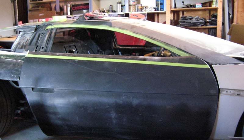

I'm using old RBS doors that had reverse chop about 1-1/2" to 2-1/2", this what it looks on RBS2...
Hacked away right down to front and about 1-1/2" at rear...

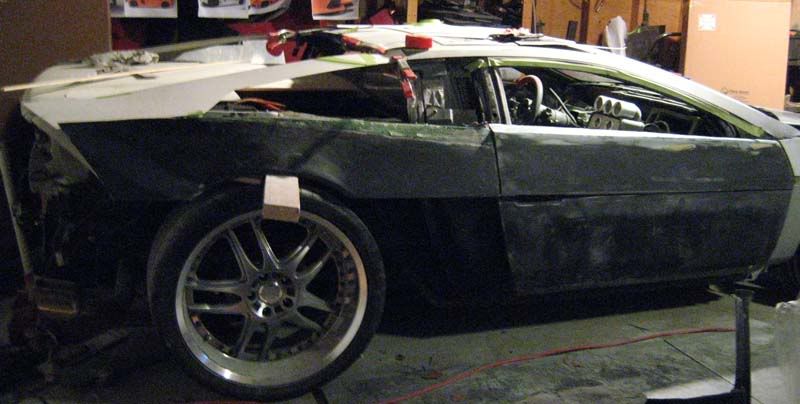

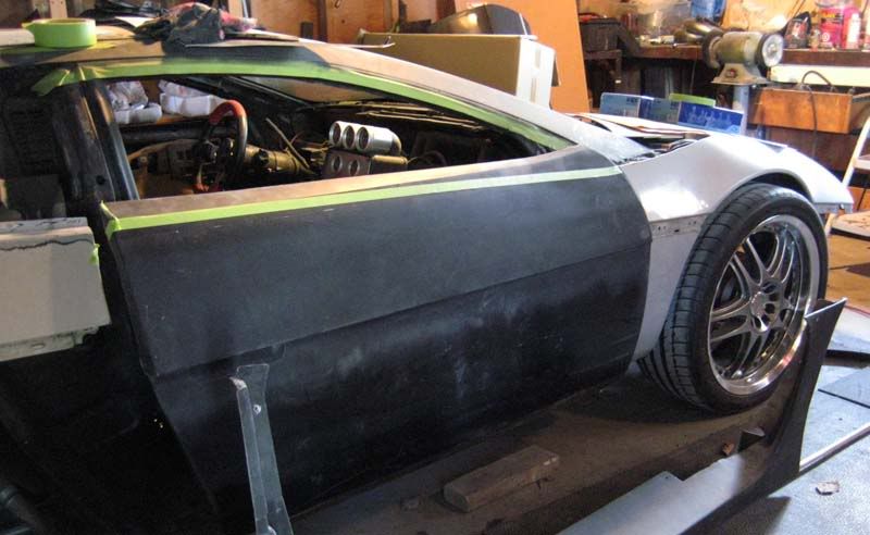

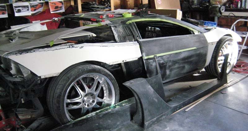

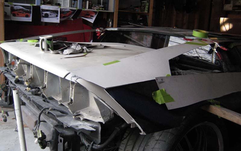

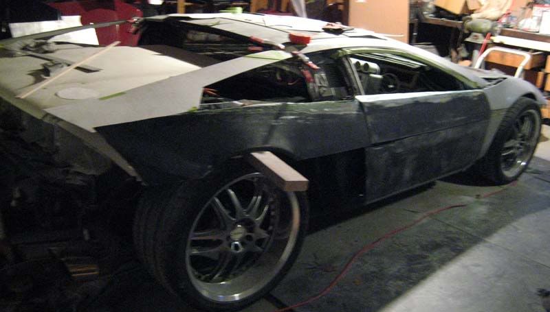

Today's scoop...
Fiberglass top edge door skins and mockup rear widebody ( next install widebody )
Few more views of rear end...
