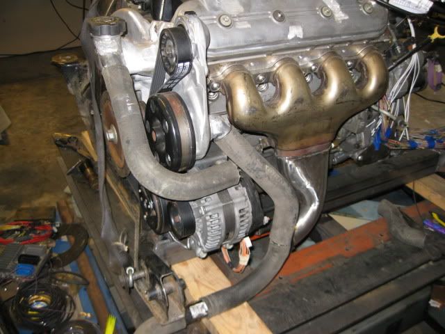

fieroguru JUN 24, 05:16 PM
Started mocking up the coolant hoses and took a trip to Autozone and found a good candidate for the water pump inlet. The thermostat exit is a simple 90 and then it will go into a steel tube to cross over to the driver side coolant tube. I will need to replace the passenger tube - I need to cut it back about 6" and the one that is on there is unbent (so I do not want to cut it). I will grab one of the spares that is bent slightly and use it.

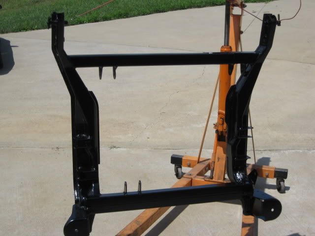

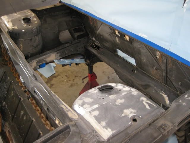

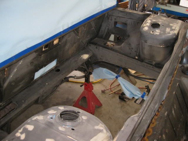

I have a customer's fiero coming here on Sunday for a SBC/Getrag swap, so I needed to prep the LS4/F40 swap and my 88 chassis for storage... so I have been busy getting everything ready to paint.

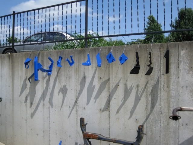

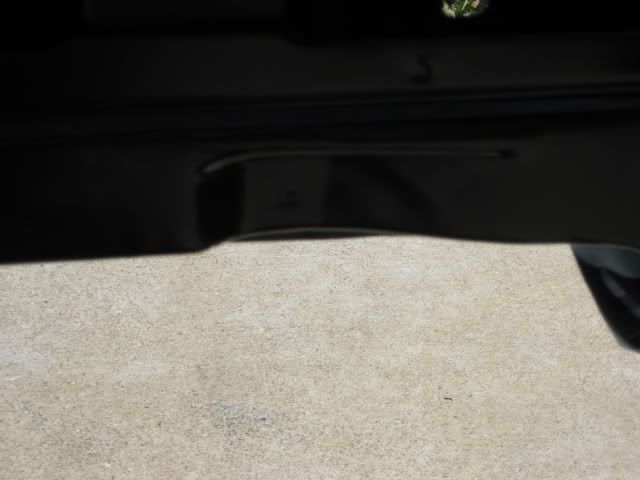

In the morning the blue and black paint will be spraying...

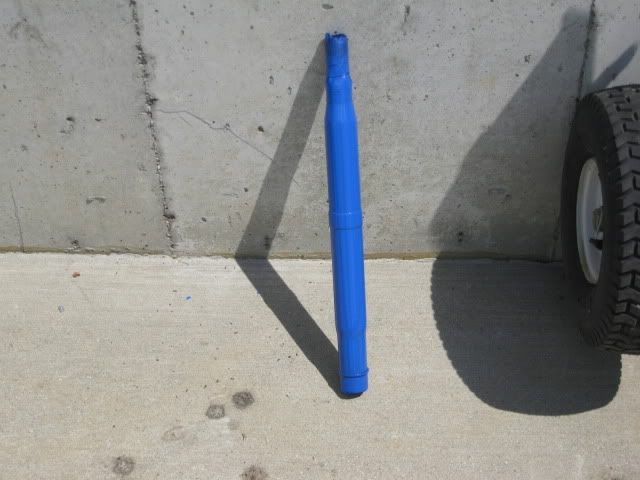

fieroguru JUN 25, 05:59 PM
Got some painting done today:

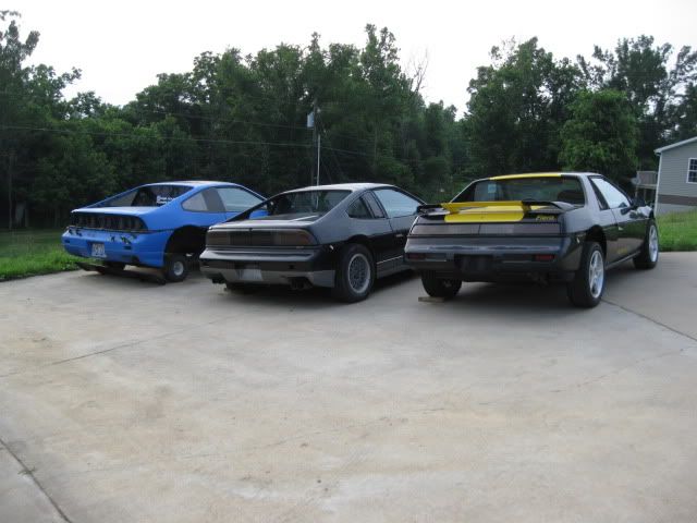

fieroguru JUN 26, 09:15 PM
This project is temporarily on hold while I work on a customer's car.
The Blue 88 is back in the line up:

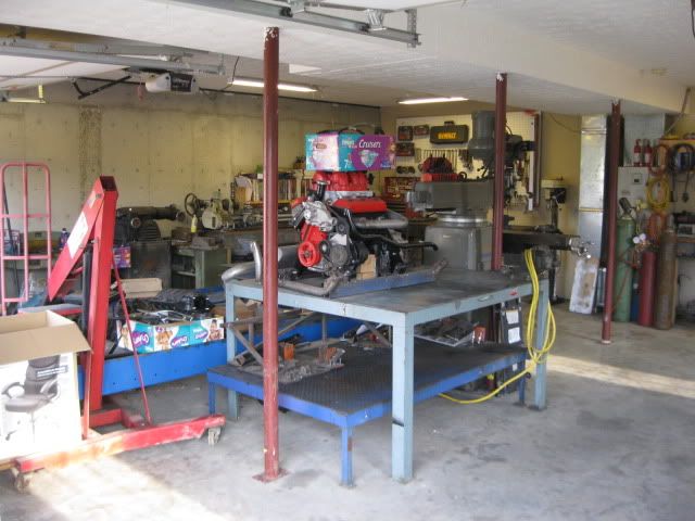

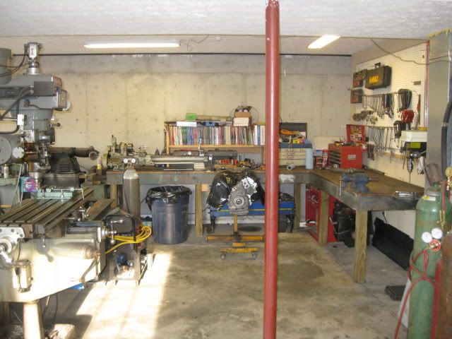

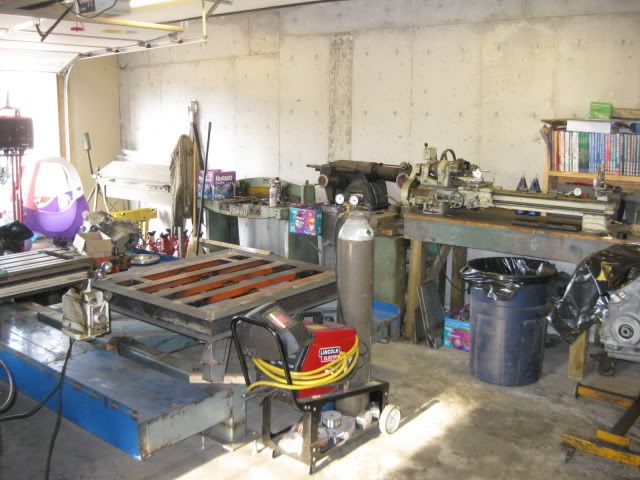

The garage is also the cleanest it has been in quite some time (still a little cluttered... but what do you expect with all my tools in a 2 car garage).

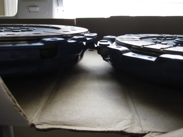

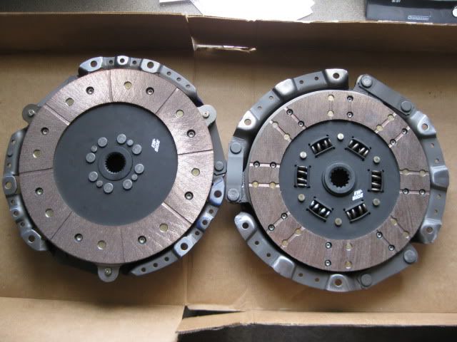

While this project is on hold until I finish up a 383 SBC/Getrag swap for a PFF member, I did have an opportunity to compare a Fiero 2.8 Spec Stage 3+ clutch (9 1/8") to the 4.0 Ford Ranger Spec Stage 4+ clutch (10") that I am using for my LS4/F40 swap.
The 4.0L Ranger Spec Stage 4+ clutch is on the left and the Fiero 2.8 Spec Stage 3+ is on the right:
As you can see the 10" version I am using has a thicker pressure plate and the friction material is not only larger in overall diameter, it is also wider. Running the numbers, the 10" clutch has 25% more friction area and the centerline of the friction material is 1/2" larger in diameter. Both of these factors should help with drivability which is what I was going after.
From a weight standpoint:
Fiero 2.8 Spec Stage 3+ clutch/pressure plate: 15 lbs 5oz
4.0L Ranger Spec Stage 4+ clutch/pressure plate: 16 lbs 5 oz
