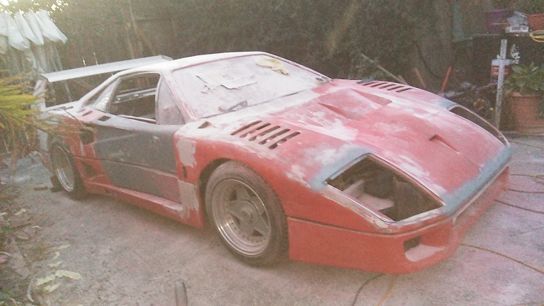

Yesterday I got the trunk lid hinges installed and mounted the trunk lid. Its beefy and opens
but still hits the roof a tiny bit. Got some more shaving to do, it has to do w the round od the
roof. Gotta be perfectly rounded or the trunk will hit the roof. Im trying to keep the gap at 1/4"
Opened up the headlights at the top to give it more of a mean look but it still lokks like its sad. Filled in the scoop edges w
some fb to make em rounded. Got the top edge of the hood to be symmetrical! yay
its starting to look like a car folks

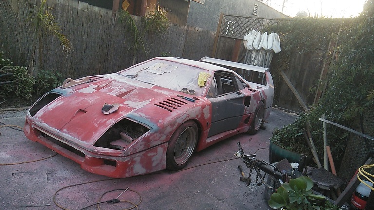

Imsa gt u da meng meng! Lights came out great, played around w the size this mornin. Came up w this
went for it
came out killer! The hood killed it for me, this makes it better. The roofline and the center hood
area are too wide still but itll hafta do shemdogg tired

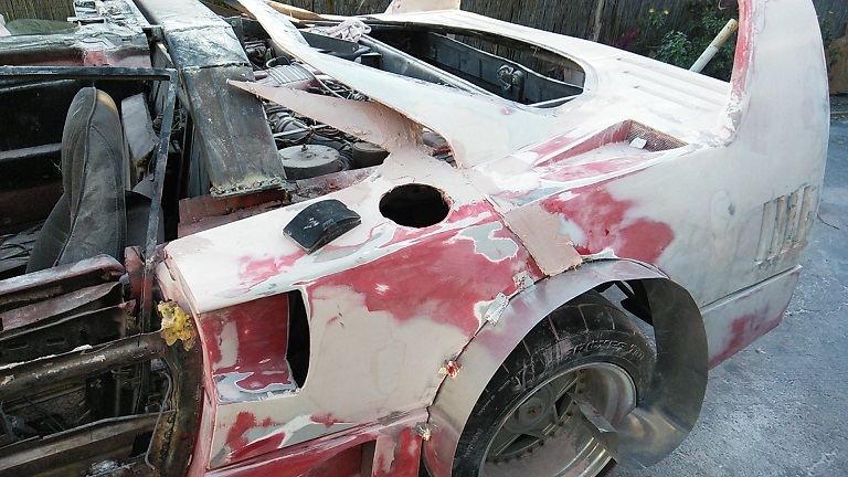

Fb'd the rear quater windows n filled em, fb'd n filled the area where the trunk meets the quarter, sanded the hell
outta the roof n filled the low spots, added some fb reiforcement to the center scoop, fb'd the PS front wheelwell
lip, sanded/filled the rear quarters n sills, sanded/filled the middle groovy groove, and lots more. slowly running
outta fb areas to patch. Crazy all the lines line up and everythings symmetrical. Being anal has its privileges

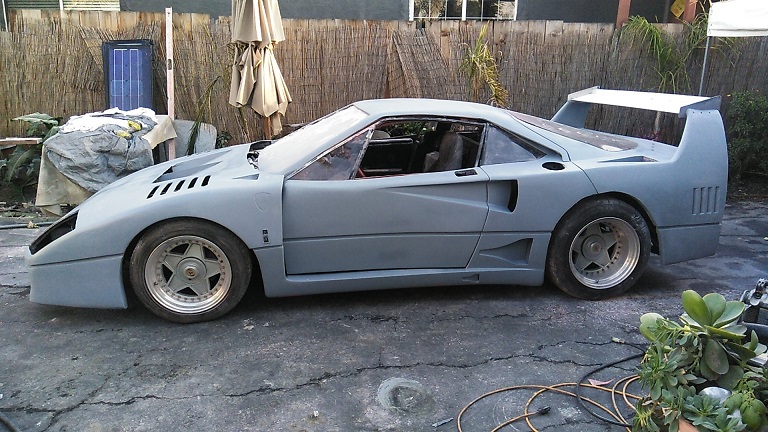

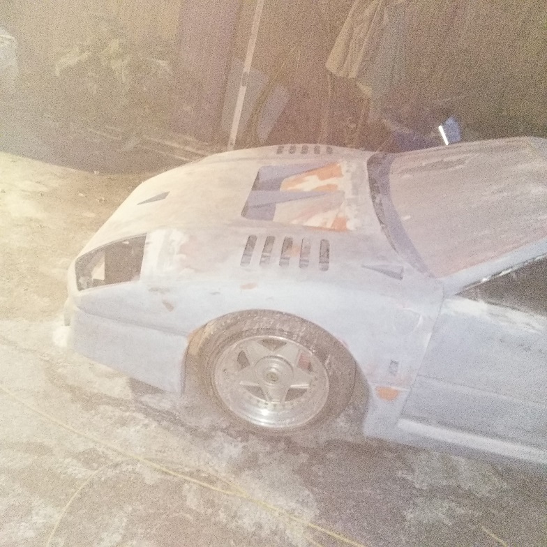

shemdogg JAN 03, 09:53 PM
Running outta parts to fb! Did the rear quarter lips
Had to put the pedal to the metal, rains a comin. Did a lil work on the front center scoop and a few more

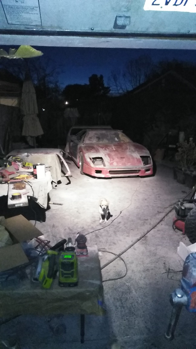

oddities n said fu@k it time to shoot. 32 degrees this morning, ice on the car, paint shop guy said its too cold.
Directions said 2-3 hours dry time at 70 degrees, it dried in 30 mins!
Made it happen. Blew off the dust and wiped off the car as best I could in a hurry. Fu@kin drain valve on the
compressor went and I didnt have an oring that small so I taped it up n started shooting. Damn thing ran the
whole time. For a lil 6 gal nail gun compressor that thing did alrite! Not bad for my first time, a few small drips.
Damn it looks so good in one color. Pretty pleased w this hi-build primer, It was in 80 grit stage when I shot it.
Filled mostly everything. Lots of bondo n fb holes to fill. Comfortable w painting the car at home now. Need a
better dryer for the compressor, had a drop of water come out the gun regulator a few times. Id say this experiment
was a complete success. Another milestone passed shemdawg happy dawg

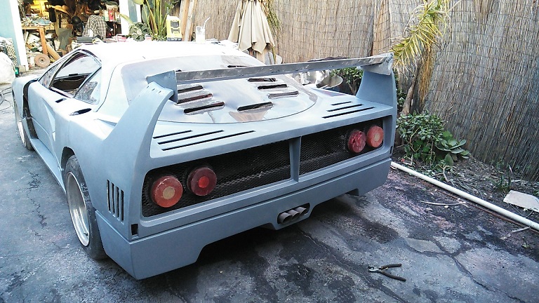

shemdogg JAN 09, 05:15 PM
Yes white does look good, Im thinking silver tho
Ive never seen that version of the car, theres 3 versions of the car. Seems they have a mix of parts depending on the year.
Ive got the side vents a bit short, lengthening mine next. Gots lots of spot filler on it and smoothed out, almost ready for the
2nd coat o primer
Nothing but rain over here all week, gonna be awhile before I can get back to it
