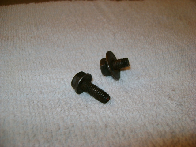

Ran across this bolt while cleaning and I am not sure there is a specific hole for this shorter one of the two.
Doesn't look like an original bolt to me. They should all be the same. I've got extras if you need some.
