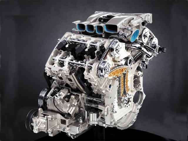

This is for Austrian Import.....This swap is in our R&D section of our shop right now....will it make it into a Fiero??? Maybe.
 [This message has been edited by bmwguru (edited 07-16-2008).]
THE BEAST
JUL 16, 11:28 AM
Its that an 8 cyl engine or am I seeing double today??
JG
Fastback 86
JUL 16, 12:50 PM
bmwguru
JUL 16, 01:15 PM
| quote | Originally posted by Fastback 86:
That's the W8 isn't it? |
yes it is. I have the opportunity to pick up the engine at a reasonable cost, but before I do, I'll be making sure that it will fit in the back of my other Fiero....maybe with a twin turbo setup. Anyway, I do one swap at a time, so I need to finish up the VR6 swap before I start building the Ultimate 8 cylinder swap. Dave[This message has been edited by bmwguru (edited 07-16-2008).]

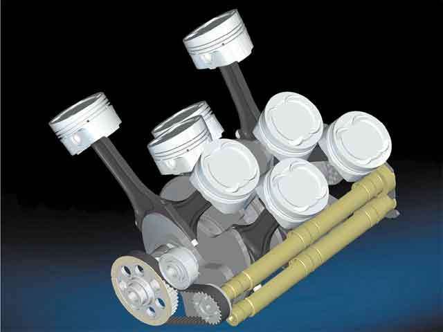

Erik
JUL 16, 04:31 PM
| quote | Originally posted by bmwguru:
what is the double shafts on the lower right..counter balance?
bmwguru
JUL 16, 06:26 PM
| quote | Originally posted by Vonov:
Guru, check out the VW Vortex forum if you need info on how to get a tach signal...don't recall whether you decided to use the VW cluster or not? But then, I'm probably trying to teach my granny to suck eggs, lol...(the reason I mention it, is my local VW guru, whose talents I respect immensely, was scratching his head for six months over getting my tach to work with my VR6 in my MkII (four cylinder) cluster; I found the solution in the Vortex forum in five minutes of searching; it involves taking signal from two of the connectors on top of the VR6 coilpack through 1K ohm resistors, and then joining the two leads to connect to the tach signal input---it's accurate up to 5,000 rpm, after that the tach sort of goes a little goofy, but at least it works now...we're still trying to figure out what's happening in the upper range) |
Thanks for the info. I'll probably use VDO aftermarket gauges though. I left all the wiring for the factory cluster in the connectors, but the Jetta cluster is too plain to wind up in a Fiero. I'm a member of Vortex, but not that active there. It is really easy to get lost there. If you search VR6 Fiero in that forum, my car is mentioned a few times by their members that have come to my shop and happened to see it. . . As for the picture, that is the balance shafts for the W8. The swap is still being kicked around. I come across a lot of German engines that other shops are looking to get rid of for a good price, so that is just one of the ideas kicking around in my head. We were also kicking around the idea of a Quattro Fiero, but I'm not a huge fan of the Quattros...and that would require a lot of custom fabrication. One of the other swaps we are planning isn't engine related. I have a cool power steering idea that will be unique and may actually be marketable as a kit in a bolt on in a few hours. I just need 32 hours in a day and I think my body might catch up to my mind. Dave
