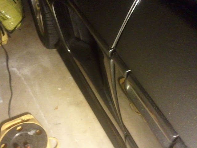

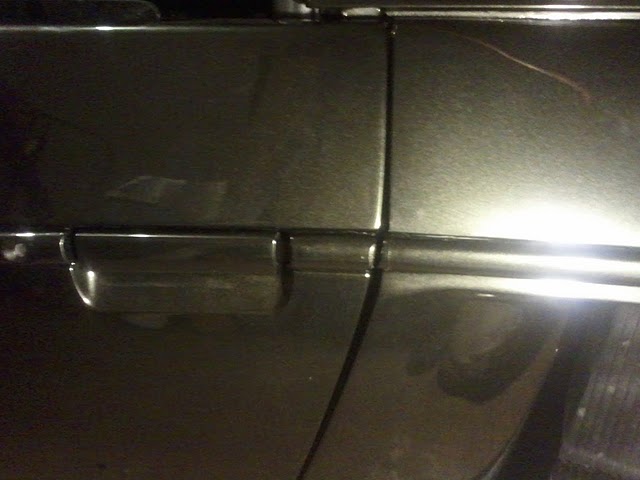

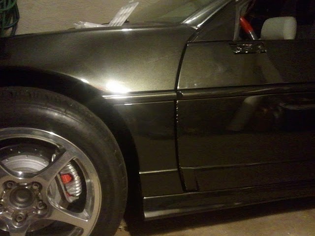

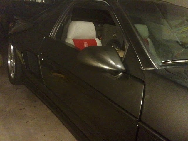

Door panel alignment finalized so mirrors could be installed.
I used door gaps and molding as guidelines.
I also brought the panels flush to the rear quarters with shims.
The pictures below should do the talking:
Before
After

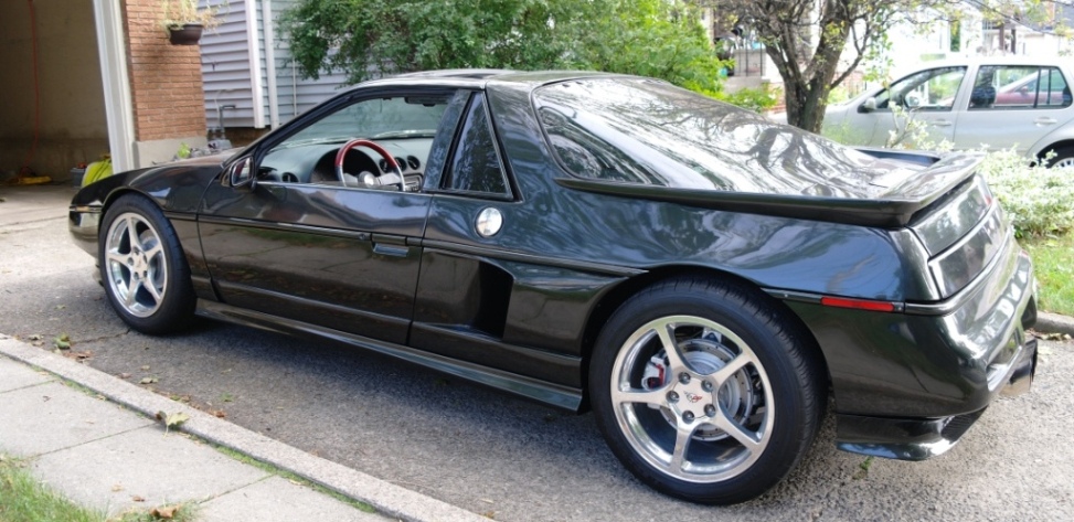

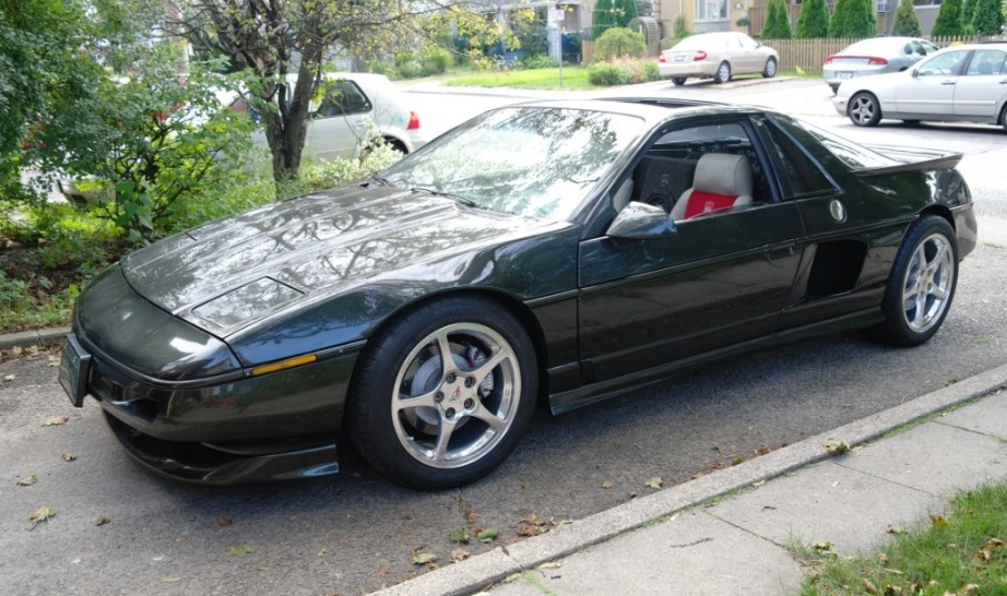

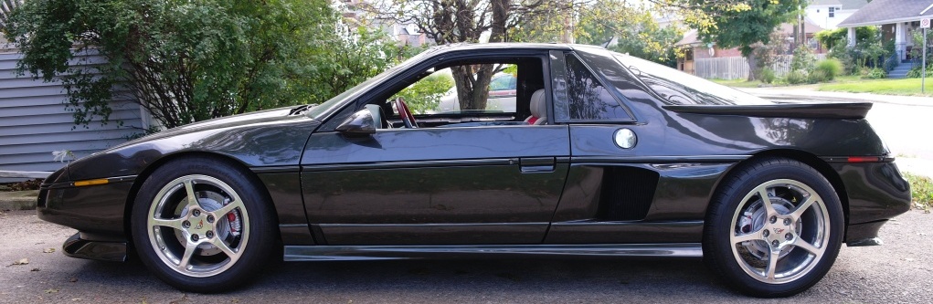

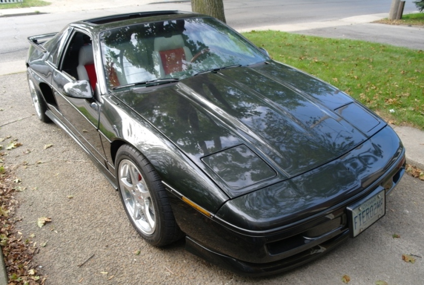

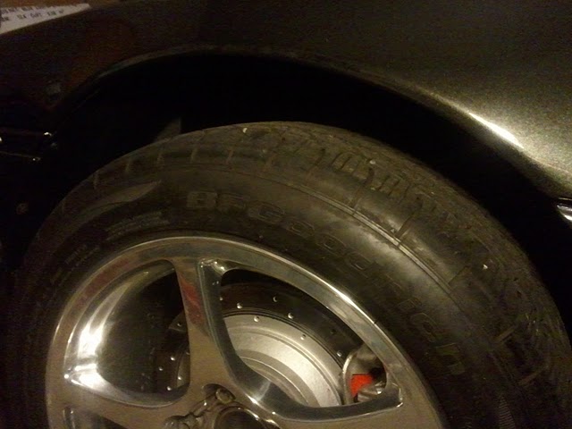

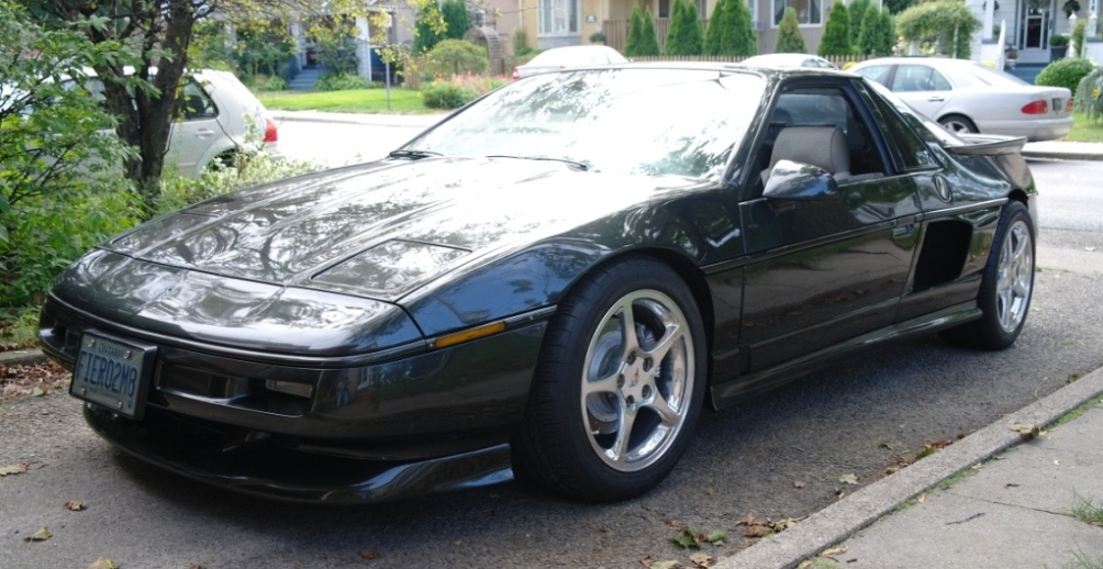

Next I lowered the front ride height:
Stock
Spring swap

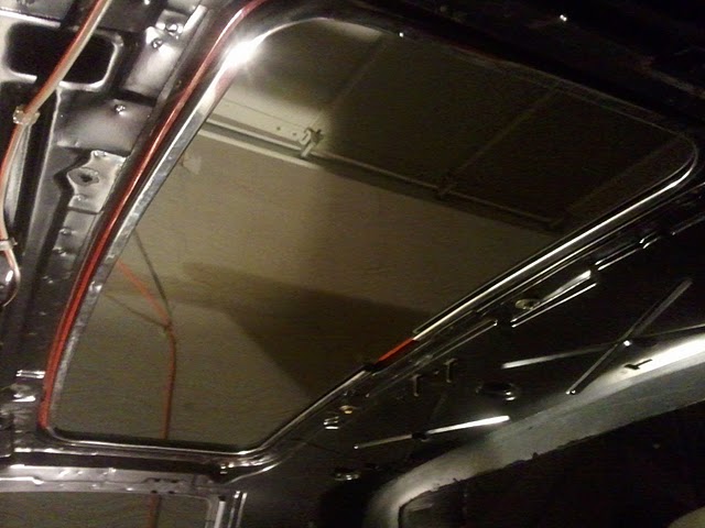

Mounted roof panel first:

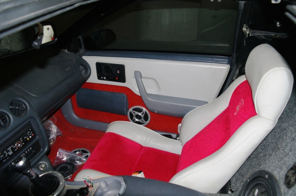

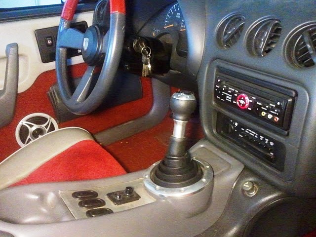

Installed the interior door panel, hardware, dew wipes, mirrors and speaker:
Driver's side is next.

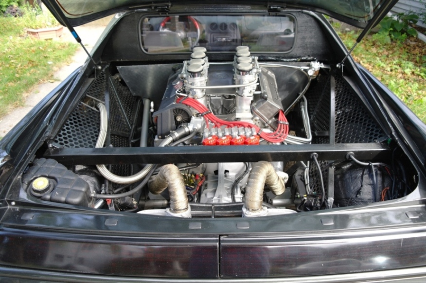

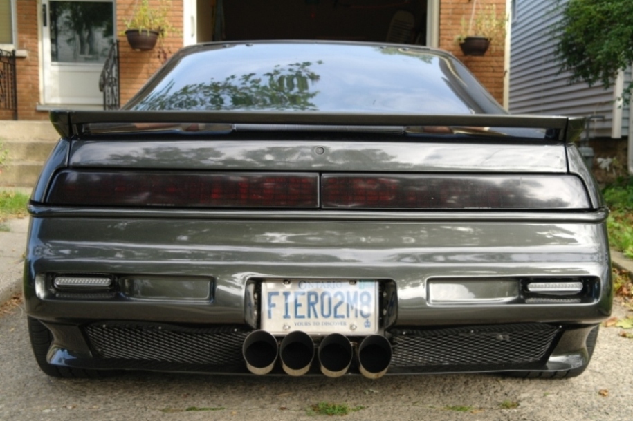

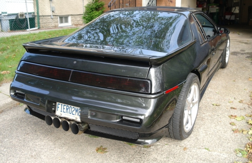

As requested...
doublec4 SEP 18, 11:22 PM
Definitely even better looking with the ride height adjusted.
Almost strange to see it all back together. Hope I get to see it in person in the near future!
1988holleyformula SEP 19, 12:59 AM
Looks amazing! I've always been a fan of those style Corvette wheels, very nice mod.

Fiero2m8 SEP 23, 08:16 PM
Yes the C6 wheels are so much more common these days but I really like the non-painted C5 five spoke.
Driver's side door panel reassembled - I still need to order some new inner dew wipes:

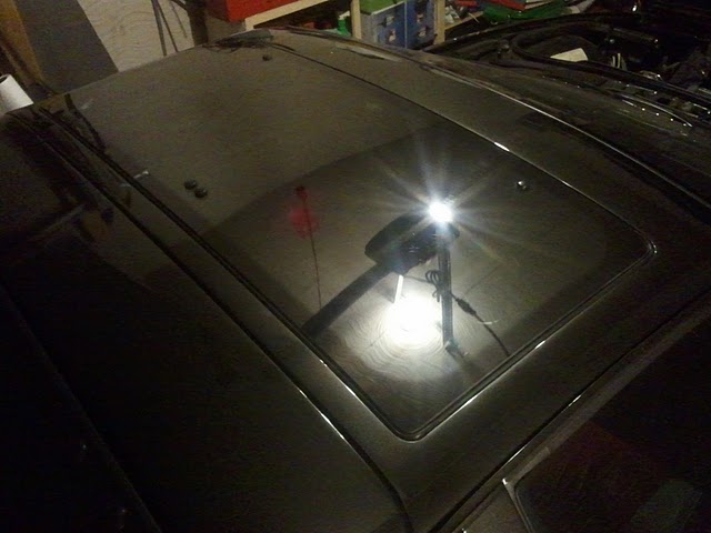

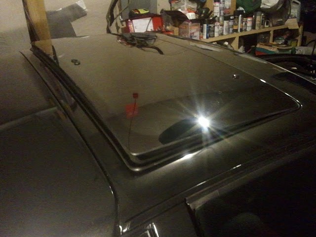

Sunroof panel didn't have 1/4" holes so I drilled them and finished seal install:
Sunroof glass hardware reinstalled:

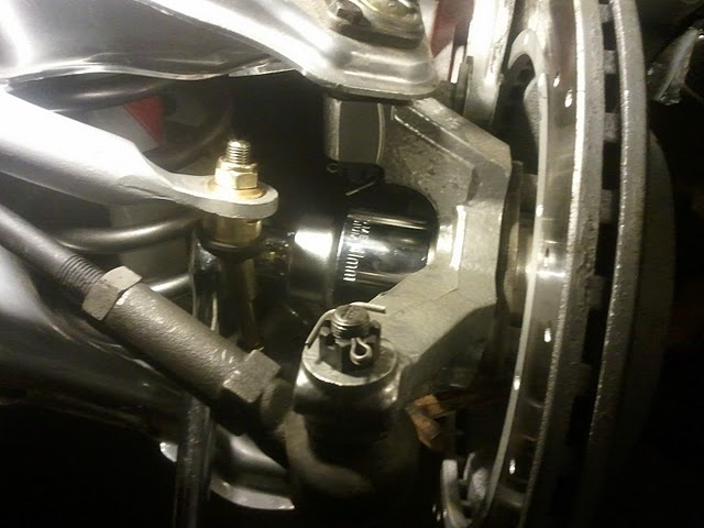

Hub bearing nuts were also retorqued now that new roller bearings have seated:
Also adjusted front end alignment so it's in the ballpark now.

Without scrolling back here's some before pics from the 25th anniversary show. What a difference!

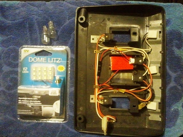

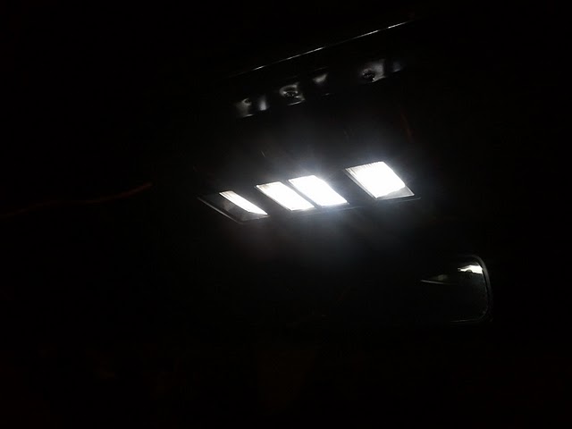

I decided to swap interior lighting over to LED:
Here they are installed:

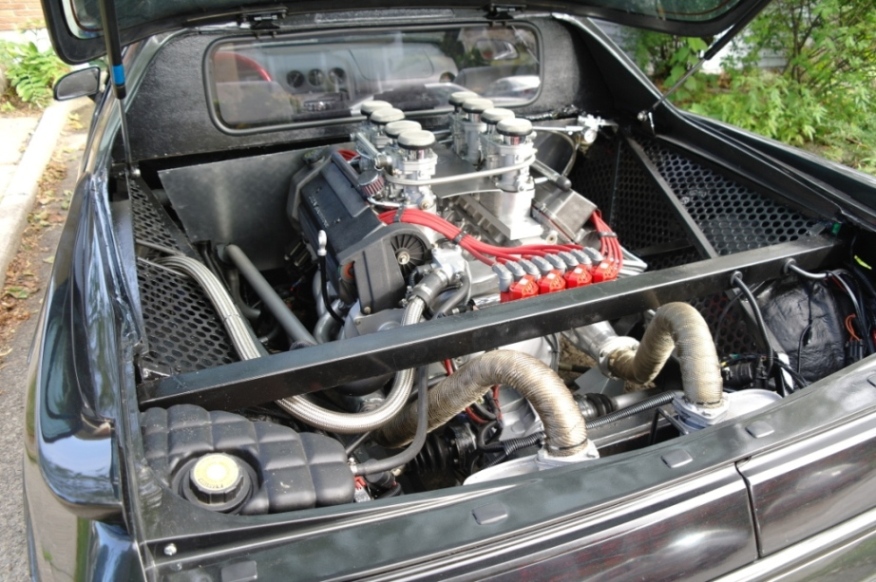

Unfortunately I never made it to the cruise Sunday as had an overheating issue on the way there in Beamsville
