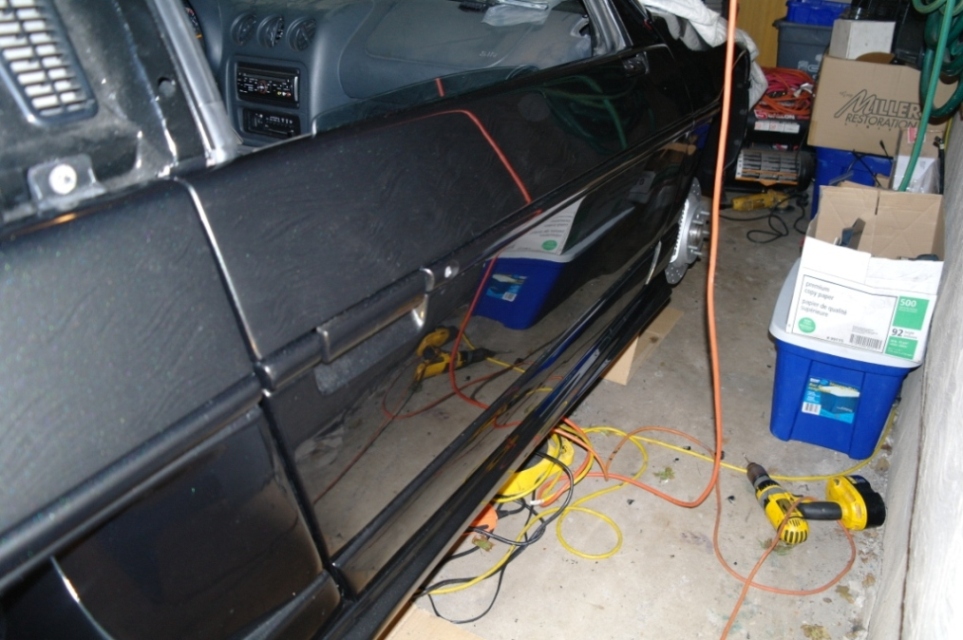

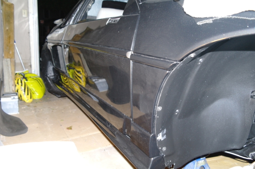

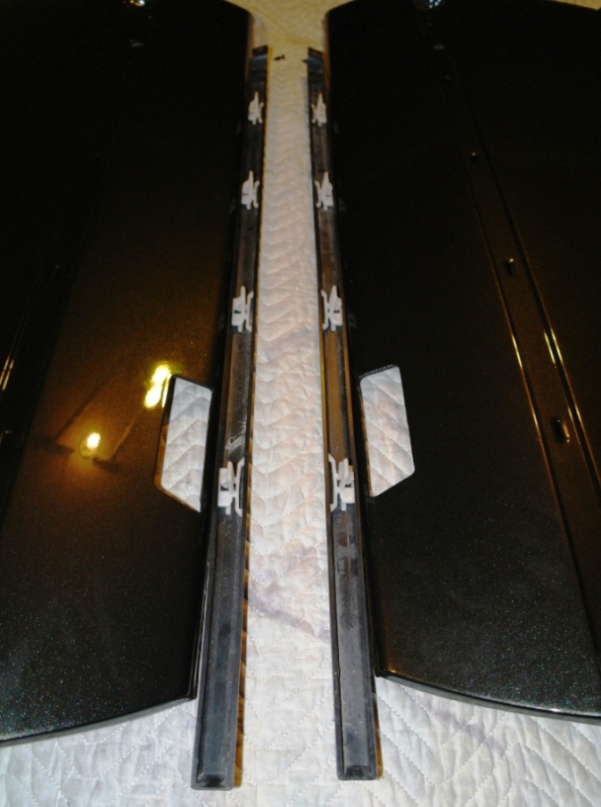

Been busy this long weekend but started prepping doors and mounted these filler panels...
Also picked up my custom door handles and 1/4 windows from the paint shop.

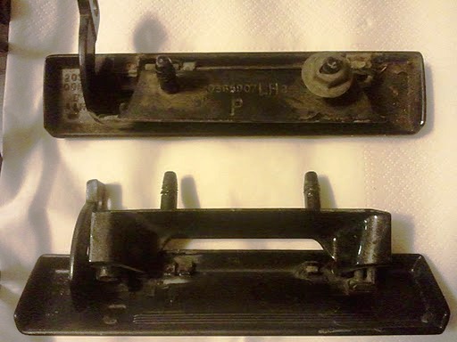

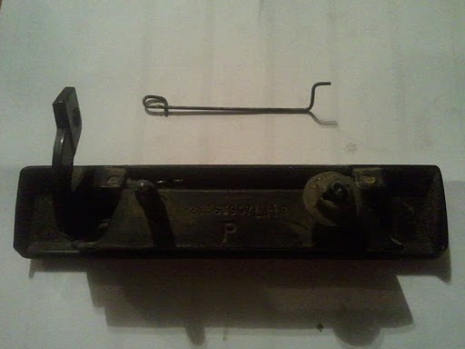

Did some work on the door handles so I can reassemble the outer door panels.

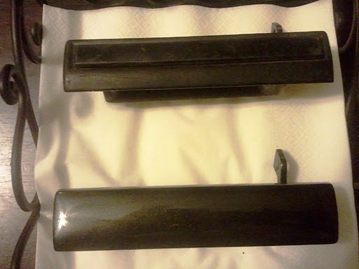

Here's the custom shaped handle back from paint to better match the smooth molding.
This is a mod I'd recommend to others with 87-88 Fieros.
I removed the ribbed piece stuck on with adhesive and filled into the shape I wanted.

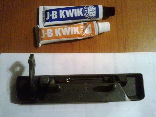

Only problem was the LH handle had a broken spring and retaining clip.
So I dug into my parts stash to harvest another LH spring.
Hopefully the JB Weld will solve the problem - will update on that once it cures...

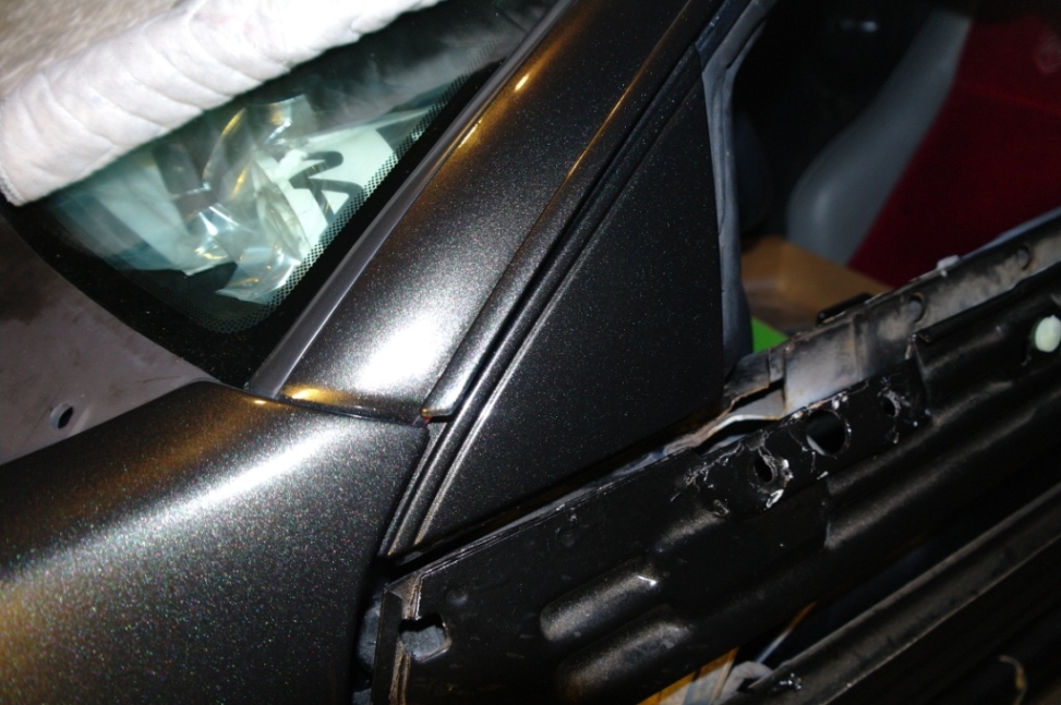

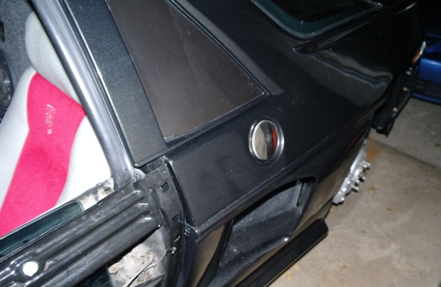

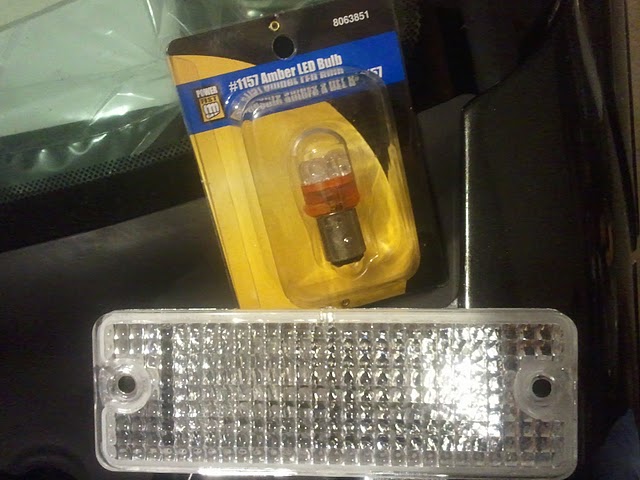

LED indicators and clear marker lens installed:

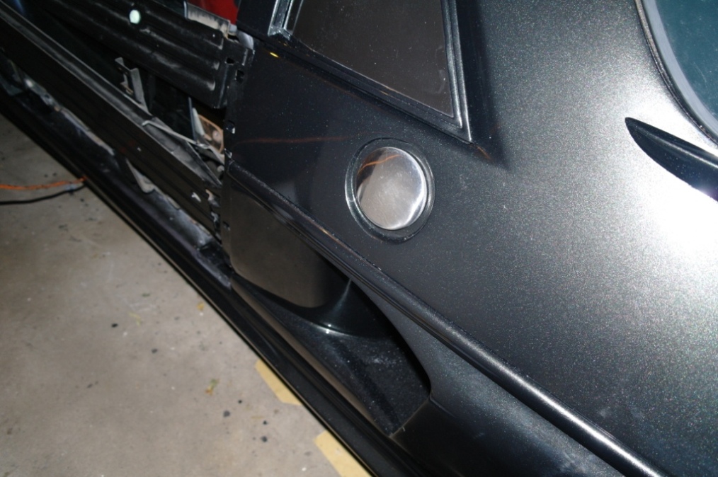

Also installed the gas filler neck:
Some of you will remember that I had a stock gas door painted as well but that's going on the future mods list for now.
Got a good idea from Bubbajoe on building an all aluminum louvered grill which is also on the list.
1/4 windows are on too:

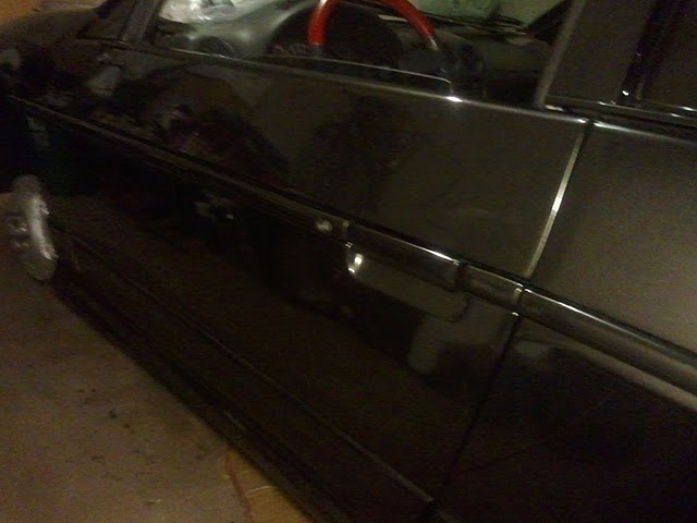

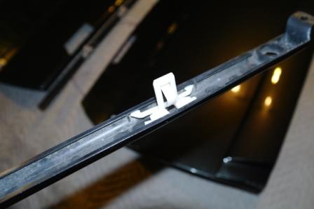

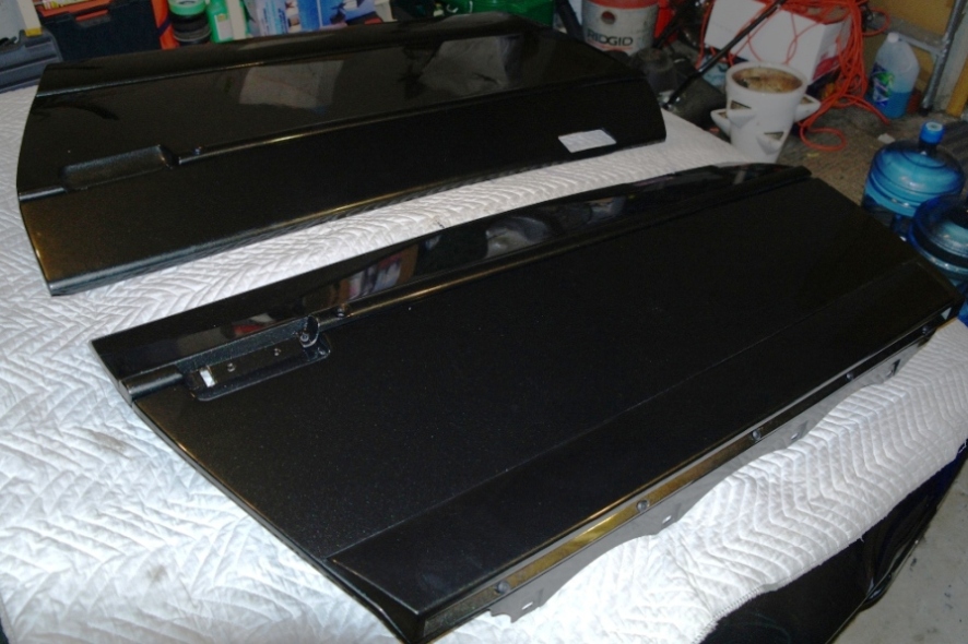

I bought a plastic rivet tool and mounted the aero trim on the doors:
Next was new hardware for the belt molding:
Door handles and lock cylinders were also preassembled:

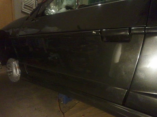

Passenger door installed but will need some final adjustment and shims later:
Don't worry, the lower rivet isn't in the fender yet which will move it up and out to where the door is...
Drivers door panel too - lining up the handle and lock linkage always easier the second time around
Whohoo all the body panels are back on
I'm pleased with how the custom shaped door handles better match the smooth molding - and yes the epoxy held just fine

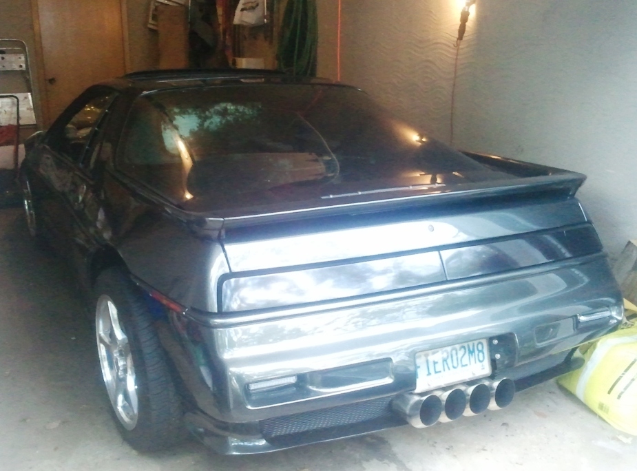

Fiero2m8 SEP 12, 10:53 PM
Yesterday I got enough done to get the project back on its own wheels.
1) installed horns that I had forgotten all about.
2) adjusted front fenders to align with door panels.
3) reinstalled wheels and lowered from jackstands.
Battery was dead so I put that on the deep cycle charger.
