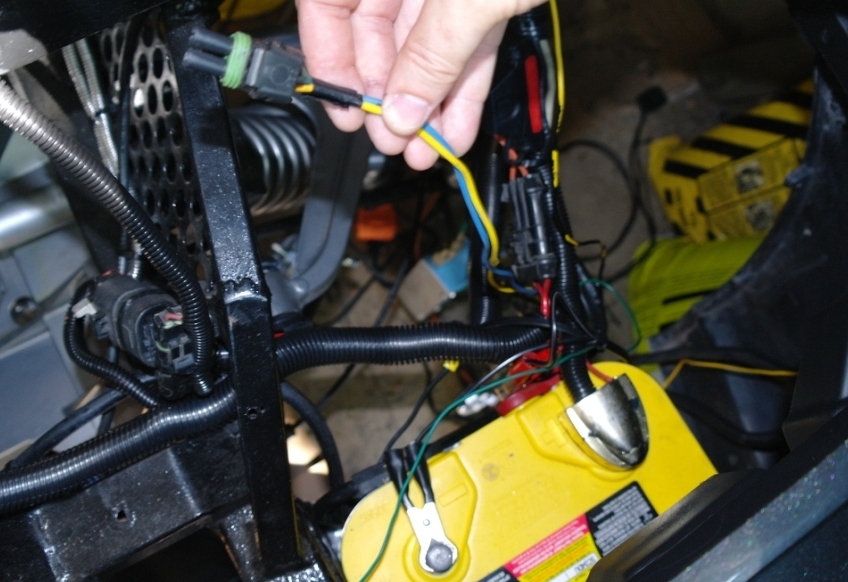

Good news is tailights look great. Bad news is they don't work. There is power at the bulb sockets with light switch on but I'm guessing no ground. The rear marker lights, license plate lighting and reverse lights all work. The sequential box is working as I can hear it clicking when the hazard lights are turned on. These tailights both plug into the box and also plug in to each other to split a power feed. The only other wire is a yellow wire which I connected back to where I had previously cut it. There is also a green feed wire from the harness I labelled "Parking Lights" which has 12V+ when switch turned on. Anyways I was getting frustrated since it worked fine when I removed it. However that was almost 2 years ago - my memory is good but short.
I can't remember how the lights get their ground, if anyone has ideas let me know.

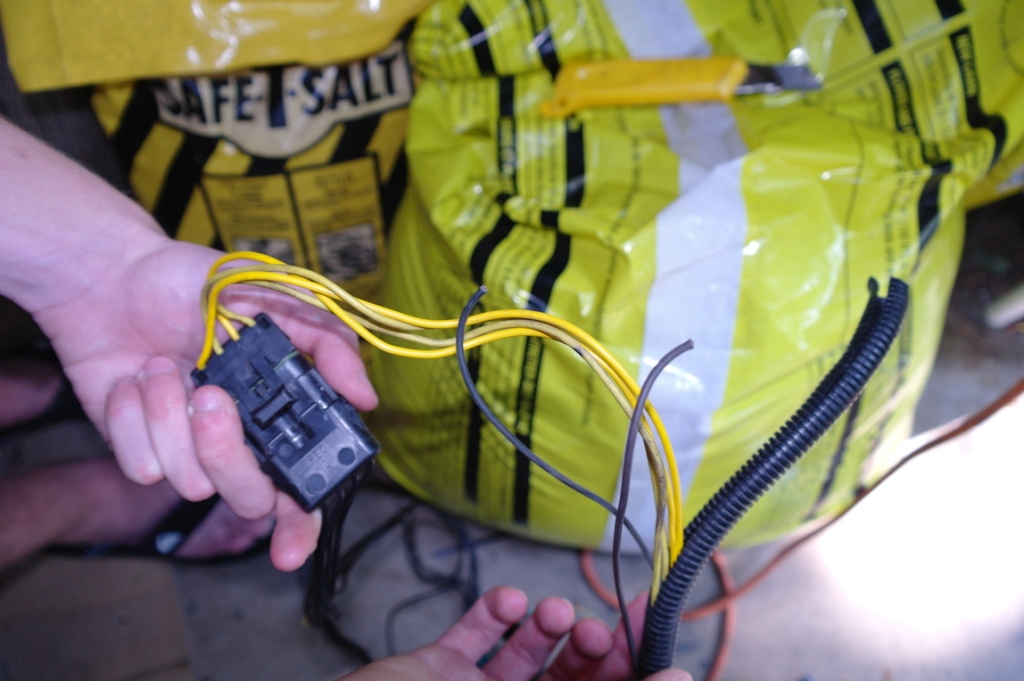

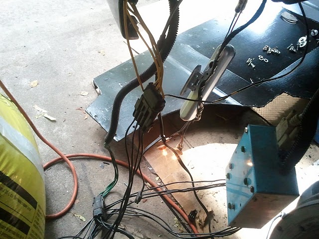

Look what I found in the wiring loom...it's usually something simple.
Now yellow to yellow brown to brown and black to black and parking lights work. Only new issue is one flasher doesn't work and it's an issue coming from the box (black wires from box and green to lights). The wire I marked with yellow tape is the feed wire with no intermittent +12V.

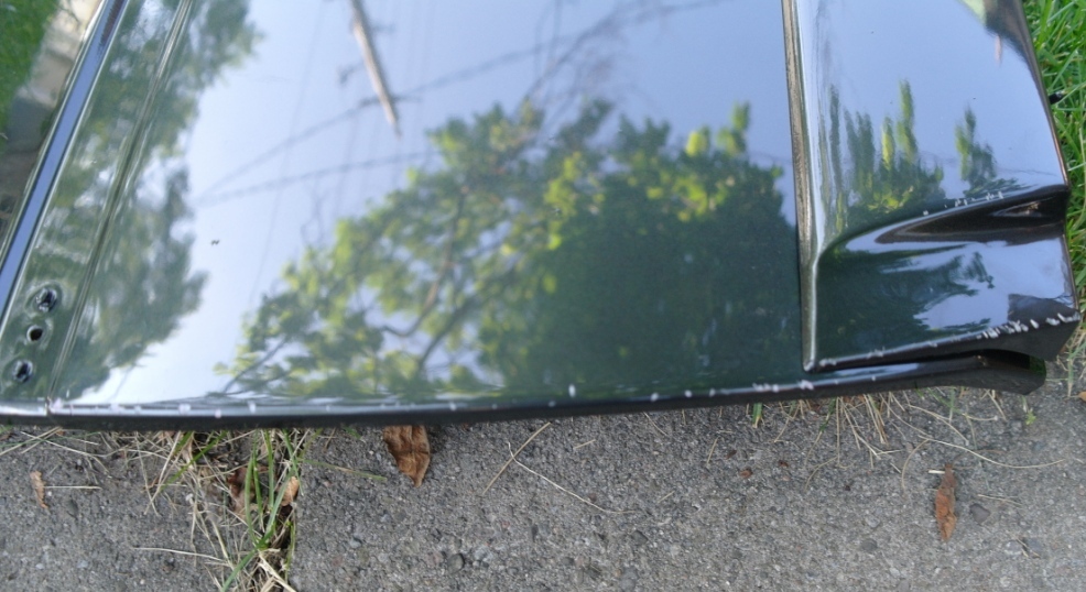

2nd paint casuality as door panel was dropped on the driveway (first one was a clear coat scratch on the front apron)
There are definitely some benefits painting the panels on the Fiero. Once it's all together it getting a visit to the painter to fix blemishes and buffing etc.

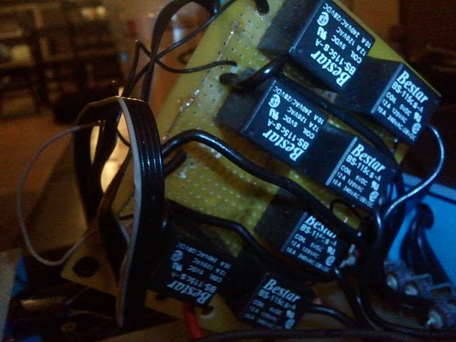

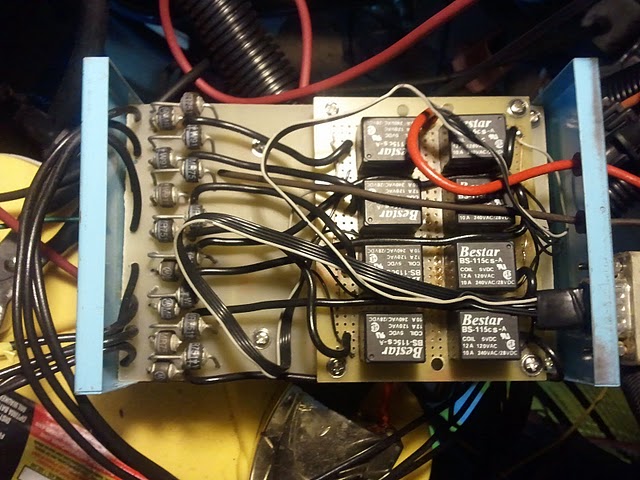

After opening and testing the sequential light box, I found the relay that failed as bypassing it caused the bulb to light continuously. Thanks to a tip from Bubbajoe, today I was able to buy spares of the exact relay for $4 each. Place is called A1 Electronics Surplus in Toronto. Here is a picture of what Bubbajoe built.
I will be swapping out the relay and soldering the new one in.

Relay removed and replaced with new one soldered in...

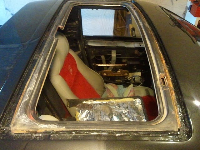

Today the roof panel was delivered  Looks good however this particular roof panel appears to need some attention to the sunroof tracks that I only noticed when the seal was removed.

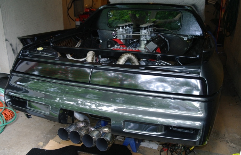

 LED markers are also painted, next we're doing the 1/4 windows. Working on installing rear apron, rear wheel wells and finishing rear lighting.

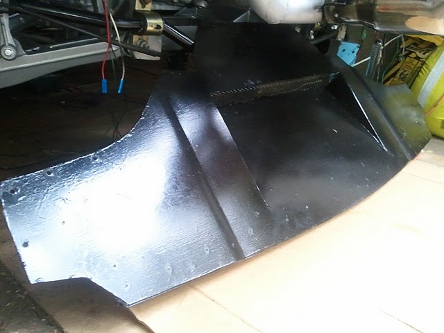

Rear air dam modified to accomodate Z06 rear swar bar:
