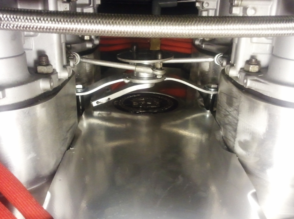

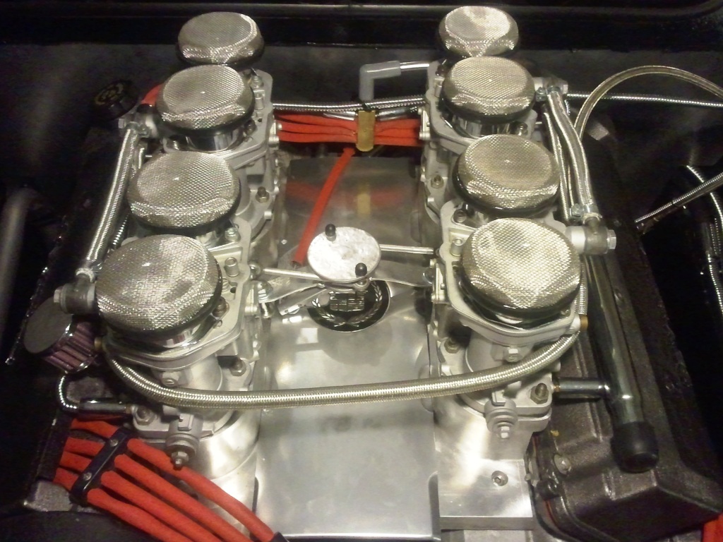

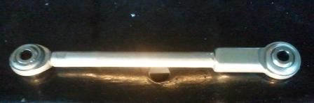

Completed new throttle linkage setup.
Started by rebuilding the broken linkage with new helm joint.
They came very stiff, so I little tap with the hammer and socket loosened them up to swivel freely:
Due to the valley cover, I needed to raise it, so I used new stainless bolts, washers and chrome tubing as spacers to get the clearance I needed.
To avoid linkage binding I reversed the mounting points from above to below to keep the joints horizontal:
Finished it off with rubber caps on top. The throttle stops snap back even when only one side is connected so I have good throttle response and consistent idle control:
Gokart Mozart JUN 08, 07:35 PM
spin the crest: put the caddy logo on top... nah
ezramore JUN 09, 02:37 PM
Can you box in the vally cover to go over the link

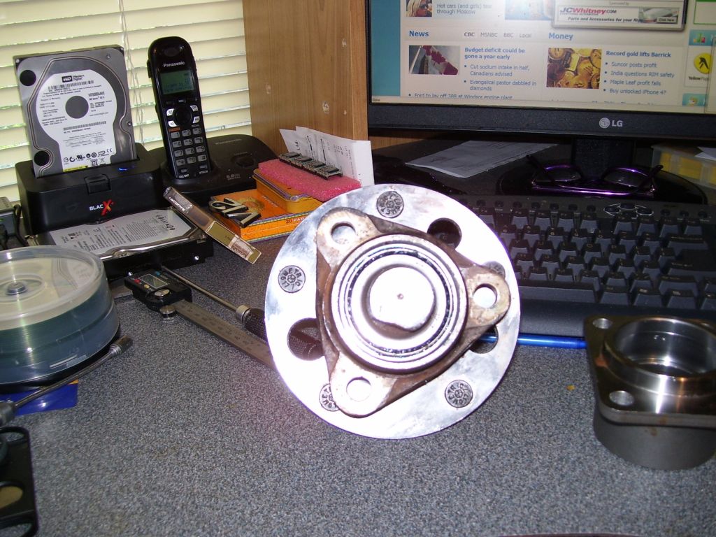

Originally posted by Fiero2m8:
Update for fieroguru:
After some more R&D we are going to mod Bearing #513009 instead due to its smaller size 2.79" vs. 88 spindle of 2.74"
Timken or FAG #513009
Cross Ref #7466902 7470539 7470540
Non-Drive (FWD)
REAR w/Disc Brakes
Non-ABS
Fits:
1979-1985 Buick Riviera
1979-1985 Cadillac Eldorado
1980-1985 Cadillac Seville
1979-1981 Oldsmobile Toronado
1982-1985 Oldsmobile Toronado
http://www.alibaba.com/prod...eel_unit_513009.html
What dimension are you referring to? The OD of the housing?
Fiero2m8 JUN 10, 10:23 PM
Yes like this picture
To do this
