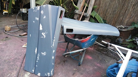

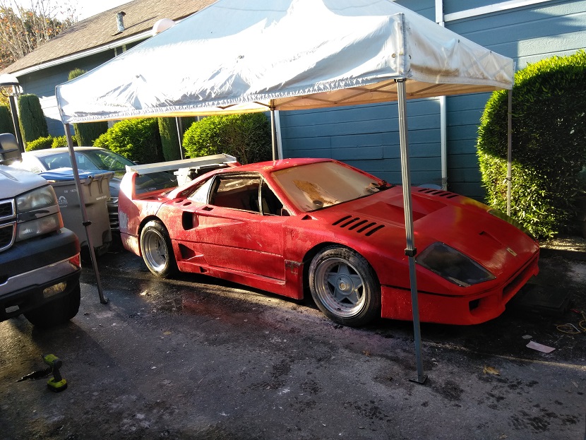

Sanded everything down, and got a final skim coat o bondo on everything
sanded it all down. I was able to do 5 areas at once it was nice.
Saves hella time
A-pillars, front door edges, top rear hood, and extended lower side all done
mostly
This phone takes weird pictures it makes the car look a bit different than it really is.
Got the a-pillar bow nice to match the window frame curve

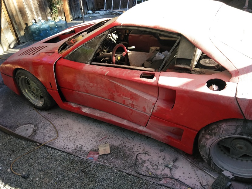

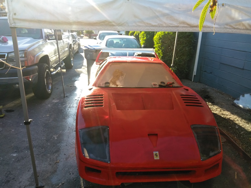

Details schmetails, carved out the hood emblem area and cut the hole for the latch
Cut out the rollbar, it was .5" too high and the roof was sticking up a bit. Got everything set and itll be back in soon.
Trying to get this thing symmetrical is a pain, added .75" to the ps upper hood, filled in the lower hood faring. Started final sanding the doors.

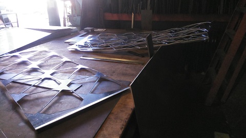

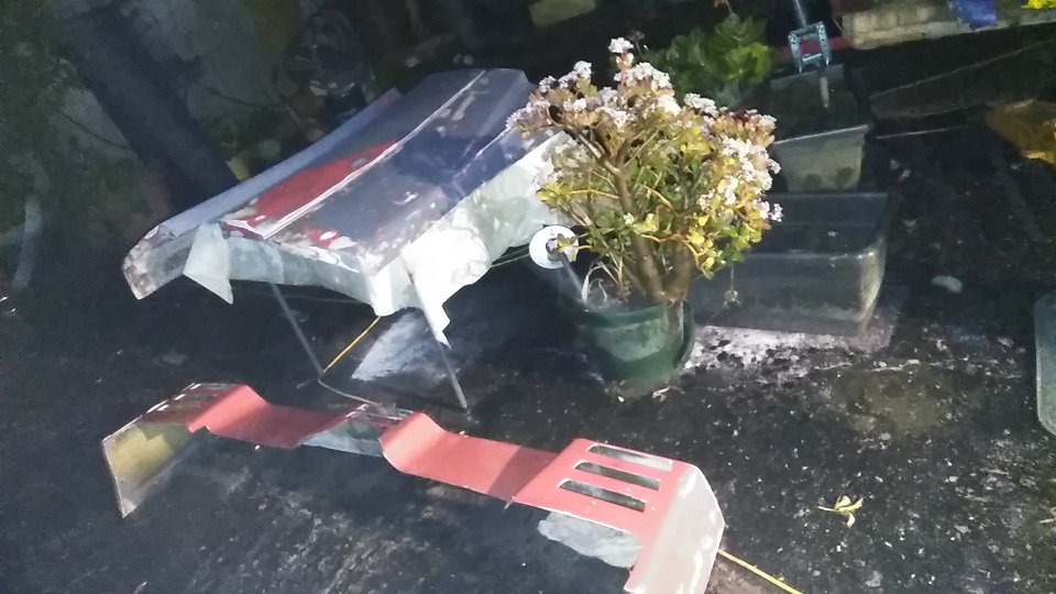

Hit the machine shop tuesday and raided the scrap bin. Found some pieces that had a few inches of alum left. Hit em w the bender and sheared off the ends to make vent molds. Inner and outer molds. Tried a lil, coming out pretty good but ran outta mat. I did three of the upper rear vents on the trunk and theyre coming out killer. Onto my 12th gallon of fb! Cmon guiness! Probably 7 gallons worth is stuff I didnt like and cut off to redo, but hey guess whos getting good at fb. Not me lol
need to finish up the hood and this trunk, and make hinges

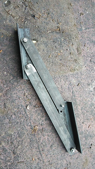

Started playing w hinges yesterday, need to experiment w different lengths of arms and bolt patterns to get what i want. Saw these on full custom garage, made the pieces at the shop.

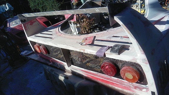

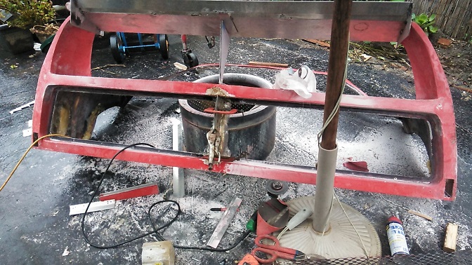

Started redoing the back grille to be more like the real deal. Friggin cold so I have to use a wee bit more hardener to make the fb dry, then it started raining on me. Set up a patio umbrella, kept working.
Trunk is looking really good w the upper vents going in.

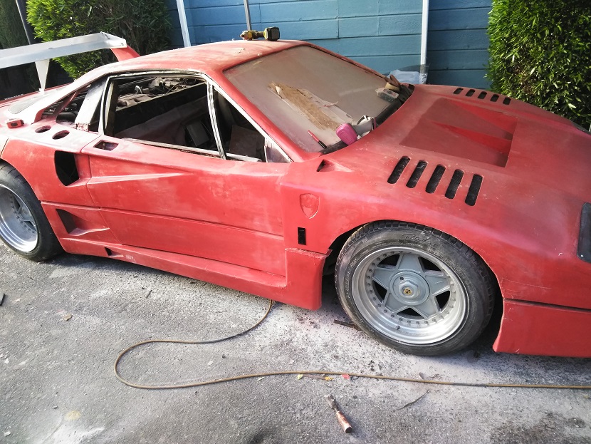

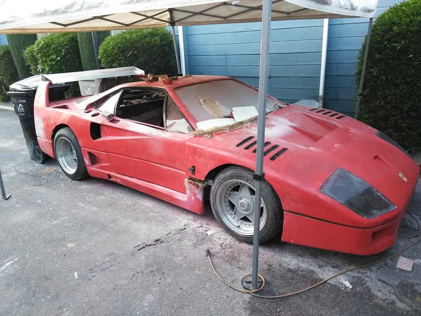

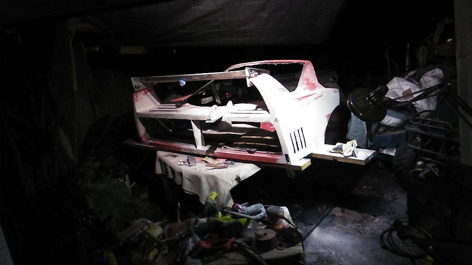

Been fillin n sanding w the nice sanding blocks and paper. Goes kinda quick using the good stuff. Doors are ready ready, and the rear lower is pretty much ready. Been spending assloads of time on the trunk. I made another way to mold the vents, worked out good on the top vents but the sides are still giving me trouble. Most of its skimmed up and straight, top vents done and sides need a lil more luv and I need a mini round file. Using so many tools for shaping its nice having everything I need.

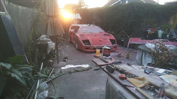

This was from last night, it started raining so I set up a tarp to keep sanding. Been cold and cloudy, no Uv no fiberglass drying quickly. Had some pieces go overnight, and it gets dark at 4fu@king30 which suxx lol. Bondo will still go off but the fb wont even w a heat gun.
heres the doors and the rear lower w the newly cut vent thingies no ones ever gonna see

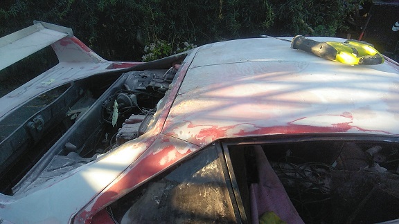

Goin to town on this like there no tomorrow! My hands are fu@ked up, at least 20 wounds, cuts, divots, stabs, and abrasions. Screw
gun slipped off the screw and went into my thumb yesterday, smacked it w the 4lb sledge today. Se the car on fire 4 times. Welded the hood
hinges, set the hood on fire. welded the rollbar back in, set the roof and trunk lid on fire. Welding the lower part of the rollbar back in and saw a
buncha smoke. Pulled the welding blanket back and the whole area behind the drivers seats on fire. Put it out w my hand. Burned the **** outta
3 fingers. Blisters popped while working. Im in bad shape but the cars lookin good.

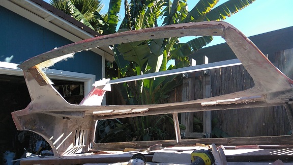

Symmetry eludes me. The whole kit was asymmetrical when I got it and after cutting the large pieces into sections- they warp. Been getting everything to within 3/8". The top of the rear window
never sat perfectly so i ripped it off. Bolted a simpson strong tie to it that I put some curve into. Broke the udder side and laid some glass
came out titties! Now lining the new curve to the rear o da roof one sides off. I was going to glass over it and ut some expanding foam down. Its too cold for
the foam to go off so I cut the roof up. Its all lined up nice now and the gap is still pretty good. Glassing around noon tomorrow, thats the only time I have any
sunlight.
The roof will have a nice round equal curve now. Cut the groove for the rear mesh and trimmed the mounting plates to sandwich the mesh between the lights

started cracking on the hood, its mostly straight, the belt sander does a good job. Just a few low spots im finding w the longboard. Welded in the hinges today
and need to move the center scoop over 1/2" and finish the top curve of the hood.
