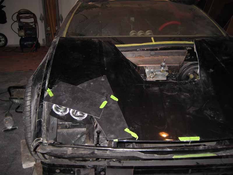

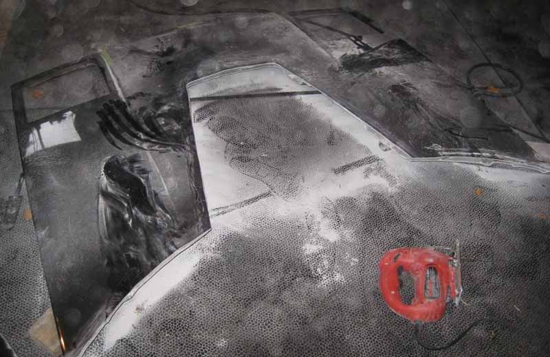

Okay, January was a BUST !

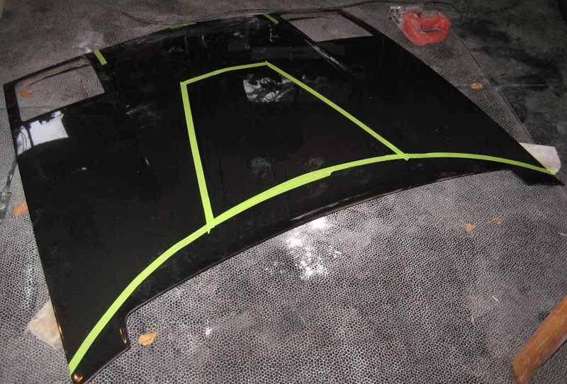

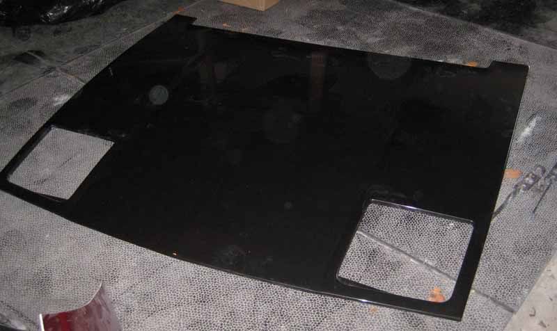

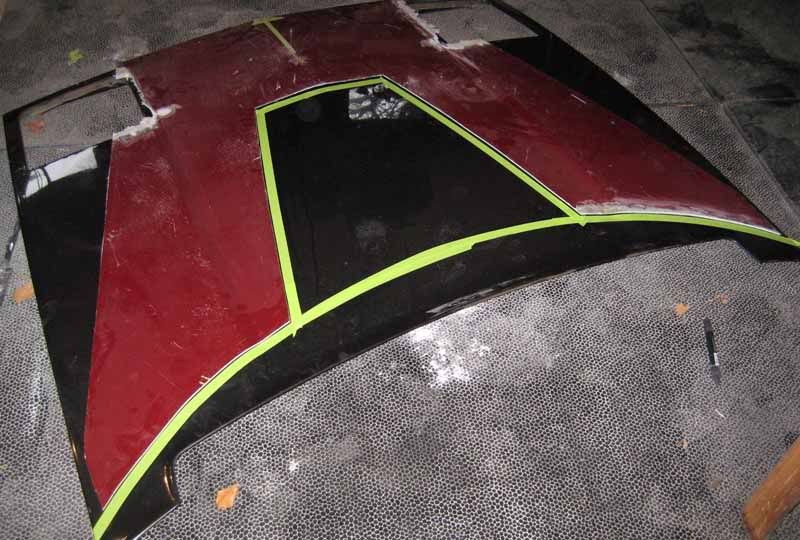

Hood # 3 to be hacked up (got it from my buddy Blair)
I'm trying to raise the bar for (most) hacked up body parts
Hood # 2 was a rehearsal...

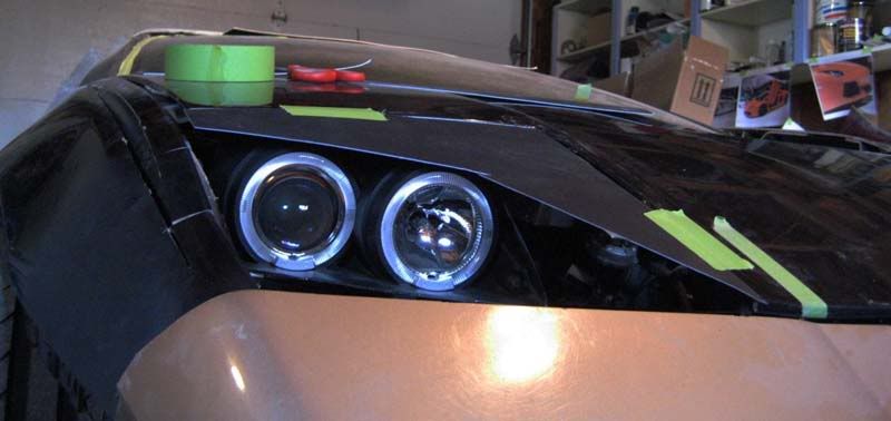

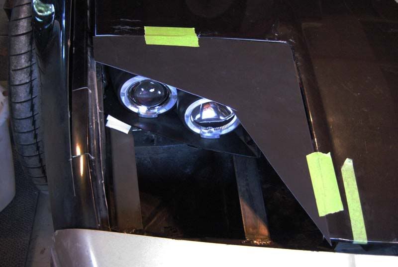

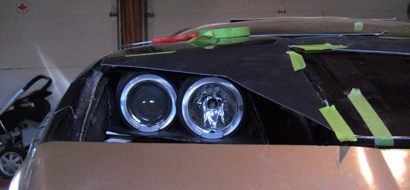

Playing with headlight shapes...

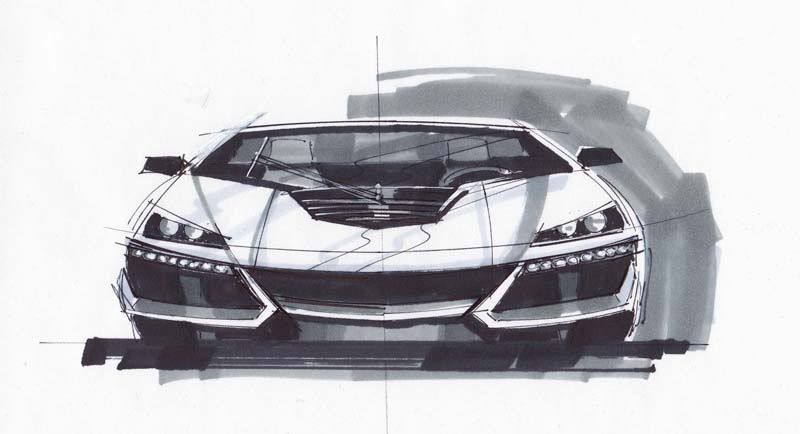

Rough sketch...(it may not be this one, still playing with designs)

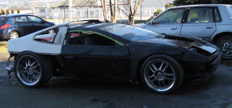

Car-Lo FEB 03, 11:17 PM

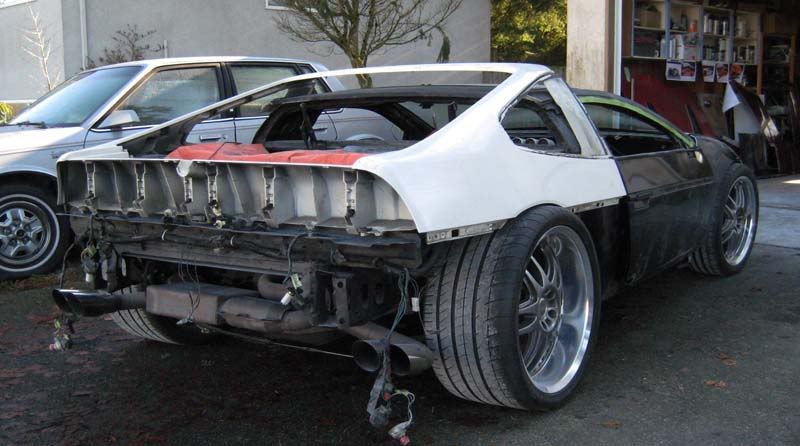

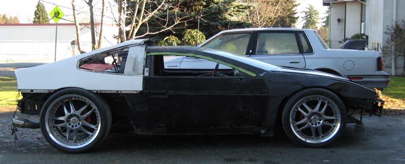

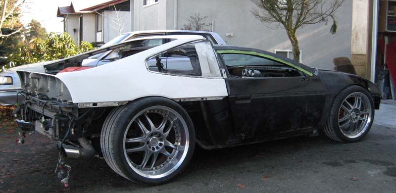

RBS old rear clip is really butchered up, going to start with a fresh rear clip (from Blair)

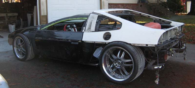

Very interesting fun shots stock rear clip on chopper...
[This message has been edited by Car-Lo (edited 02-04-2012).]
pistonbroke FEB 04, 10:46 AM
Looking great so far and the standard rear clip really shows the severity of the chop.
Do you think that the Mazda windshield would work with say a 2" or 3" chop? I'm over 6' and I think I would really struggle. I realise that you are going to make seats that sit on the floor to increase headroom but what are your ideas about altering the angle of the steering column so that your not driving like a chopper with ape swingers?

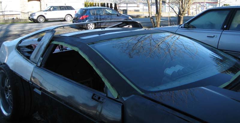

Had to EDIT: (for I am BOZO)
Photo below showing Mazda windshield laid on 2" chop, Mazda windshield is 2" wider at top, we had to go lower to 4" chop
(more chop the wider it gets) I hope this makes more sense ?
I'm sure you can make anything work if you're a fabricator (I'm not, my buddy Clynt has all the skills and tools for that)
Like I said before Mazda windshield may not be the best choice, lots to choose from (they all look nice now) ?
As for steering column, Fiero is adjustable, clicks right down on lap, if you're fat then it's going ape

The lights look good. I presume that you decided to keep the stock line from the front fender to hood in the end. as opposed to your origional idea to alter the fender to meet the diagonal shut line of the cut hood (if that makes sense) what changed your mind?

The original front fender and hood thing, it was so much easier to use stock line

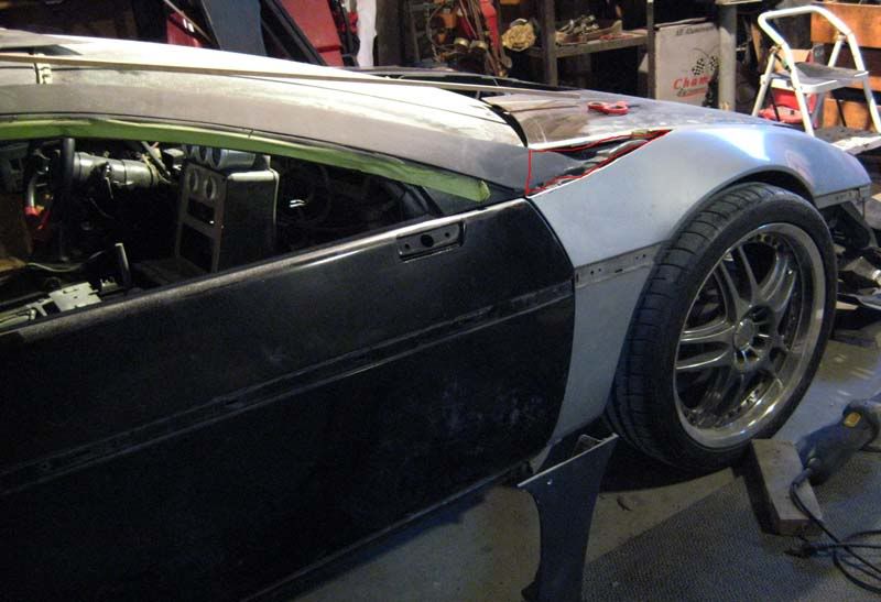

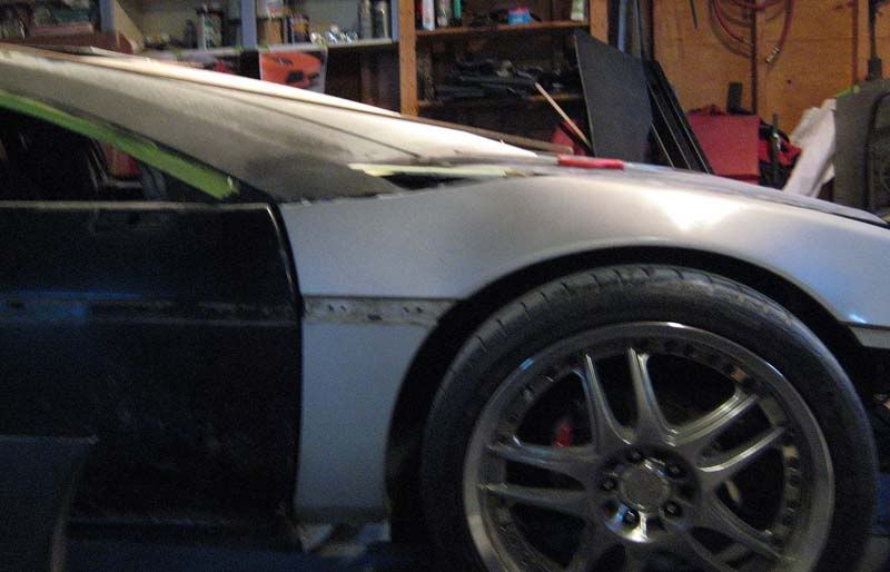

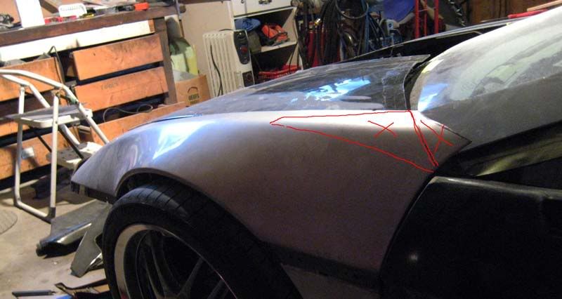

Today playing with body parts...
Cutting that bump off as shown in red line
As Sir Charles would say "kick and swoop" door to fender line
Red line area would be filled in
Profile showing flowing "swoop" door to fender
Very roughed in, overall view
