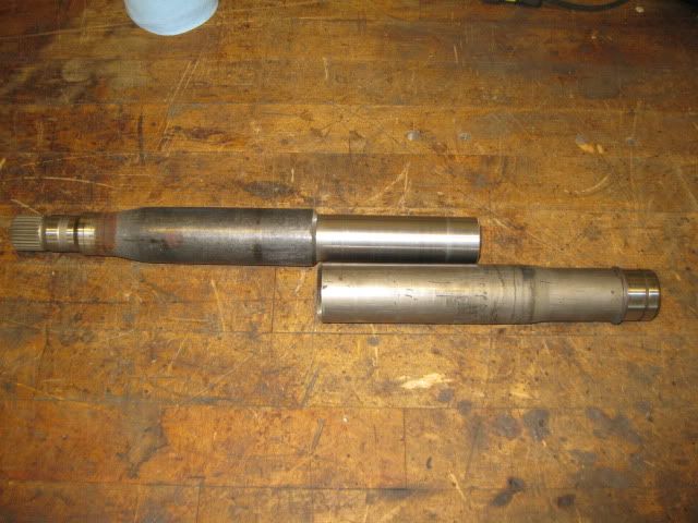

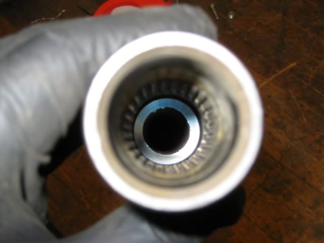

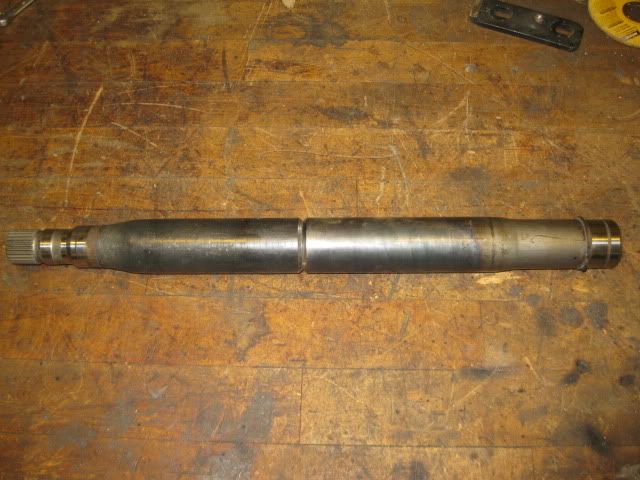

I was able to get an early start to the 3 day weekend by pulling the intermediate shaft back out of the car, shortening it 3/8" (final overall length will be 19 1/2"), beating in the first side 4" cold (and some slight heating once it was over 2" in) and then leaving 5" for the other side.
I used a propane torch to heat up the powdercoat material and scraped it all off. The female side is now in the oven at 500 degrees and the male end is in the freezer. After about 30 mintues in these conditions, I am hoping the other side will go together without much effort with the addition... brought a 2x12x24 piece of wood to put on the kitchen floor, my mini-sledge and a 2x4 for the top side... wife is pretty proud of me this evening!

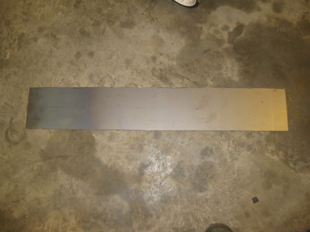

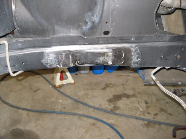

Started the work on the engine bay today. Welded in the relocated panel on the DS frame rail, removed the last remnants of the decklid hinge boxes and pulled the 6 1/2' x 4' sheet of 1/8" steel out to cut a 30" x 48" piece (easier to handle for future small pieces vs. always pulling out the large sheet) and from that piece I cut a 6" x 36" piece that I will bend into an somewhat open "L" for attaching to the firewall and rear glass tube.

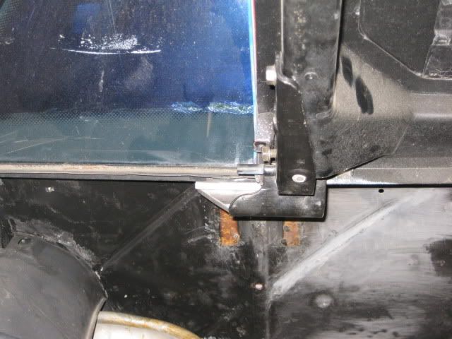

I put the decklid back on the car, weighted down the rear and then used some large washers to set the panel gap:

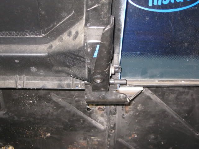

Here is an underside view of the factory hinge:
The plan is to cut the hinge off where it bends for the attachment to the stock hinge boxes. Then weld a piece of 1/4" steel to the hinge and have this plate bolted to the fiero chassis... something like this:

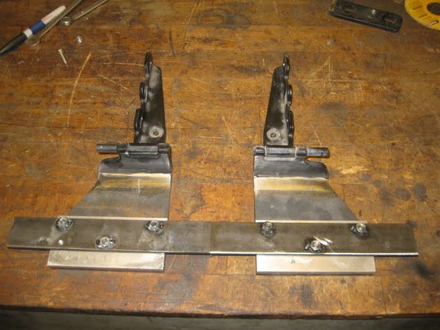

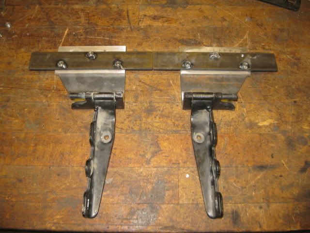

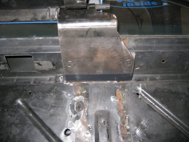

Here are the two modified hinges ready to be installed:
fieroguru MAY 31, 06:06 PM
Hinges are pretty much done, I may reduce the 1/4" spacer to 1/8" to better line up the body line at the decklid vents:

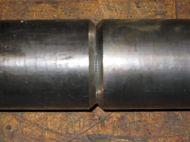

My 12 ton home made press didn't have enough push to slide the two ends of the intermediate shaft together, so I took it to work and got it done. There is about 4 1/2" of overlap on each side. I would have it welded already, but ran the welder out of wire... :
