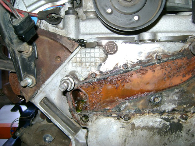

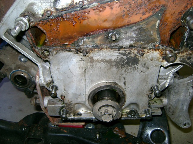

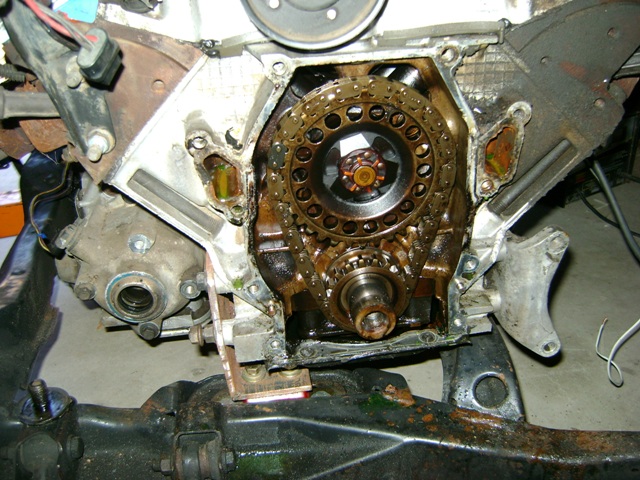

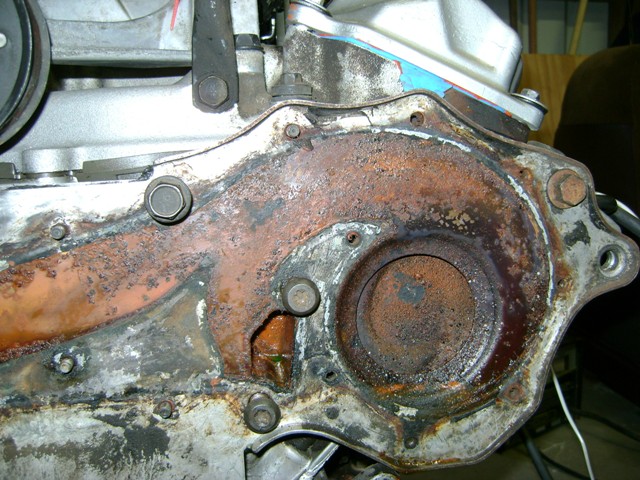

Removed the water pump,balancer and the timing cover today so I can install the new water pump inlet housing. I'll post some photos later tonight. Wasn't to bad at all. I had to find a small balancer remover as mine was to large to work. My block still had pretty green anti freeze in it.
There are 4 or 5 different size fasteners that hold this all togeather. I took a photo of the way it is so I could get it all back togeather the way it was:
Left side
Right side
Timing Cover removed
Water pump side of the timing cover

I'd spend the money and get the lifetime warranty water pump, as you can see its not that fun to do. Also using some brush on gasket sealer helps so the water pump doesnt leak. This keeps the gasket in place better too.

Whats the best way to do this? Timing cover on the engine first, then the water pump, and lastly the inlet housing. Or inlet and waterpump on the timing cover , then all of that on the engine?
Dan_Seattle JAN 03, 12:00 PM
That's good progress Josef. I did all the same with mine while the engine was out. I would recomend the new lifetime water pump as well. It's really nice to see the whole front of the engine look new. Also did the oil pan gasket, front and rear main seals and anything else I could buy a new seal for.
I don't really remember what order they go on. I've always done the waterpump last. I believe there is only one way to do it though
