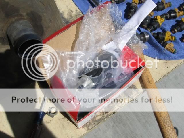

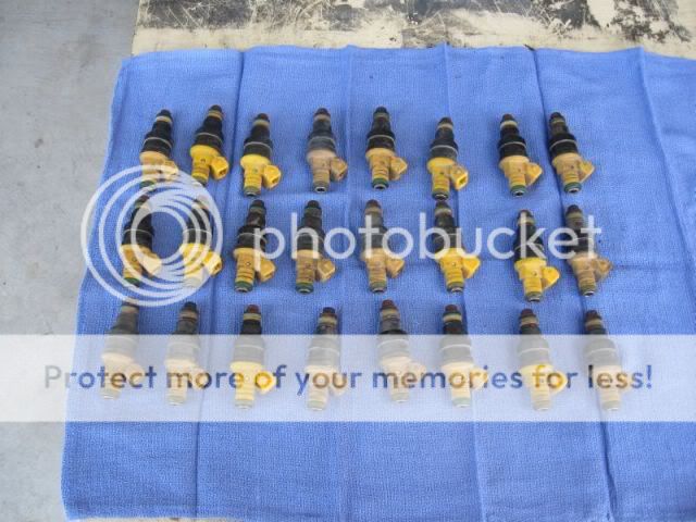

Went to the Mega Pull and picked up 3 sets of the Bosch injectors to send off for cleaning and service. It took all of 45 minutes to pull 3 sets. Cost me 10 bucks! So after shipping to and from Mr. Injector, I'll have about 50.00 in a set of refurbished Bosch series 2 injectors! I had pretty much talked myself into just ordering a set of the 100.00 ones from E Bay but decided to go get the used ones and get them serviced - saved me 60.00.
My buddy Jeff gave me a brand new V6 fuel pump today - Thanks Jeff......CJ will have to wash and wax your Fiero one of these weekends.
Here's my junk yard score:
More later

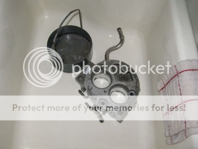

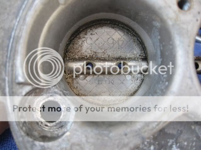

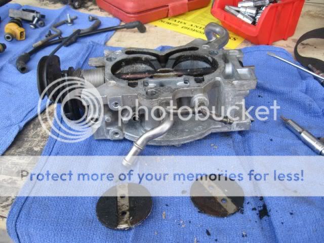

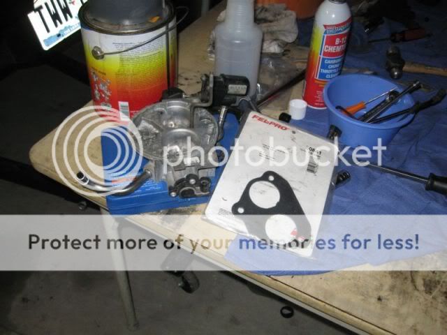

Forgot to add that I took the TB apart so I could give it a good cleaning. I need to search for a TB Seal kit - there's really only one seal but it was brittle and disintegrated when I removed the butterfly shaft. I'll have to do some diggin to find one. Hope they are available - maybe through GM only?
It's was sitting under a tarp with the air box on it but it still got a lot of junk in it:
Pretty good carbon and gunk build up underneath too:
I'll let her soak in Berryman's overnight then reassemble tomorrow - if I can find the shaft seal. I need to go back to the Mega Pull and hunt up some new rubber connectors as all of these are brittle and cracked. It never ends. All the little odds and ends a starting to add up.

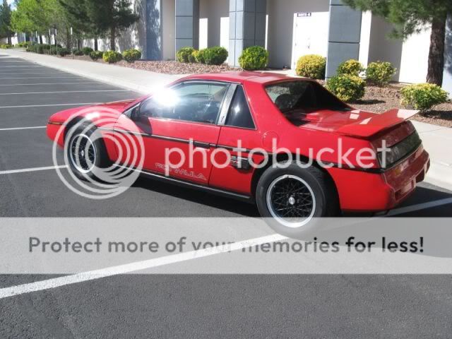

I went with some of the Fiero guys for a Lunch run today. It was a great day for some pics so I cleaned up the Formula and took advantage of the sunny day.

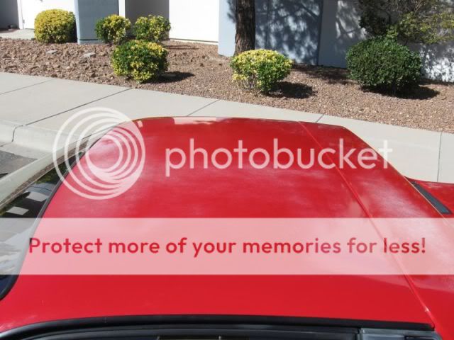

The Texas Sun is taking it's toll on old Red:
I'll have to see if I can get this fixed up before the Round Up!

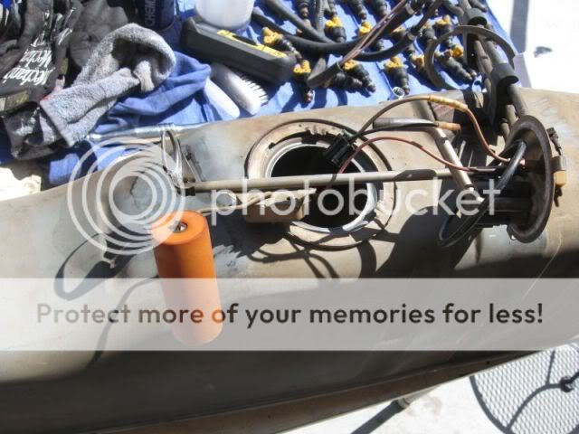

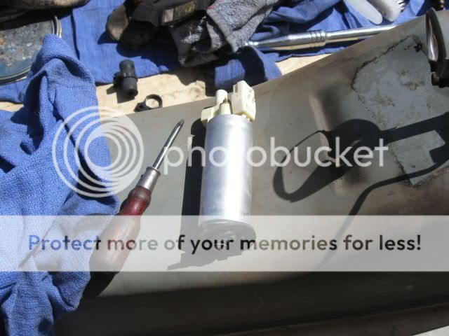

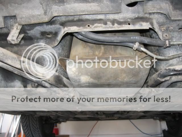

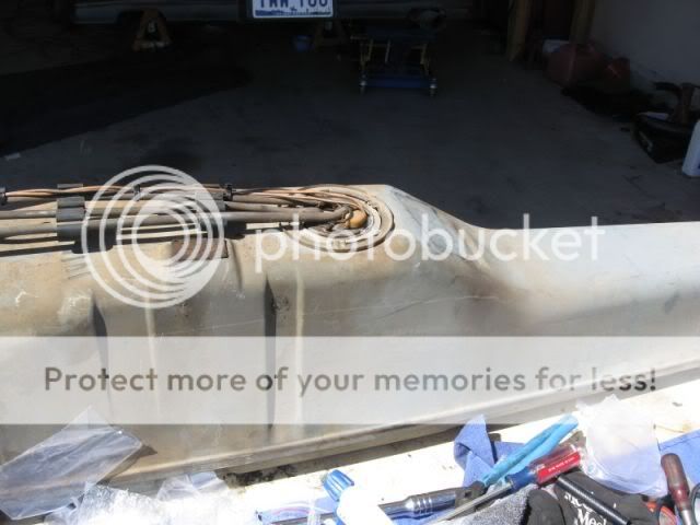

Today's project was to drain the fuel tank, drop it and change out the 4 cyl pump for the new 6 cyl pump. Fortunately, about 6 months or so ago, I pulled the tank to fix a leaking top seal and replace the pump. At that thime I alos replaced all the fule lines and fill hoses. I hot wired the pump and drained the tank. It was on the gorund in about 10 minutes, took 15 to change the pump out and another 15 to install. I hooked up some power and the new pump works.
Out wih the old 4 cyl pump - it's really only about 6 months old!
In with the new: Thanks again to my buddy Jeff for donating this new V6 pump to the build.
Buttoned up and ready to install:
All done:
Getting closer - more later

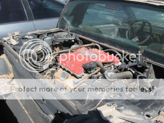

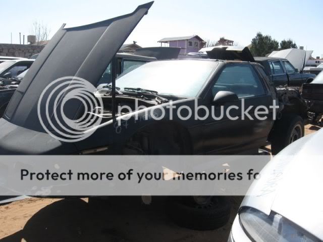

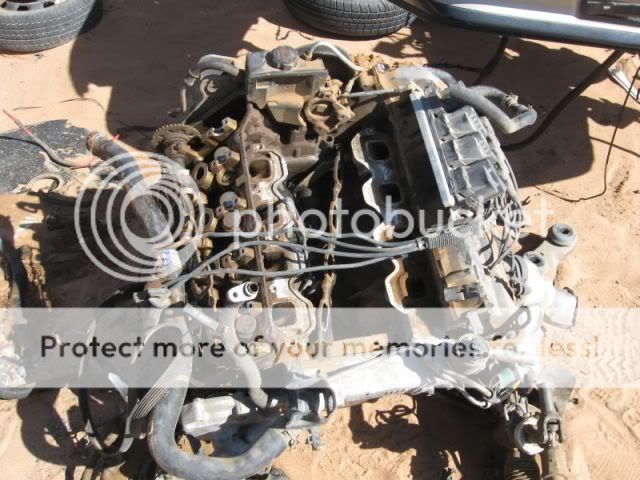

Another trip to the Mega Pull - it's really the only excersize I get - roaming the yard looking for goodies. I try to go every Sunday am to beat the crowds. For the last 3 months, I have had my personal stash of 13 - 84 and 85 Fiero's that were clear in the back of the lot. They were a great source of lots of little parts like screws, headlight motors, etc. Today I was going to get one rolled over so I could get the coolant tubes out of it and a few other little odds and ends. After walking clear out there, they were all gone - crushed!
I also needed some rubber vac fittings for the 4.9 so I headed back to the GM section. After getting the vac line, I wandered through the GM section from the back to the front - about 50 rows of cars - 20 to a row. What did I find in the middle of the section - a poor looking 87 GT. Missing the fastback, deck lid, tail lights and roof. Other than that it's pretty much complete. I think I'll go back next weekend and get the 5 speed out of it. The V6 looks complete but it's been sitting out in the weather for awhile.
While I was wandering I also found a few poor sad looking N*'s.

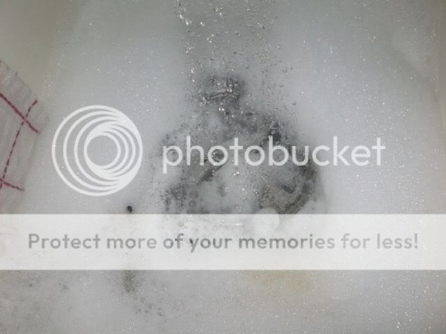

I soaked the TB in Berryman's for a day and finished cleaning it up this evening. I'll probably end up sleeping on the couch but I needed to wash of the Berryman's with hot water!
Hot soapy water:
A clear rinse:
Blow it out wih air and reassemble:

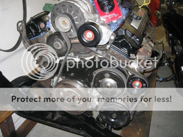

Finally got the belt put on - looking better all the time:

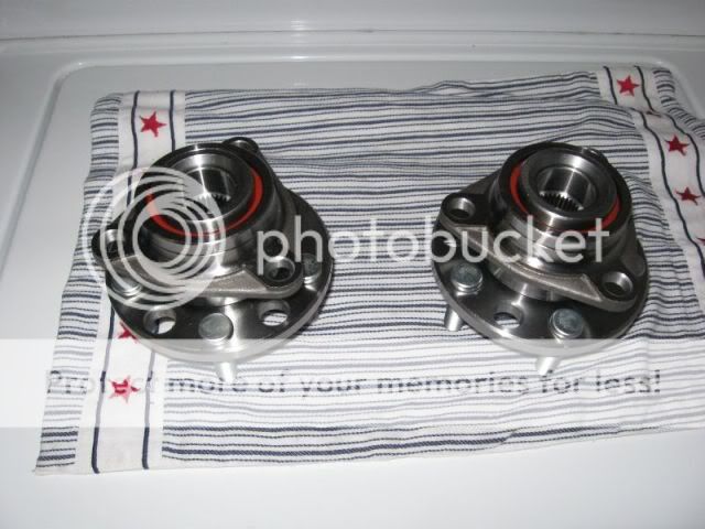

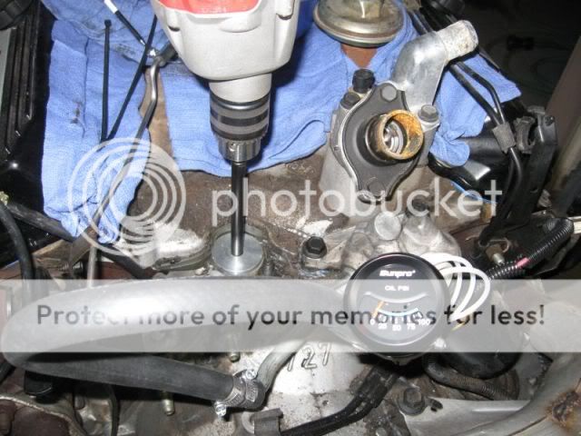

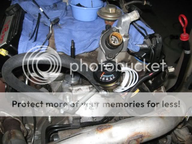

If you spy the top of the above pic, you will see the aftermarket mechanical OP gauge I picked up. My next step is to pull the dizzy, hook up the gauge and the oil cooler then spin the Oil Pump with a drill. This motor has been sitting for awhile and although it was sealed up very well, I want to get some fresh oil to the bearings before I turn the motor much. I may also pull the plugs and get some cylinder fog and spray it in the cylinders. I have a bore scope that I will use to take a peek into each cylinder to look for rust or foriegn material too. Also ordered new rear hubs yesterday. Getting closer to the stuff date.

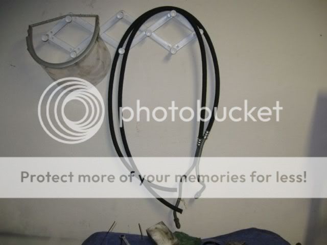

Worked on getting some oil pumped through the motor this afternoon. I was going to have some oil cooler lines made up but it turned out that we had all the tools, fittings and hose at work in the hydraulic shop. I hinted to one of the road mechanics that I needed some hoses made and when I came back from lunch, my new hoses were laying on my desk. This afternoon, I took a couple of stock Caddy oil cooler hose ends and made a "loop" so I could spin up the oil pump and not have to worry about hooking up the oil cooler. Then I hooked up a manual gauge, setup the drill motor and went to spinning. I could get 50 psi with the drill motor. I ran it for about 30 seconds, then rotated the crank about 1/4 turn, spun it another 30 seconds, rotated the crank 1/4 and so on. I'll do this one more time just before I put the motor in the car? I may try and run the motor out of the car once I get the injectors and harness back.
My new oil cooler lines:
Oil cooler bypass loop thingie:
Drill setup and ready to go:
50 plus psi:
