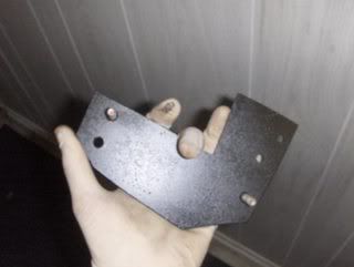

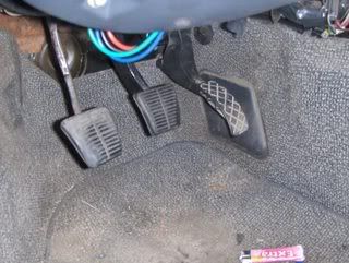

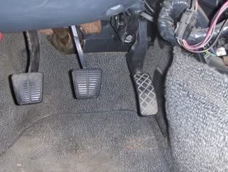

Tonight I made the gas pedal mount for the fly by wire throttle. I had to use the VW as pedal and make it work with the Fiero's mounting surface. It was actually quite simple. I used a piece of 3/16" steel and drilled the holes where they needed to be. Then I welded in 7mm studs to mount the gas pedal to. The plate bolts up where the original pedal bolted up. It feels just like it was put there from the factory.
Here are some pics...

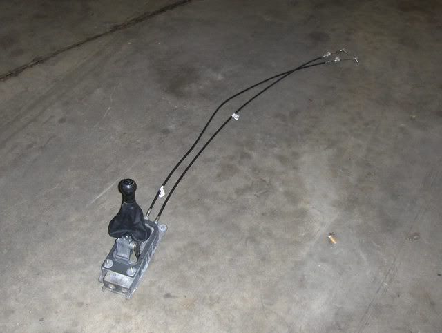

I snuck down to the shop this morning to play around with the VR6. I left the bay doors closed and the calls forwarded to the voicemail. Amaingly, the phone was ringing and I did see people come by the shop on the camera, but I was elusive and wanted total privacy.
Anyway, I fitted the VW shifter into the Fiero and made some slight mods to have it fit. Then I made access holes into the rear of the shifter housing to allow the cables to exit the rear of the shifter instead of the front. A few test fits and it fit rather well. I then started making the bracket for the transmission end. It came out looking great, but I had to scrap it because the cables interfered with each other when shifting to reverse. So, back to the drawing board.
My wife is planning another one of her crazy road trips this upcoming week, so I'll hopefully have a few nights to spend getting the final stages of this swap done. (I'm already planning the next swap in my third Fiero). Then the car is off to the body shop for fresh paint (my gold one is there now getting the paint done before the swap).
Here are two pics from today. I didn't include pics of the transmission cable bracket because it was not usable.
