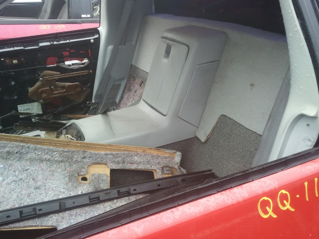

I see we're on page 68 now  While I was at the wreckers on Saturday picking up rocker panel covers for my Mercedes, I also picked up this:
I also found this 85 SE V6 with A/C which might come in handy if need more misc. parts when I reassemble mine:

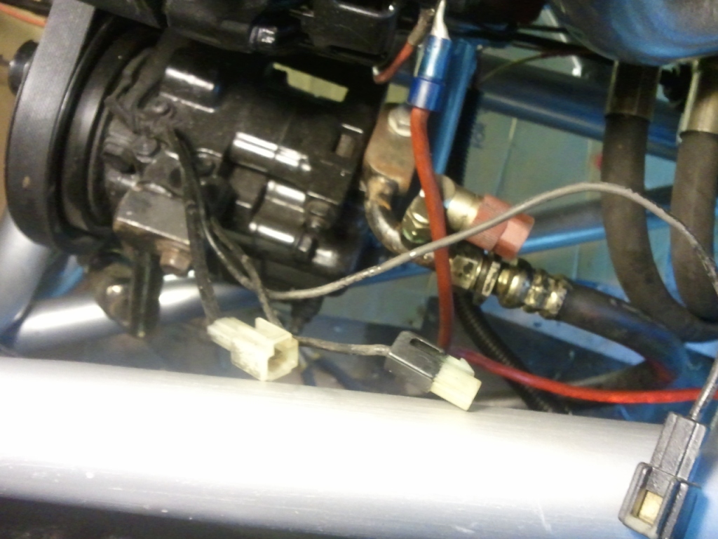

Also, question for Joe...I installed the suction and liquid lines today but noticed 3 wires from the compressor. One come from the clutch and the other two from the main housing. How do I wire these up connecting to the 2 wires (yellow and green) from the harness?

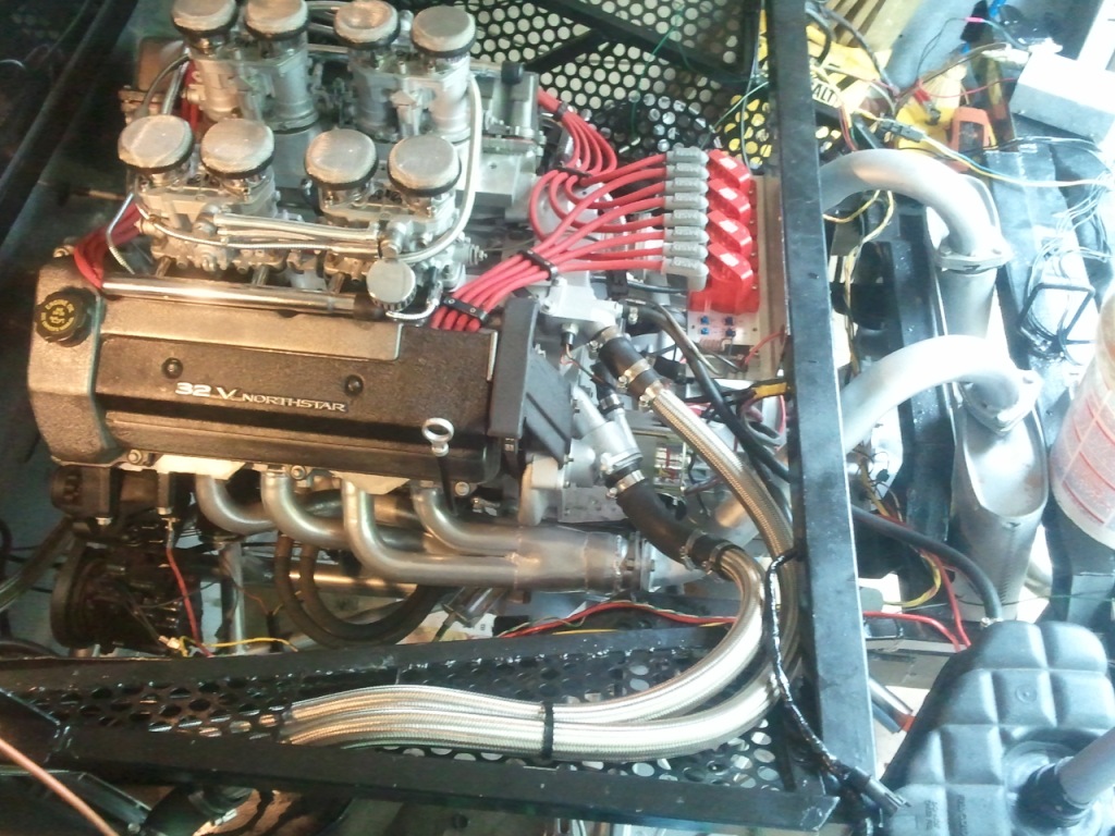

Okay this mod is finally done...
Last week I tried this setup but there were two issues:
1. I didn't like the fact that the coolant reservoir was no longer the highpoint in the system 2. The stainless line returning from the passenger rad to the waterpump developed a leak in the hose itself about a foot from the rad
That meant draining the DEXCOOL yet again  I decided to keep the other stainless hose as a spare for my upper rad hose (that doesn't leak) and went back the a hard line setup for the return
Cooling system is refilled with no leaks. All the air bubbles are gone. The guage is reading correctly with fans coming on above T-stat rating.

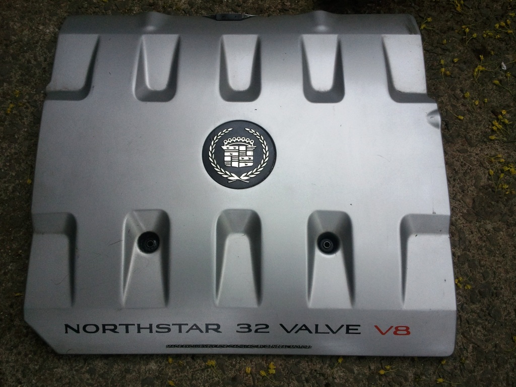

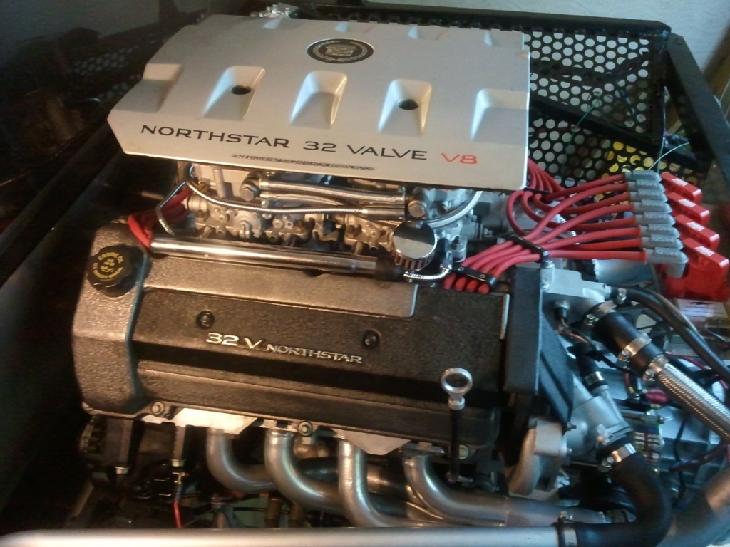

For the engine cover I wanted a tidy modern look with side benefit of less visible parts to keep clean: Sitting on top it's really far from the valve covers while vacuum tubes are in the way of stock location so I have two ideas to lower it to somewhere is the middle.

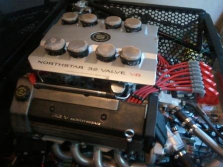

A - cut 8 holes in it for velocity stacks so it hides some plumbing but carbs still visible B - only use the centre section between the carbs just above the throttle linkage
If I don't like option A result I can still try option B but not the other way around.

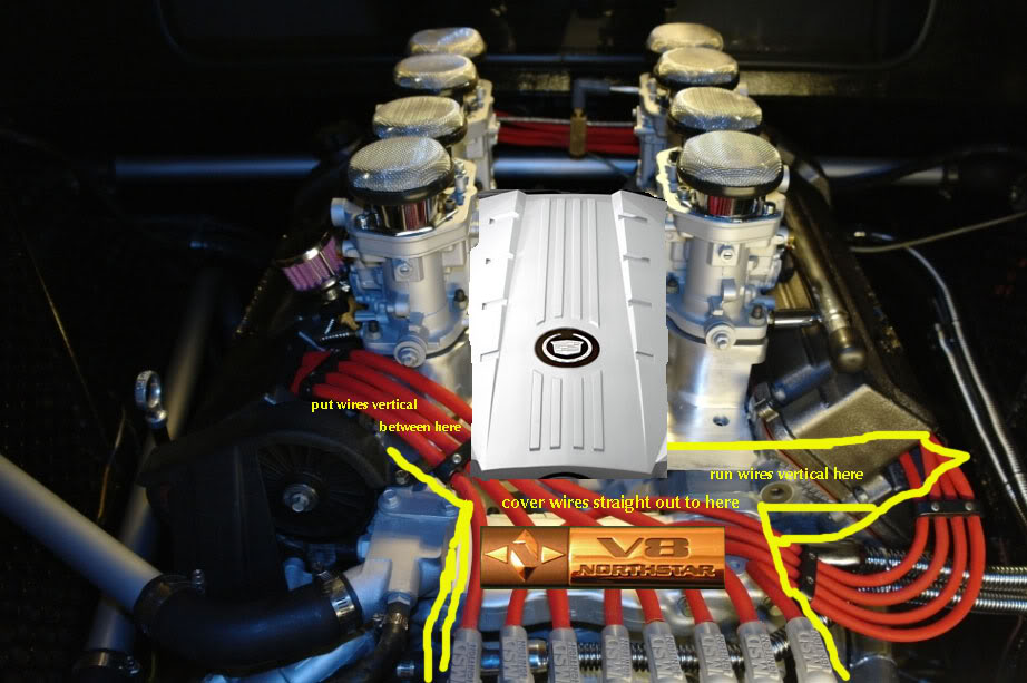

Here was Gokart's photoshop idea:

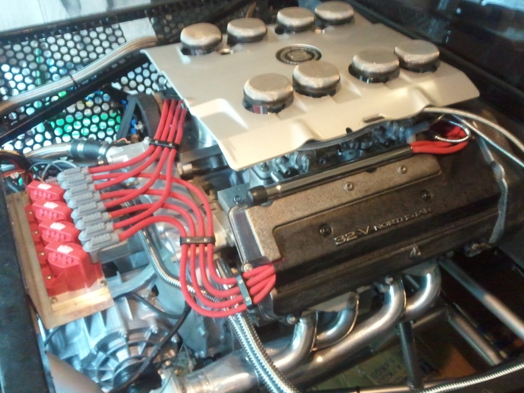

Here' option A:
Provide your feedback to help me decide...

MAY 19, 12:36 AM
I'm a fan of the bare look. The extra aesthetic pieces don't really do it for me, just detracts from the engine's natural beauty IMO.
but I'm kind of interested in how it's all interlocked, so I'm strange.
As a side note, I think this would look better than the other option.
