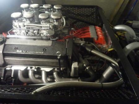

keep the hose well clear of the exhaust remember its teflon lined and will melt at 300 degrees

| quote | Originally posted by Fiero2m8:
Routing with look something like this:
This is the highest point in the system their was no fluid in the hard crossover pipe - a little concerning? Since the other hose connects to the bottom of the passenger rad I drained the DEXCOOL from the system in preparation for the swap. |
What about using exhaust hangers to hold the tube away from other parts. I'm sure you can mount them upside down so the tube is on top.
