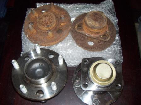

Is the hub circle size the same as the stock 88? The reason I am asking is I would like to use my current wheels which have the 57.1 mm hub centering circle and the 5x100 bolt pattern
Could a 5x100 bolt pattern be drilled on the caddy hub flange? I am desperate to do this mod if possible as my stock hub is getting noisy
I have to order and pre pay for the caddy hubs so I would really appreciate it if you could measure the hub and let me know, thanks!

Per the timken website/catalog:
79-85 FWD (rear bearing) 513010: Wheel pilot diameter = 2.76"
Fiero rear wheel bearing 513011k: Wheel pilot diameter = 2.25"

Thanks! So it looks like I am out of luck using my current wheels

Sorry Erik I missed your post but yes guru is right the hubs are bigger along with the bolt pattern.

No problem. Do you think the hub pilots have enough thickness to be machined down to 2.25?

Do your wheels have a removable concentric ring? All my aftermarket rims came with them, so when I swap hubs, I just swap out the concentric ring on the wheel.
I'd say not a 1/2" look at the picture:

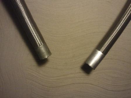

Last night I was working on the stainless rad hoses:
There is a local hydralic hose place that I going to have the one end resealed on both hoses now that I've cut them to proper length:
