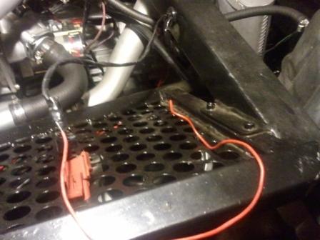

Originally posted by Fiero2m8:
Couple questions for Bubbajoe:

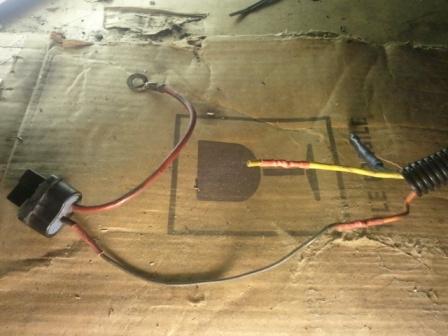

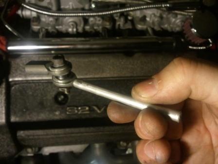

1. What do these wires connect to? (comes out of frame and then splits to red plug and red wire - can't remember if I cut it or it dead ended in the wire loom) [not used for cruze control]
2. Where can I buy a replacement linkage? (it was seized and it broke when I tried to adjust it shorter...looks like something from a hobby shop) no they are throttle hem joints may have 2 left here

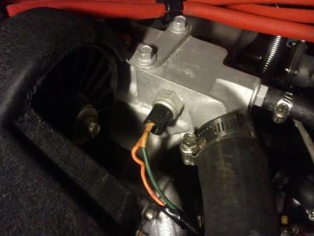

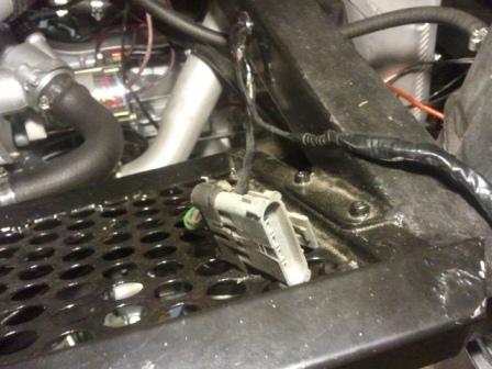

Fiero2m8 APR 28, 11:47 AM
More questions, inquiring minds want to know...
Plug and red wire goes to alternator - other two go to A/C compressor?
Coolant fans and guage are working currently - does polarity of these wires matter?
Is this plug also cruise control related or is it for something else (i.e. lighting) or not used?
doublec4 APR 28, 03:46 PM
I could be wrong... but I think that plug was for the original electric trunk popper, and the trunk light. Don't think it was for anything else, unless thats a different plug?
bubbajoexxx APR 28, 05:46 PM
Plug and red wire goes to alternator - other two go to A/C compressor? [ac]
Coolant fans and guage are working currently - does polarity of these wires matter?[yes ] one is light other is gauge
Is this plug also cruise control related or is it for something else (i.e. lighting) or not used? [cruze ]

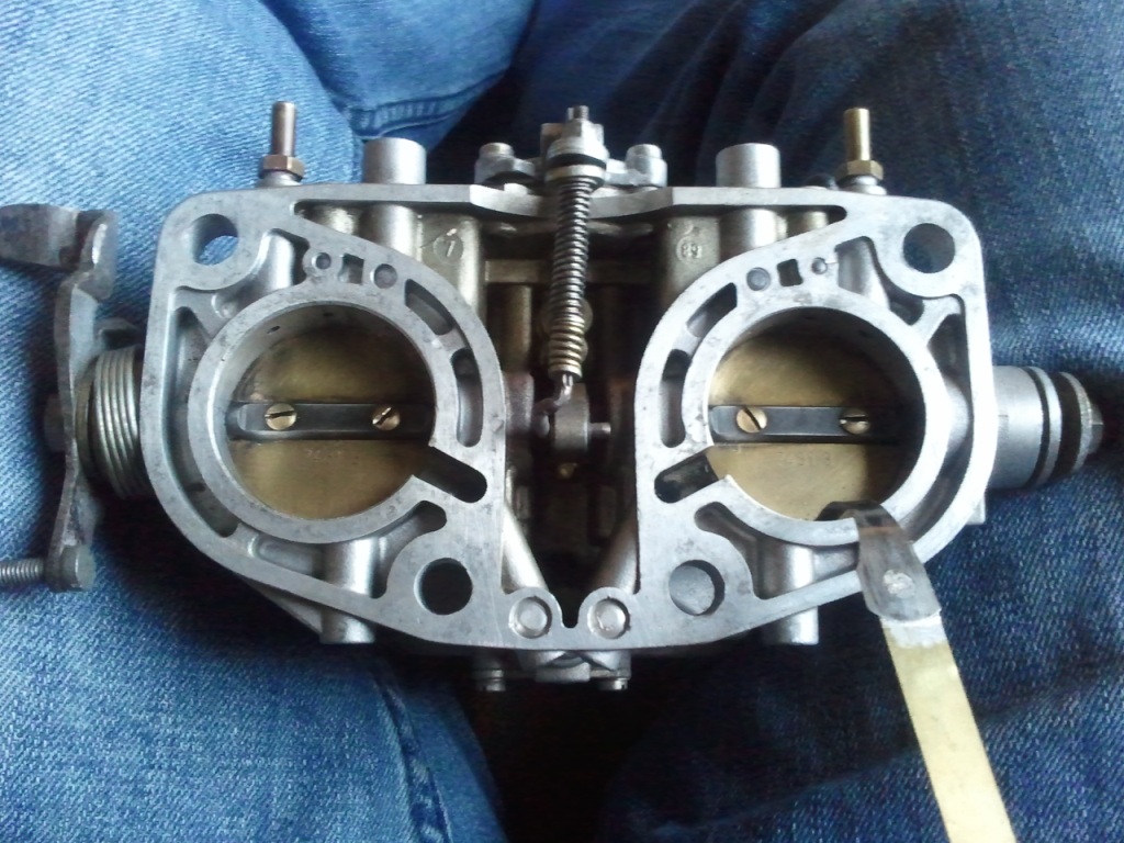

Here's a video of the carb idle air balance issue on cylinder #8:

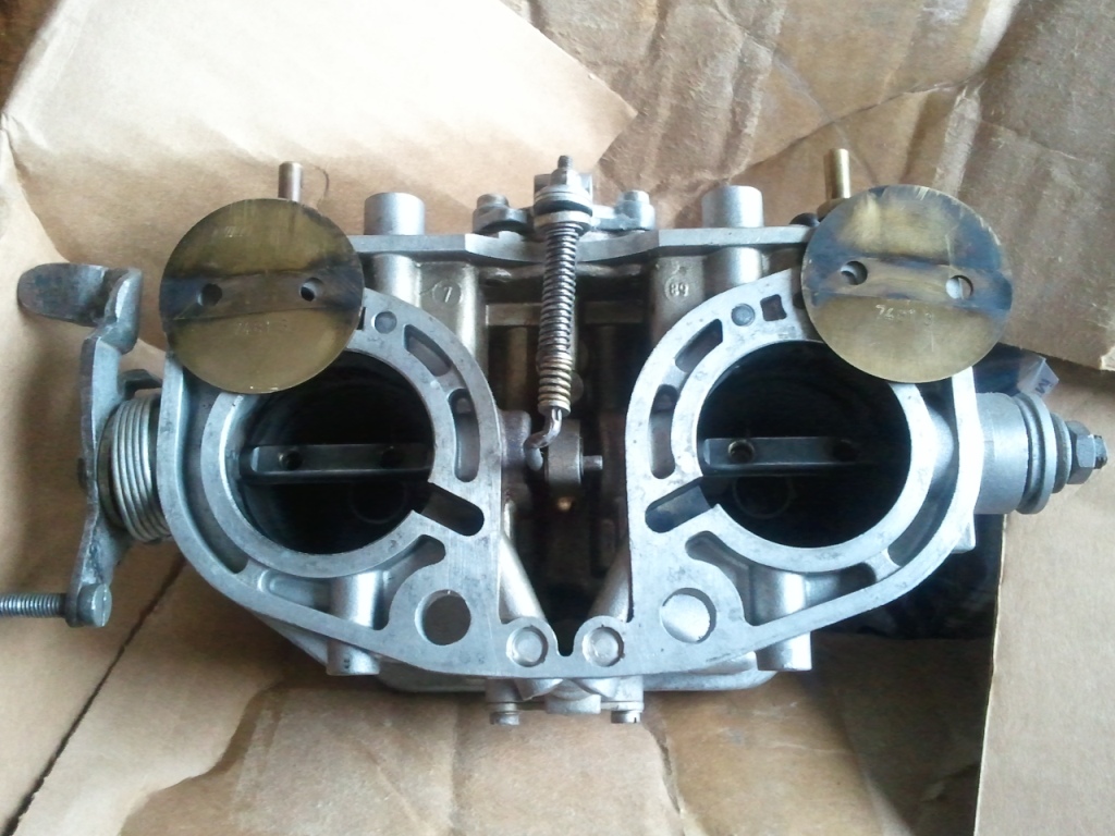

Since the problem couldn't be corrected with the air balance bypass screws, I removed the carb to bench reset the butterfly valves.
I removed, cleaned and the swapped their bores:
Then I used the 0.003" feeler guage to set the gap on the tighter barrel, then slowly bent the throttle shaft until both sides fit the guage like a glove.
Now I should be almost perfectly balanced and any final adjustment can be done with the air bypass balance screws:

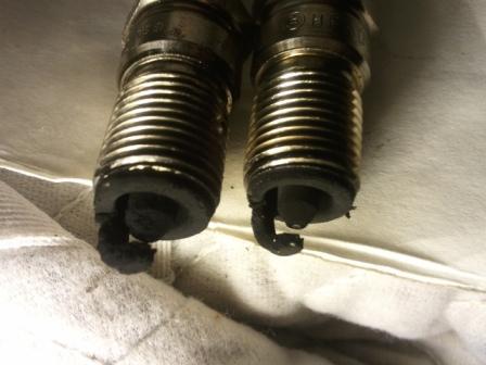

Fiero2m8 MAY 02, 09:53 PM
Originally posted by bubbajoexxx:
wont work with his HPV 1 as it requiers a gap of 32 Thou 40 will cause problems he requiers stock GM AC Delco plugs
Ah yes when in doubt read the manual...HPV 1 manual says 32 thous for stock V8 and 30 for hi-performance street.
So I guess I need an AC Delco part number of a non-platinum plug that has the right specs for a Northstar (size and heat range) that I can gap to 30-32 thou.
In the meantime, I have reduced the idle jets from 58's to 52's and turned in the mixture screws to half turn out.
After engine running at operating temp for a while plugs are changing to a tan colour.
