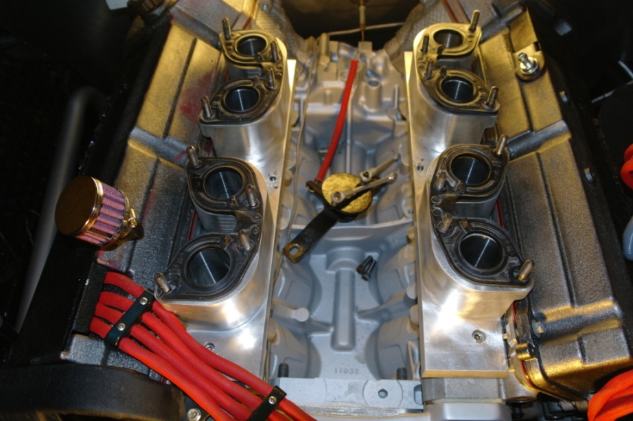

Update, the intakes have been resealed to eliminate vacuum leak:

Couple questions for Bubbajoe:
1. What do these wires connect to? (comes out of frame and then splits to red plug and red wire - can't remember if I cut it or it dead ended in the wire loom)
2. Where can I buy a replacement linkage? (it was seized and it broke when I tried to adjust it shorter...looks like something from a hobby shop)
Working on carb tuning, fixed a small fuel leak on the return line. I have vacuum at the PCV valve now pulling evenly from the 8 ports - if I measure and adjust it, any ideas how much vacuum the pcv needs at idle? Also I started balancing idle airflow on the 8 barrels using the unisync guage. 7 of 8 are close and just need balancing between barrels per carb, but cylinder #8 the airflow is high and bouncing up and down. Cylinder 7 is steady and a little low so I can't fix it with the idle speed screw for 7 and 8. Also they are outside the adjustment range of the air bypass balancing screws on 7 and 8. Going to check the fuel pressure as I suspect it's at 4psi and that is the first carb after the regulator. Dellorto book says it should be 3 psi and anything over 3-1/2 will cause spillover - hopefully it's that easy. If not that, I'll be checking for partially plugged idle jet circuit, vacuum leaks, spark plug condition etc. Once the idle speed is done, I'll be adjusting mixture on each barrel to find the sweet spot between lean snaps and rich smoke. I already adjusted from 3 turns out for initial startup to 1-1/2 turns out (leaner).
For dialing in the initial timing and 3000-8000rpm not sure how I'm going to baseline tune that without a dyno. Book suggests 12 inital and 24 degrees progressive as baseline settings for a SBC while I was running 0-4 initial and 18-22 previously on the Northstar. Obviously I don't want hard starting or detonation, but enough advance to get the best horsepower - any suggestions will be helpful.
Mostly I'm thinking out loud here and more reading and tinkering will help keep things going in the right direction. I realize that most Fiero owner don't have to tune 8 cylinders individually but hey if you were at the 25th, you can vouch that the exhaust note is uniquely worth it
