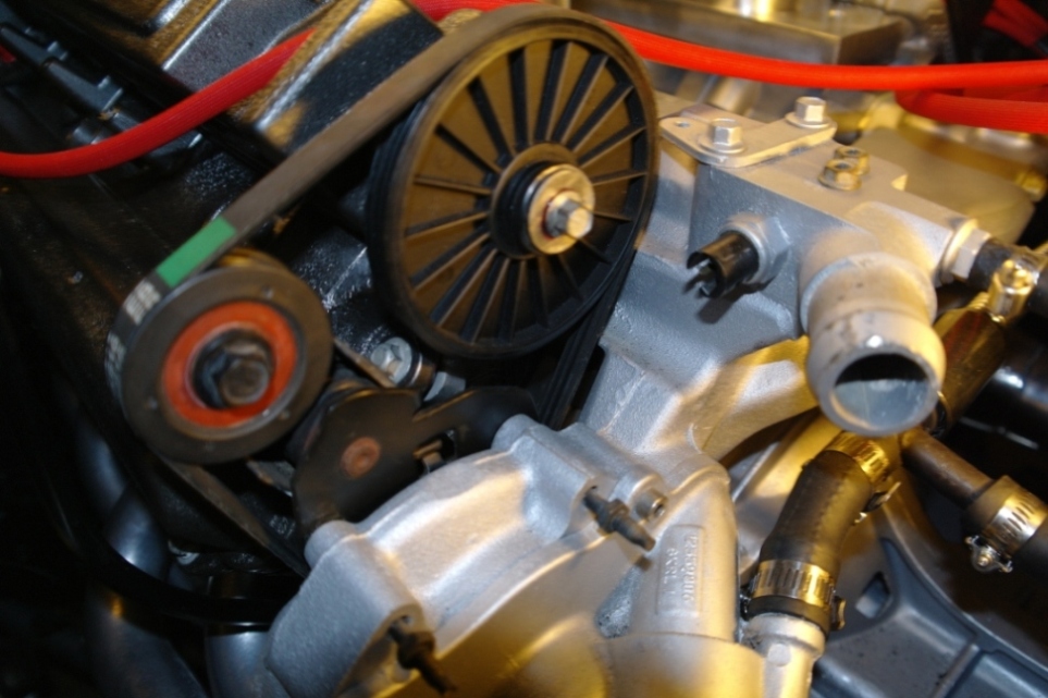

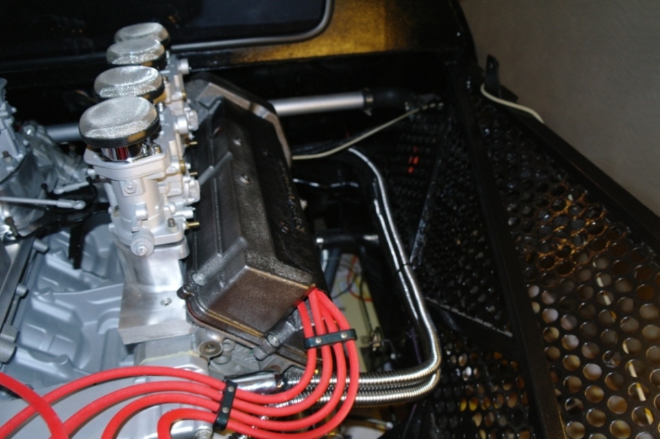

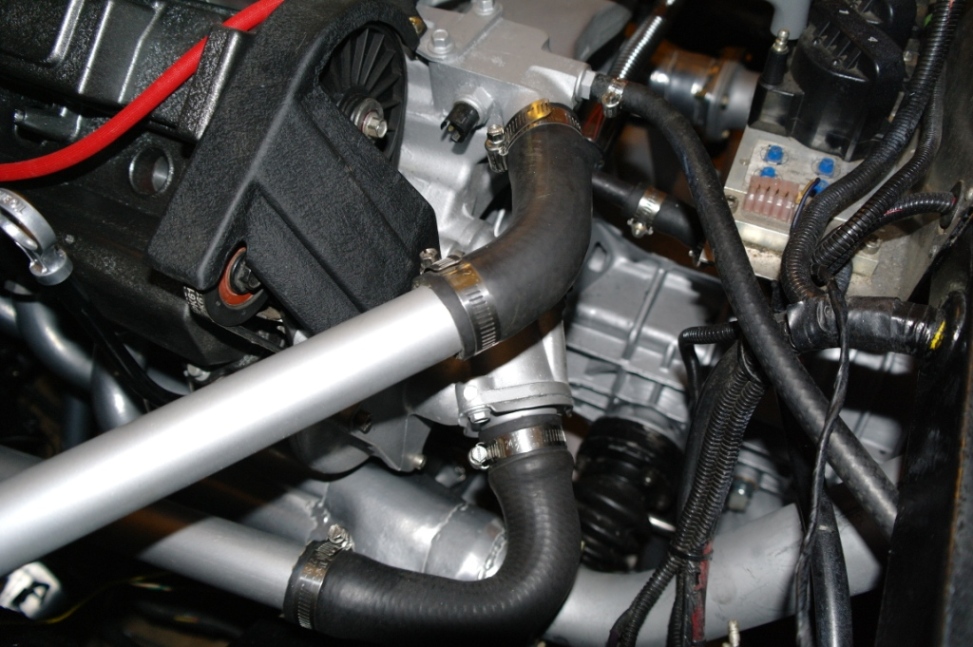

Cooling system is almost finished
All new stainless clamps and about half of the rad hoses are new.
For the heater hoses, I went with stainless steel flex hoses that are chrome plated.
Just need some proper clamps to finish mounting them.

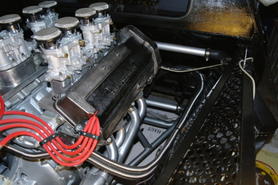

bubbajoexxx MAR 13, 04:43 PM
get those hoses away from the headers or you will boil the waterout and cause an air lock the headers produce too much heat for the hoses to be that close
Fiero2m8 MAR 13, 09:27 PM
10-4 Joe, will post the reroute this week.

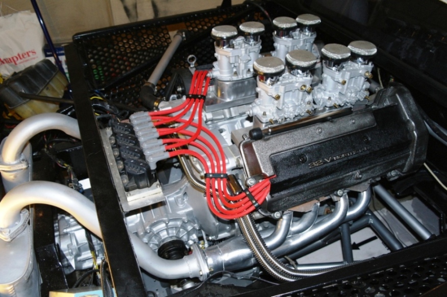

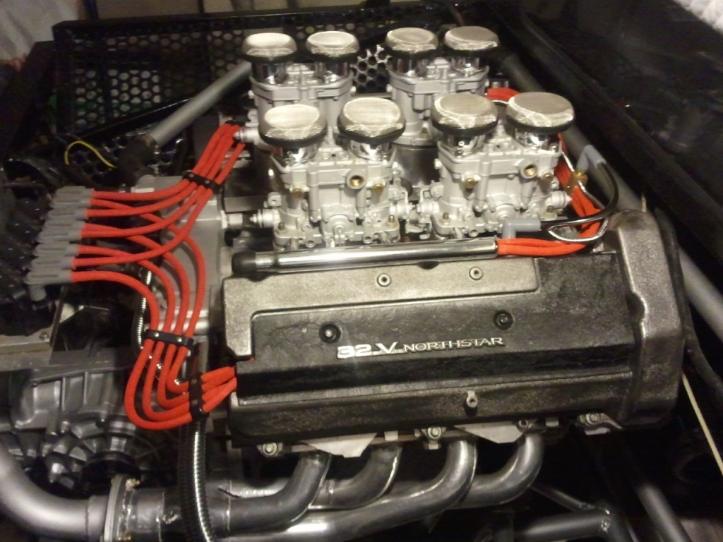

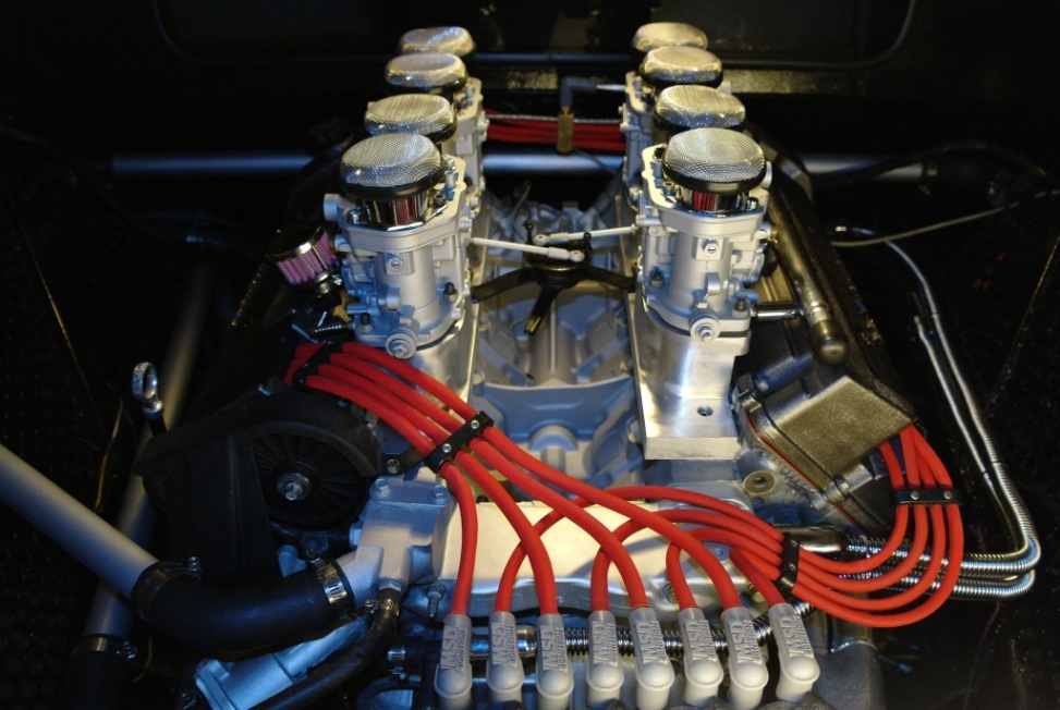

8mm Mallory spark plug wires are installed
Used thermal protection sleeving by Taylor
Wire ends and boots are MSD
New MSD coils should arrive next week

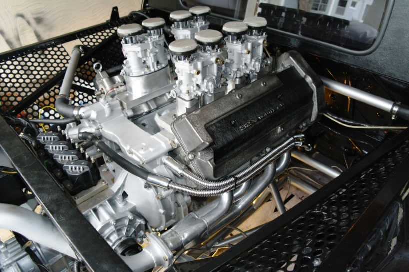

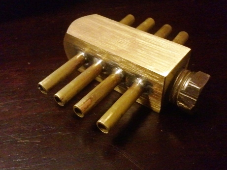

Worked on a new PVC vacuum system...
Here is the manifold to draw vacuum from all 8 carbs evenly to the pcv valve

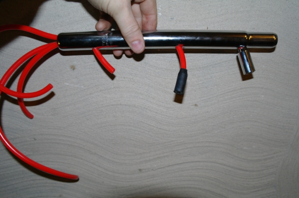

I came up with this idea for improved esthetics to conceal the vacuum lines
Here you can see the vacuum lines installed with chrome tubing
I'm also considering modifying a Northstar intake cover to conceal the throttle cable and engine valley

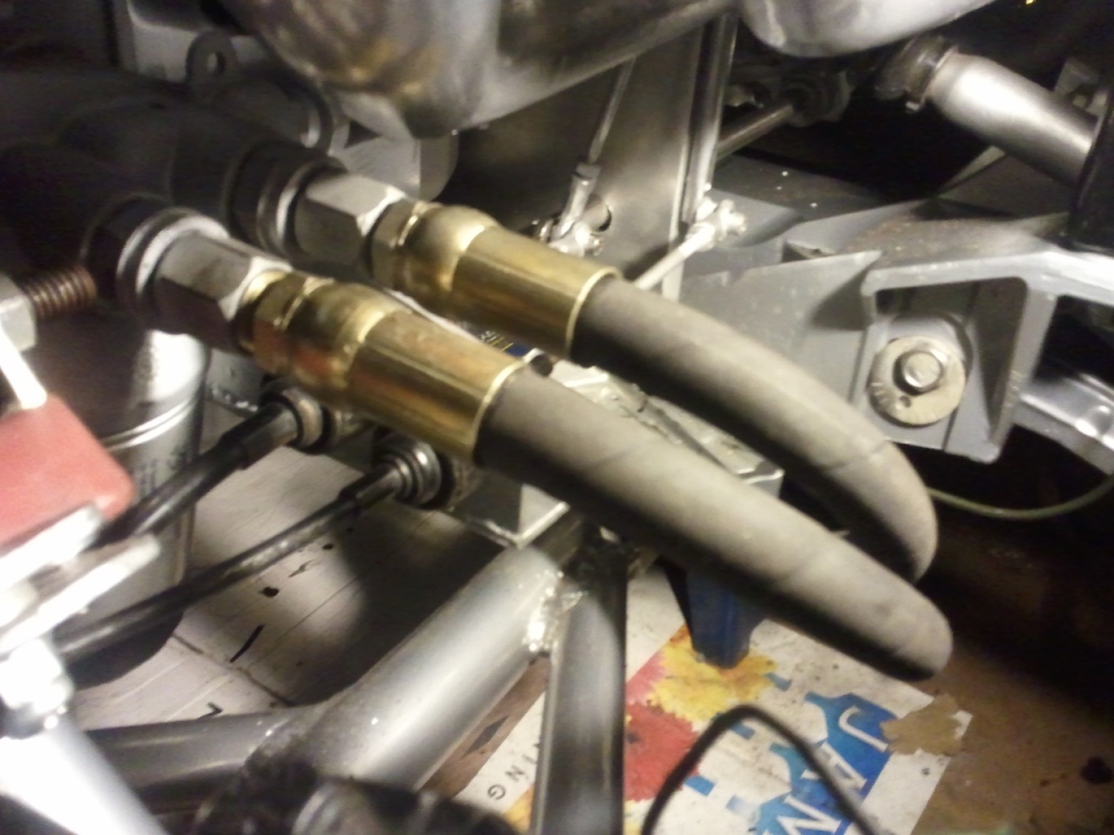

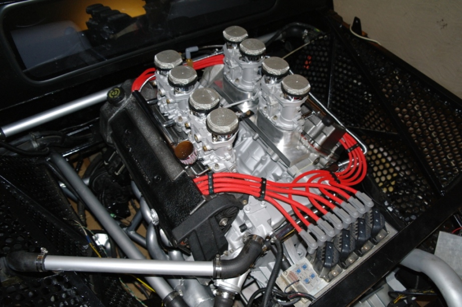

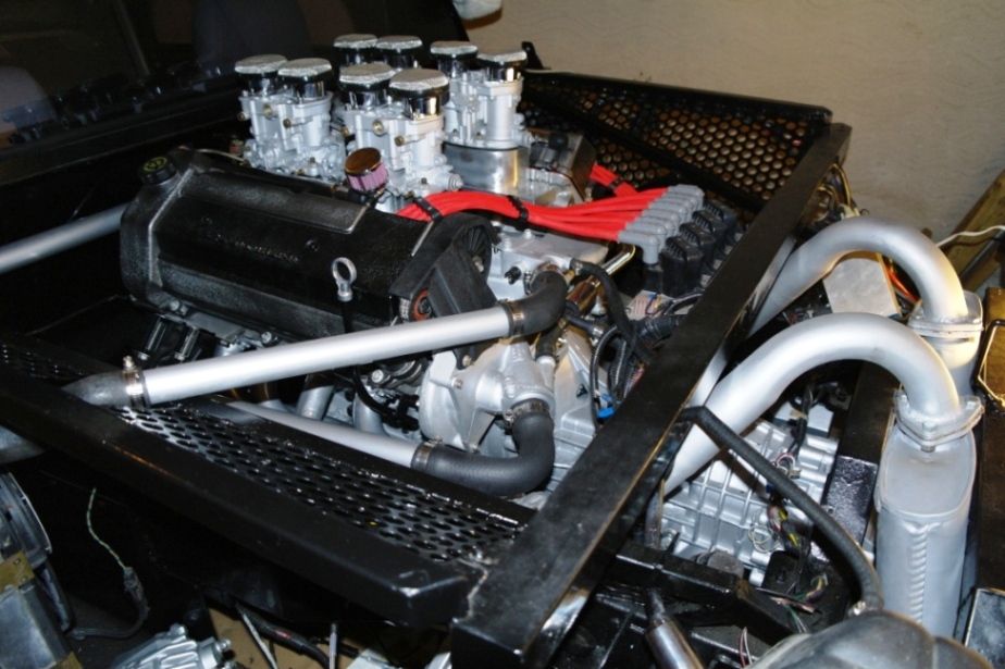

Oil cooler installed and going to build a vented cover to protect it the exposed fins

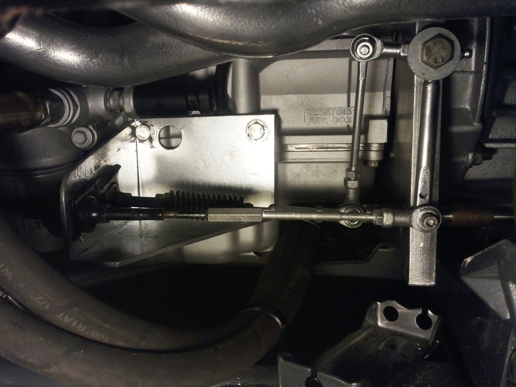

Also reassembled the shift linkage using the Fiero cables to the Porsche shifter rod
Next week I'll be working on the clutch and fuel system plumbing
I'm also brainstorming on how to beautiful the wiring and/or conceal more of it from view.
It's coming together slow and steady
bubbajoexxx MAR 19, 05:38 PM
nice jod on the rerout and wires and vac lines keep it up you make me proud
by the way put the bushing back in the adapter plate I see it is pushed out
[This message has been edited by bubbajoexxx (edited 03-19-2011).]
Fiero2m8 MAR 20, 11:47 AM
Thanks Joe, your approval is valued.
Yes I noticed the sleeve when I posted the picture.
The shifter movement is stiff at the moment so I will need to check that out later too.
